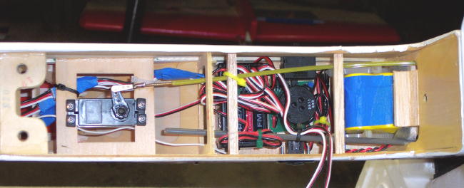

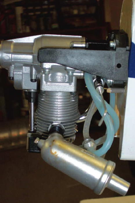

Just got through rippin' my OS 61 FX out of this plane and stuffin' my brand new Saito 91 into it!
One Side...
Old 07-27-2003 | 11:15 PM
  #307
rwh
Posts: 285
From: Lynnfield, MA
Default RE: U-Can-Do 3d 46?
...t'other side. Had to cut some off the engine mount to avoid interference with the carburetor.
Old 07-27-2003 | 11:16 PM
  #308
rwh
Posts: 285
From: Lynnfield, MA
..under belly. It turn out you get a straight shot to the glow plug because of the factory cut out in the bottom of the fuse.
Old 07-27-2003 | 11:17 PM
  #309
rwh
Posts: 285
From: Lynnfield, MA
.. and for those who think the fuse is spacious....
That big honkin' blue thing on the right is a 1500 maH battery pack (four sub-C cells).
The Saito .91 is a whoppin' 1/2 pound lighter than the OS .61 FX!
Yep, certified by my postal scale.
With the Saito and this big battery, I'm still 3/4 inch behind the recommended CG.

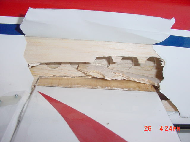

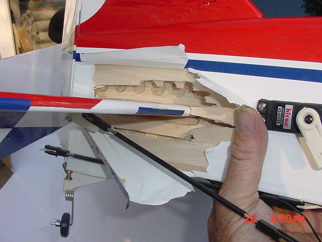

I flew my ucando for the first time Friday and within 20 seconds after takeoff while adjusting the trims at half throttle the plane suddenly went crazy.The President of our club was standing next to me and yelled something just broke. I tried to regain control and noticed the elevators seemed to be flapping around. My first thought was a connecting rod had come off. I fought the plane all the way to the ground and was able to slow it down until the last five feet where it stalled and broke in half on impact. After looking at the plane it was obvious what had happed. The elevators and connecting rods were still connected to the stab and servos but the side of the fuselage where the stab slides into had completely failed and split apart. The stab along with the elevators was rocking up and down within the fuselage.The stab is only supported by the sides of the fuse which is double 5/32 balsa and the first layer of balsa has a series of holes just above the stab to cut down on weight. The balsa was very brittle and spongy. I even had try stock glued under the stab on both sides of the fuse which held to the broken pieces.Ill be calling GP Monday. I would recommend tail wire supports.I took pictures and will try to post them.

Heres another pic

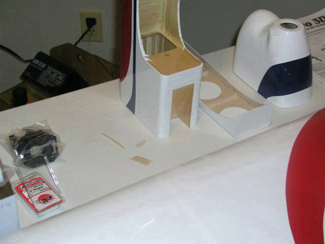

Well mine finally arrived....after reading through all of these post i was skeptical, but it seems to be in pretty good shape other than a few pieces of scrap wood falling out of the fuse...i can't see where they were attached, if they even were see pic...i will go through and check with a mirror real close.....i can see that there will be some "support" needed in areas, especially wing mount, and landing gear block.....i have the flip sitting on the building table in the other room...the ailerons and the rudder will fit on either one without many mods...hmmmmm....

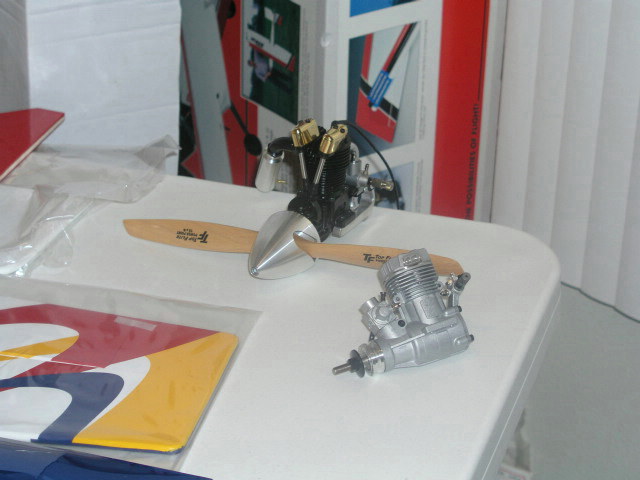

Now if I can just decide on which engine for this one...i have both the saito72 and the os50sx.....i will be using all digitals and ball bearing clevises with carbon fiber/titanium rods...so for that added weight i am leaning toward the 72....but then again the ease of the 50 is very appealing....
