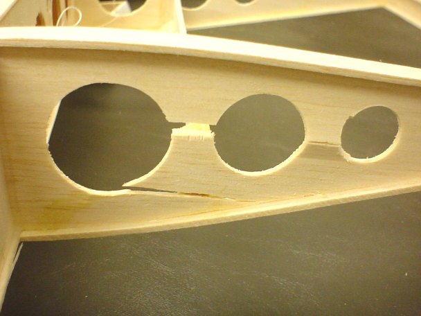

i havent taken any detail shots yet, i will take one of the damaged rib that i found lurking under the covering.....also there is a plywood plate glued on the bottom aft fuselage, looks like a tailwheel bracket mount, one of the things i was going to do. all in all though the construction looks real nice, however i am going to be going around it with thin CA on a few spots. which detail shots would you like to see?

Rib damage

more rib

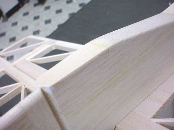

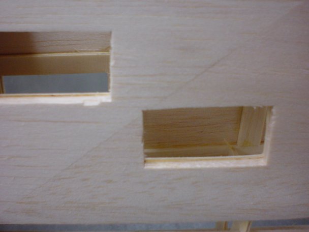

joint at the aft fuse sides, runs right through the servo cutouts, it does look plenty strong though

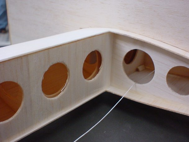

view inside the wing at the leading edge, the D-tube sheeting is one piece the entire span

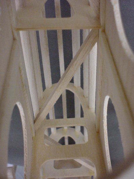

i hope nobody minds all the pictures.... inside the fuse

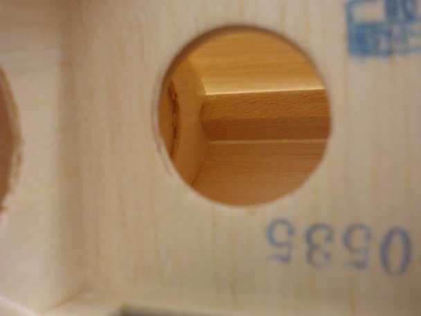

one more of the wing center section, it has a plywood doubler in front of the shear web at the center section, also the 5/16 dowell for the wing hold down is in one heck of a block of solid balsa.
want more pics just ask,
