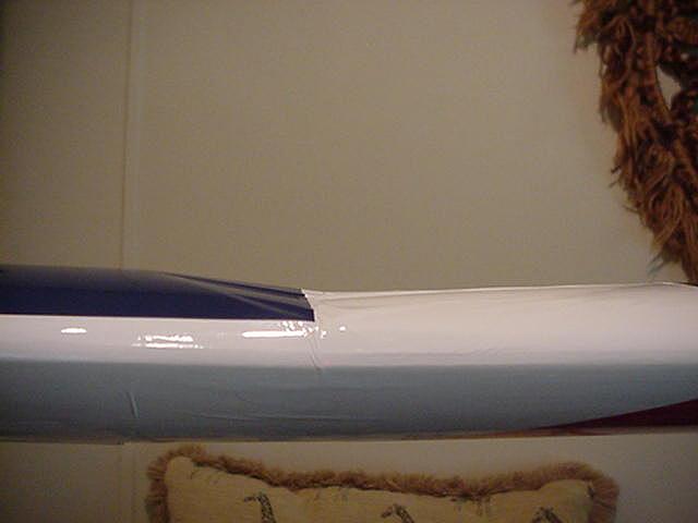

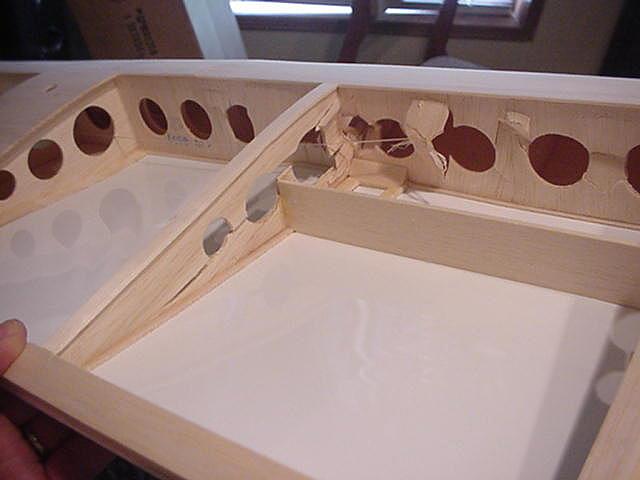

I was all excited when the box was delivered untill I got to the wing. Looks like someone smacked it against a poll and then packed it. No damage to the outside of box. What luck!
Rick
Old 06-21-2003 | 06:01 PM
  #132
Posts: 147
From: Newfield, NY
Default RE: U-Can-Do 3d 46?
Another pic
  #133
Posts: 250
From: Niceville, FL
Ouch, getting a new one shouldn't be too hard with GP though.
Old 06-21-2003 | 06:28 PM
  #134
Posts: 147
From: Newfield, NY
I bought it from a shop in Texas. He is going to get me a new one, But it has to be shipped to him first then shipped to me. Could take up to 3 weeks. Bummer! I took the covering off the top so I could check out the damage. Pretty nasty!
Rick

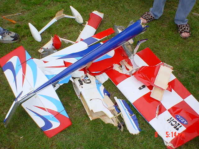

since i crash the big brother.
but i will like to know if it fly like the big brother any info on this will be appreciated thanks
