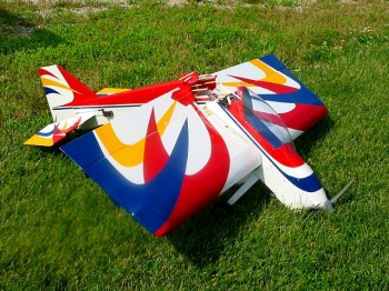

:stupid: :stupid: Check your aileron direction :stupid: :stupid:

Saito 100 makes awesome power on this plane. Too bad my flight only lasted about seven minutes. Didn't get to enjoy long enough. No matter how good you think you are, you can never be ready for something like this.
I tried to reverse them on the radio while keeping it in the air but soon gave up on that. Decided to try and land and that ended in a knife edge loop, on the runway. The wingtips sure are tough but unfortunately the fuse broke completely in half behind the canopy.
This is what I get for slapping one together in a day and a half.
