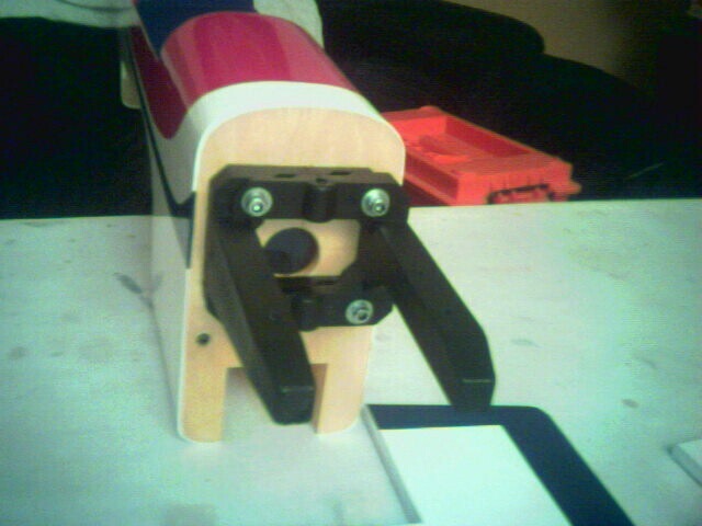

well ive just finished installing all my controll surfaces with pinned hinges and did a little iorning, really gonna turn out nice i think
the picks below are the inside of the firewall after i plugged the old mount holes(the dark spots on the inside of the firewall are the plugged mount holes) and drilled and re-blindnutted for the larger mount for my 100,turned out to be pretty easy using my homemade blindnut installer tool(piece of 8-32 allthread with a nut and large washer to pull the nuts into the wood).im also going to a 11oz h9 fuel tank which fits perfect and i would reccomend(no fabbing required).
will post a couple pics tomorrow.
I need to take a nap nowwwww Gluuuuue Gooooooooood
.the picks below are the inside of the firewall after i plugged the old mount holes(the dark spots on the inside of the firewall are the plugged mount holes) and drilled and re-blindnutted for the larger mount for my 100,turned out to be pretty easy using my homemade blindnut installer tool(piece of 8-32 allthread with a nut and large washer to pull the nuts into the wood).im also going to a 11oz h9 fuel tank which fits perfect and i would reccomend(no fabbing required).
