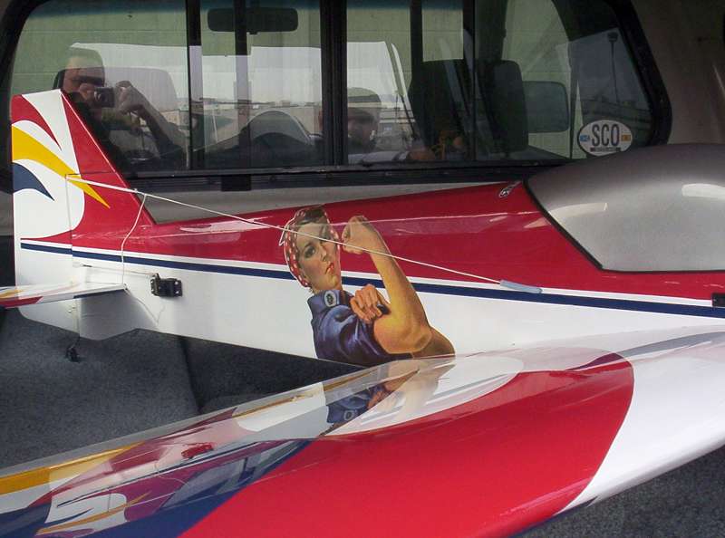

That was done by taking an old Smithsonian Magazine cover to a place that makes signs. Any place that makes those hanging vinyl signs should be able to do it. They take essentially a photocopy of it and you can tell them what back ground you would like. In this case the background was white and I cut it out around the image. THe image was originally done for one of my rockets. The down side is that it is a little pricey for the first one because unless you know someone they will hit you with a set up fee. The good thing is additional copies can be made cheaply. So the original was about $35.00, but all additional copies I get are $7.50 per.
I use it as sort of a trademark.
Plus it looks kind of like Nose Art from WWII bombers.
I went with some metallic flake insdie the canopy then ran a molding around the bottom to set it apart a bit. The I CA'd that to the fuse since I didnt have to worry about fogging the canopy.

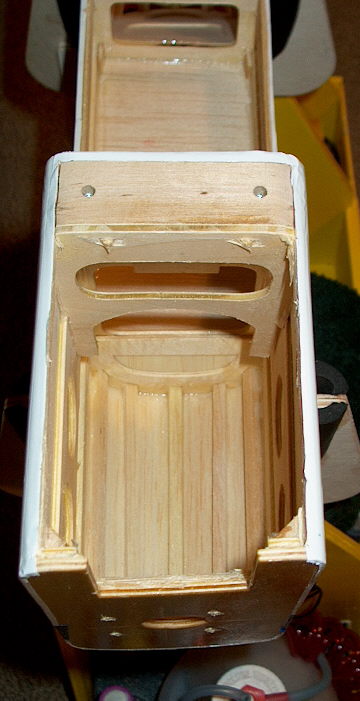

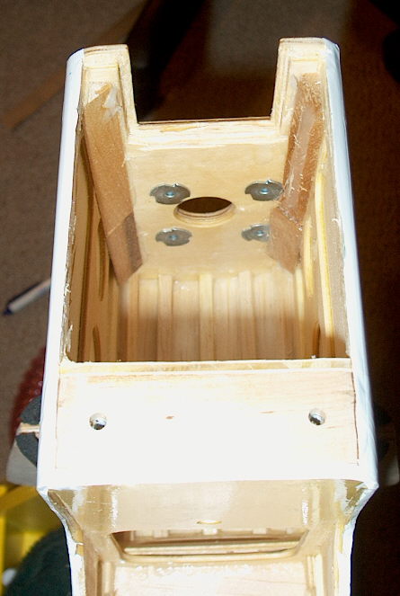

It takes a little doing to get it cut out but it allows really good access to the landing gear block to beef it up and the firewall. I use Gorilla glue to beef up the landing gear area and also to strengthen the firewall some.....Also you can change the T nuts to re-configure it for a different mount or even change the "ramp" configuration for a larger fuel tank.
[8D] The last picture shows it ready to be re-glued back in with epoxy...........

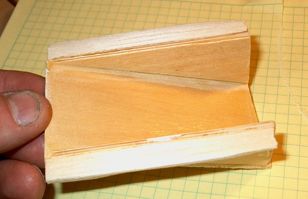

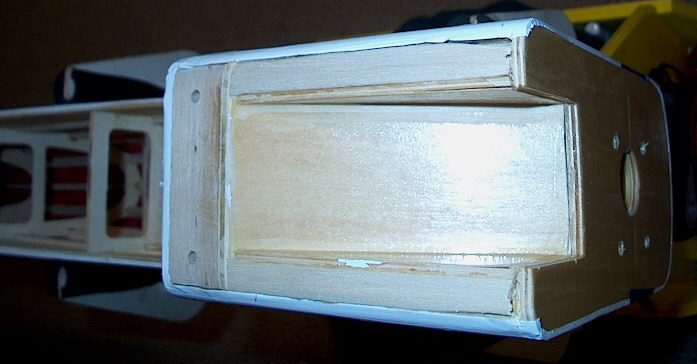

Here's an update on the build modifications....... Another one of the nice things about taking out the "ramp area" aft of the firewall is being able to fit the fuel tank easier. Mine had a misalignment in the bulkhead where the upper part of the tank goes into the compartment. Once I trimmed it out I was able to fit it in nicely...... You can see from the pictures that at this point if you wanted to modify the compartment for a larger tank it would be easier to do. Next I'll postion the throttle linkage and I'll be able to see the fuel tank and avoid it..........[8D] After that the "ramp section" is ready to glue back in and I'll get on with mounting the engine.............

Hey CeeGee it looks good!!.. Nice tight fit... Are you adding foam to the saddle
bottom and back of tank? What did you use to seal/cushion the front of the tank?
I just used silicon adhesive.. Works great..
With the ramp out it also makes getting the throttle linkage nice and stright if
any adjustments are needed.... All's looking good!! Keep it coming...
I'm not sure how many are/will be using pressurized fuel systems.. But I have
gotten into a habit of putting drain holes, Then C.A.'ing or painting it where I think
the low spot is at in case of a tank problem which will make it easier to spot...
