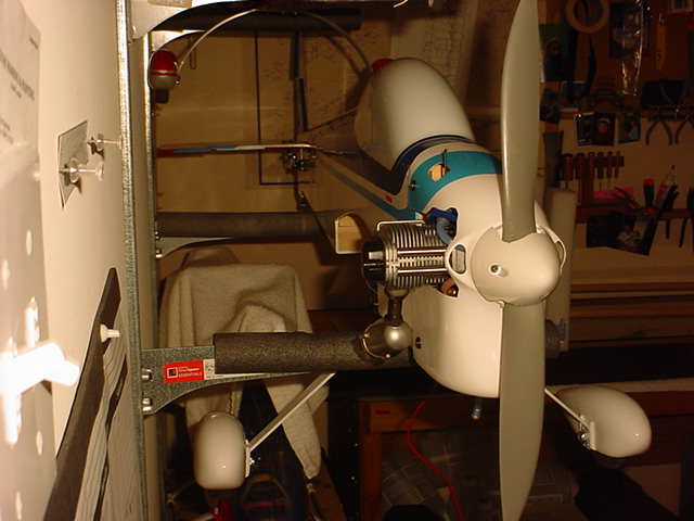

Well I finally got my U-Can-Do 3D in the air for all of 15 seconds. Almost as soon as I started my left bank out of the takeoff role she stalled on me. Lucky for me this plane will float forever, managed to get her back to the runway center line but quite a way past the end of the runway. Still a soft landing in very high grass and mud.
My Saito FA-100 was running perfectly on my bench. In the plane I started having problems -- my guess is the fuel tank position is just not suited. My biggest question is why? Everything I've read say this engine/plane combo is ideal. I have stood there after filling the fuel tank and watched the carburetor fill up with fuel with no priming action. This flooding continues even when I try to start the engine -- it just won't work.

On my initial setup with my UCD & Saito 100, I had to lean the idle mixture almost 1 1/4 turns to get it to idle without loading up. This was due to the high tank location. It ran pretty well like this for many flights.
Then I moved the tank to the CG and put a small 2 oz header tank next to the firewall. It ran ok but not as reliable depending on the fuel level remaining in the main tank. So I added a Perry pump and presto, I've got 16 oz capacity with no problems even in the wildest attitudes and tumbles.
I was running a Saito 180 like this also, with 16 oz main tank at CG and a 4 oz header at the firewall, without pump, and that 180 just ran and ran, as long as the header tank was full, no problem with any attitude!

outssider pegged it; and of his three reccomendations, mounting the engine sideways is the least painful, in terms of additional cost/effort required.
I have a YS, and it doesn't care where the fuel tank is. But I was concerned about potential cooling problems here in the sub-tropics, and I saw the two guys at my field that had this model before me struggling with attaching/removing the glow igniter on that inverted head.
The older I get, the more I"m really into hassle-free things. So I mounted my YS 91 sideways. It looks okay, and the "square" mounting holes on the UCD make placement a no-brainer; just rotate the engine mount ninety degrees.

Do yourself a favor and get either a Cline or Perry. I got a Cline and have had zero problems. Idles so low and reliable that you can almost count the rpm's. No burbles in a hover. It's great! It's 60 dollars (which seems to be a rip off), but money well spent when you get the results.
Steve ... all you have to do is put on a remote glow to solve the glow plug position problem ... that way you don't have a big honkin' cylinder sticking out the side of the cowl. The one I bought was around 7 dollars and mounts on a little angle bracket. A small hole in the cowl provides access.

Yeah, I have used remote glow fittings a lot, on bigger cowled engines and my helos.
I was more concerned about the engine getting hot in the tight confines of the UCD cowl. Now that summer is here with a vengeance, we'll see how the guys with inverted mounts fare.

I have been using the hanger-9 remote glow plug adapters. I don't have a part number for you, but they sure are slick. A spring loaded clip keeps the connector on the plug. On the external portion of the plug, it is a headphone jack, they give you an adapter to use with your glow ignitor. Very good stuff. I like the fact that you don't have a "glow plug" sticking out of your cowl.

I installed mine on a Saito 100, but I imagine this would work on any 4-stroke. I just pulled one of the bolts out of the valve cover and ran it through the ground lead, and then put it back into the valve cover. No problems.

No problem with engine heating yet. I've got a nice size hole in the front of the cowl and there seems to be plenty of opening at the back of the cowl for air flow. I don't think it'll be a problem.

If that "cylinder sticking out of the side" doesn't offend you, a side-mounted engine kills several birds with one rock; especially if it is a non-pressurized or non-pumped engine.
