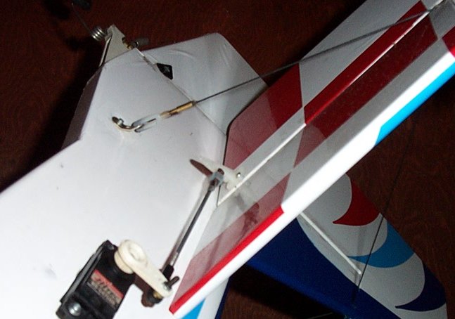

Here ya go:
Some notes:

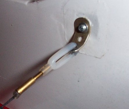

To avoid interfering with the rud/elev push rods, I mounted the wire to the side of the fuse. To do this I simple cut a small square hole where the trailing edge of the whole is butted up against a former. I then epoxied a square hardwood stick (about 3/8" x 1 1/4 " I guess) up against the former and then covered with Monokote. this became the "hardpoint" for the fly wires. Once I threaded the kevlar through the holes in the stabs, I then rough cut it to size. I used some 2/56 solder rods (the things you solder on the end of rods so you now have threads on both ends) and simply dripped some CA in there after tucking the thread in the end. I used smali pieces of aluminum that I had laying around from some Nelson arms to and screwed these into the hardpoint in the fuse and bent them at the appropriate angle to accespt the 2/56 plastick clevis. When everthing is done and somewhat tight, just wick some CA into the holes in the stabs where the kevlar is threaded though.
Hope this helps (and hope I can shink the photo)
.........Mark

Mark. great pics ! Could you post a pic of the spot where you threaded the kevlar string through ? What's the diameter of the kevlar string you're using ? This method sure is lighter than using cables or rods. Thx........
Old 06-21-2003 | 01:26 AM
Posts: 1,185
From: Drums, PA
Default Modification to be done on a UCD 3D 60-90

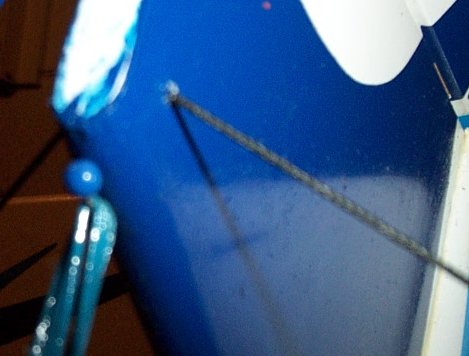

Not much to look at:
I strung the thread through the trailing edge of the horizontal stab but close to the leading edge of the vertical stab. This is done to minimize the angles that are caused by running the wire through the trailing edge of the vertical stab. I'm not concerned with the location of the thread in the vert. stab as this has been pretty robust on the planes. It's the horiz stab that has people concerned. The photo in the thread below shows the angles when complete.
Size is .025 O.D.. 180 lb stensile strength!! The stuff I have is from EMS Jomar Products (emsjomar.com Look under "reliability enhancments")
It's called "Aramid Rigging Cable":
Quote from site:
..... ARAMID (Kevlar 29) RIGGING CABLE
Totally eliminates problems caused by metal flying wires, tail bracing, pull-pull cable systems and more! Replace that nasty wire with this non-conductive DuPont KEVLAR 29 material. 180 pound strength. Measures .025 OD with circular cross section. Dark Green in color - can be painted. No “fuzzies” like other brands, 20 feet. $10.00
Hope this helps.........Mark

Vertical stab attachment point:

Horizontal stab attachment point:
