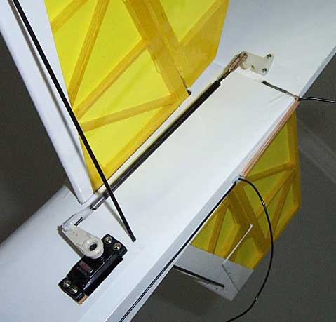

Just put some carbon pushrods on my flip. There quite old and have been used alot.
Does carbon deteriate or get a bit fragile after a while. Dont whant them to shatter!

Your push rod looks a bit messy, surely you can do better than that!
I don't know how long carbon push rods last, but everything will wear out. I have only recently started using them myself.
Still I would replace mine if they looked like that...

damn that really is ugly.... i'd be ashamed to have that on a model!
These are what you want. Phone Pete Tindal and ask for a carbon pushrod set.
These are what's on my funtana....
The one you have certianly aint up to the job for a flip.

dont listen to the criticism too much..
sure they look a bit ragged but your biggest problem
is not how they look or the amount of cotton thread you have used....(seems a lot !)
Your problem here is that you have wasted your time with CF tube...
there is so much wire extending that the cf tube is almost a waste of time...
look at welsh 3Ds rods... there is no thinnner part than the tube... solid...
if you want to use 2mm wire out the end this is okay but it needs to be literally just as much as you need and for as little amount as possible to be threaded and exposed....
Make the carbon tube the full length you need, and have less than 6mm of the 2mm rod showing before the clevice.... even better substitute the 2mm rod and clevis for 3mm stud and 3mm clevis instead....
Otherwise you pay the money and go Welsh 3D's route or similar !

I know the rods are crappy. But I’m a skint teenager with a wallet the size of a cox engine (I like that saying! But it is the truth). I can’t afford posh push rods! The rods were cut from my old cougar (second hand, kit version), drilled, then rodded and bound with miles of cotton and thin cyno (most went on my hands, locked solid, burning like hell LOL!)
The reason for all this cotton is ‘cos I didn’t know how much is needed. This is my first time using CF, apart form some tows, I will try and buy the Pete tindal rods soon.
Shame I can’t scrounge of my parents , still, I could always get a Saturday job…………………….well………………….na I want to fly on Saturdays
Do you recon I should put the old rods back, forget the cosmetics, I need to know about strength!

Try this, Buy a length of carbon rod (5.5mm), the inner diameter is approx m3.
Slide a m3 wire pull/ pull adapter in it and cyano that in place.
Cheap as chips.
