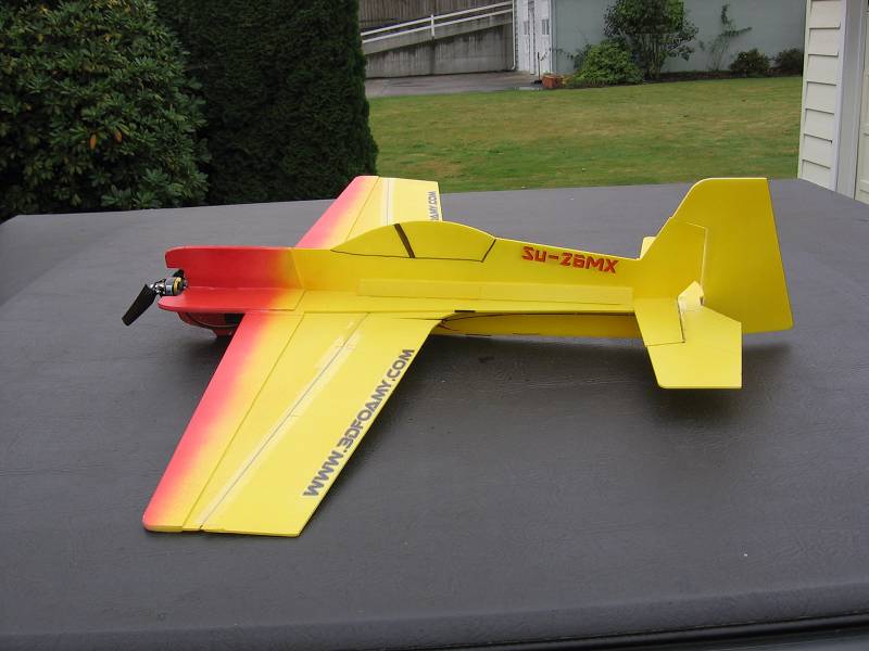

I am assembling this plane and there are (4) 13x0.75 strips that I am not sure where they go. I am thinking these are used to strengthen the fuse. Any help?

Hi, they should be like 4" long or so? They go into the nose for stregth.

I looked at the photos on the CD and determined they attach between the fuse and the side plate from about the back of the wing to the horizontal fin. They mount at 45 deg and really stiffen the fuse.
I also found how the triangle braces can be used to strengthen the motor mount.
By the way, I like the construction of the airplane. At first it is a little confusing, but once you look at the photos, it fits together well in a very strong structure.
Next is to install the motor and radio gear.

Hey Cool.. if you have my min sukhoi, 4 4" pieces go into the nose laminations... but you can also add some rods to the back if you think you need to.

The 13" pieces are shown in this photo from your CD. I installed in a similar manner. There were triangular pieces to support the motor mount. I don't have a photo of these.

Hi, the carbon your seeing there is the pushrod for the tail surface.

BTW, in my previous posts, I am referencing the 13x0.75 foam strip that braces the vertical and horizontal fuse. I believe you were referencing the carbon strips in the nose and elevator. I have it all together now. Just need to resolve a receiver problem and I am ready to go.
