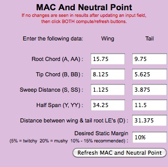

Since the CG location is really a function of how big the horizontal tail is, how far back it is, how big the wing is, and what the wing chord is, why not use an online application that takes those numbers and spits out where the CG should be? We place the CG to control the pitch stability. The tail and those other things are what controls that stability.
http://www.geistware.com/rcmodeling/cg_super_calc.htm is an online application that does the figuring for you. You just need a yardstick and time to make 9 measurements.

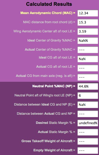

Thanks for the link...
Here are my results: Would you confirm my interpretation?
Mean Aerodynamic Chord (MAC) = 12.34
MAC distance from root chord (d) = 15.3
Wing Aerodynamic Center aft of root LE = 3.59
Ideal Center of Gravity %MAC = NaN%
Actual Center of Gravity %MAC = no value
Ideal CG aft of root LE = NaN
Neutral Point %MAC (NP) = 44.6%
Neutral Point aft of Wing's root LE (NP) = 6
Distance between Ideal CG and NP (E) = NaN
Would I set the CG at 44.6% of 12.34 inches?

Go back and rerun it without the "%" sign in the desired static margin.  That should fill in the NaN nonsense with numbers you can use.  The final location for your balance point will be the number it gives you for the distance back from the LE at the root.  that's where it's easiest to measure.
The 44.6% point is the Neutral Point.  It's the furthest back you can put the balance point and still fly without the model trying to flip around and fly backwards.  Contrary to what it says on the notes about setting the value for the static margin 3D models are often set up with SM's between +5 and -2'ish to achieve the ability they have to flip around.  But it increases the work load on the pilot to keep the model under control.
You may eventually end up at that point but for now your 10% value for stability margin is a good beginning.  But depending on how you like to fly it won't be your final point.  I would suggest running the numbers again for an SM of 3 as a guide for the rearward limit so you know what sort of tolerance you have for later and can work your way back in small steps until you're totally happy with how the model flies and it's not too much workload to keep it under total control.
