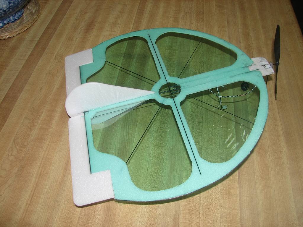

keep it simple-
- learn to balance it then go to next design
Here is the GOOD part
Once you figure out why this goofy design works -you will understand the basics of stability
