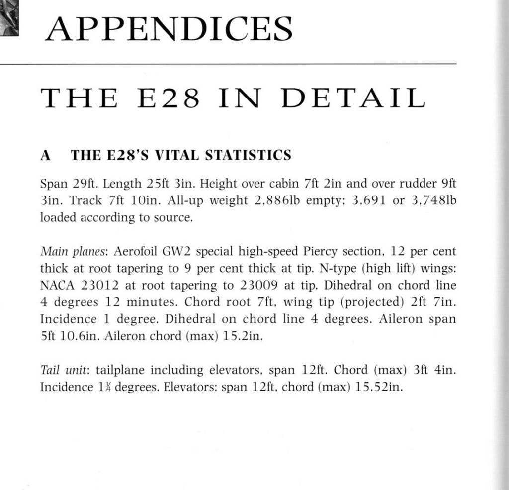

Thanks for your reply. I am taking the information from the book entitled: JET PIONEERS - GLOSTER AND THE BIRTH OF THE JET AGE (Photos enclosed)
I totally agree with what you stated so if I should stick to 0-0 it should not be a problem as any fine flight adjustments will be taken care of by the elevator trim. Hopefully this will be the ideal setting.
Meanwhile I am enclosing extracts from the stated book and a basic outline of the cad drawing.
Reuben
Reuben
0-0 is how I'd do it. And... if there is minor elevator trim, it isn't a big deal... and some of that can be countered by trimming the ailerons up or down slightly.
I've upgraded radios recently and the new has two additional trim pots, one does just that, it trims the ailerons up/down slightly whereas the other trims dual elevators for loop tracking.

Mike if I am getting this correct the engine thrust line is 0-0 as this is a turbined plane. Jim, the degrees quoted above are approximately the same as per original. The wing incidence angle is being taken as a parallel line to the centre line of the plane and is angled upwards from the trailing edge of the airfoil. I do not know if you can see it in the drawing.
Again thanks to all.

Bob you are very correct the original drawing on the book had a positive stab incidence as you indicated but I changed it to 0-0 for my drawing. Moreover, the stab airfoil is just a trace which will be replaced by a cadded version. This also applies to the wing airfoil.
Just an afterthought. I was thinking of settling for a 1 degree washout. Do you think that this will be a reasonable washouot airfoil tip angle or would one prefer a higher degree of washout gradient?

Not having ever seen the planform view, and relying on the drawing of the plane, it looks like the wing is somewhat like an elliptical planform. Elliptical wings stall equally from root to tip. They don't have a tendency to stall from the tip. Your 1 degree of washout should insure that you definitely don't have washin, but very probably isn't needed.
One reason they went to all the trouble to build elliptical was what they get from them without extra effort. Quite a British attitude, by the way.
