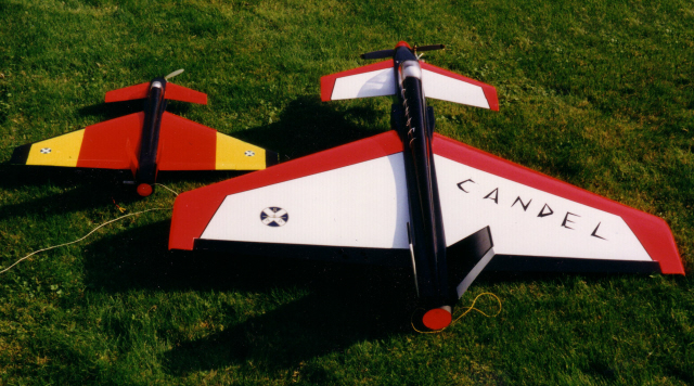

I have built s series of canard delta models (called Candel, as I'm not good with original names). They all flew, but improved with development.
They all had a tractor engine, small foreplane, delta wing.
The first had elevators on the flat plate foreplane, set at +2 to 3 degrees.
The second had BIG elevators, later an all moving foreplane.
The third had elevators on the foreplane and elevons on the wing
The fourth had a fixed foreplane (Clark Y thinned to 9%) and was controlled purely by elevons. It also had rudders. The foreplane was part of a front hatch for acess to tank/radio, and its flat bottom was rigged at Zero, like the symmetrical wing.
You don't need to be "careful" with the foreplane section/size. The foreplane will ALWAYS stall before the wing, because it is always more heavily loaded. Unless of courseyou go crazy with the foreplane section, and fit a very undercambered foreplane like a NACA 6409 or something.

I too found that I had to increase the V-stab area beyond what looked normal.
You can see from my photos added to my post abovethat my first model had one fin, but subsequent models had two. A double sized fin would have looked daft, I felt,

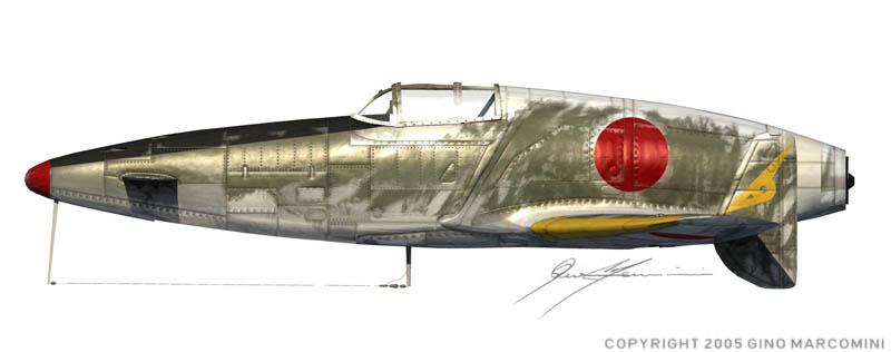

From the drawing I found at http://notasperdidasenlaweb.blogspot...1-shinden.html it looks like the final CG location will be pretty near or only slightly back from the leading edge of the rear plane wing root airfoil. This being based on the idea that the main gear would be located on a line swept back from the vertical through the CG at around a 15 degree angle
Your selection of a 24016 or 24011 would likely be controlled by the size of the model. All else being equal the thinner airfoil would do better on a smaller size model such as a smaller to medium size electric or glow powered model. Once you get up to a 5 foot span or larger the Reynolds numbers become high enough that the thicker 16% section would do well.
Alasdair, the 240xx series are a lower or neutral pitching moment style and should be fine for this sort of use. But I agree that making the fore plane with a postive camber airfoil would be a wise option. Tim something like a NACA 2410 would not be a bad option for the foreplane. Or on a smaller model just use 1/8 to 1/4 sheet surface depending on the model size and sand in a reasonable approximation of a Clark Y.

just BTW, I'm thinking of changing from symmetrical to NACA 130xx for my next Candel development

tdstaf is building a Shinden. See post #16 photos
At 54.5" wingspan I'd estimate his foreplanechord to taperfrom 4.6 to 2.4 inches. At 30 mph its Renolds number will be 40k tip, 80k root.
Suggest a section, and a rigging angle, and tell us what its maximum lift coefftmight be.
Reality check!!
