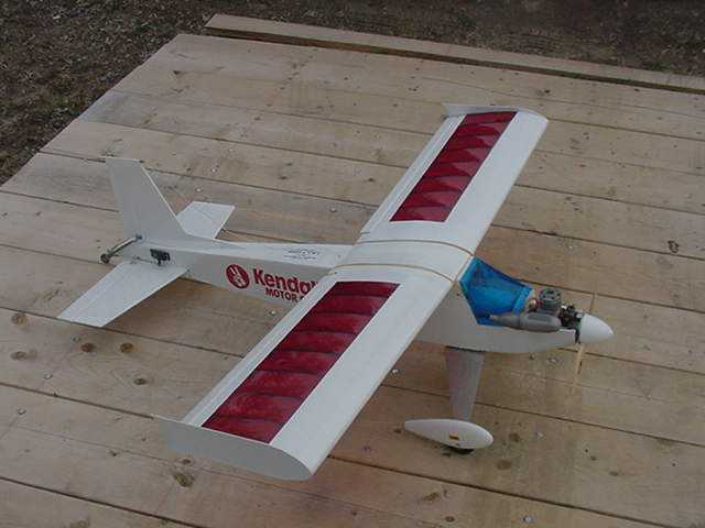

On a model, they're 99% aesthetic, but imagine how unattractive this SST.40 was as designed, with trike gear.
