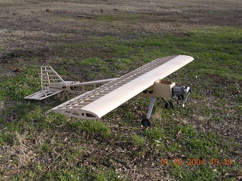

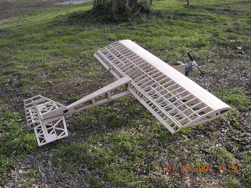

Hope this helps. By the way, here are some pictures of my latest scratch built - a big ugly stick. Wing is 78" Chord is 22" Airfoil = semi-symmetrical Selig 8036, Fuselage = 68 1/2". I have a Homelite 25cc weedeater engine on it now, but am trying to buy a RCS 44 twin cylinder engine for it. As you can see - still have some work left, but hopefully will fly in 3-4 weeks????

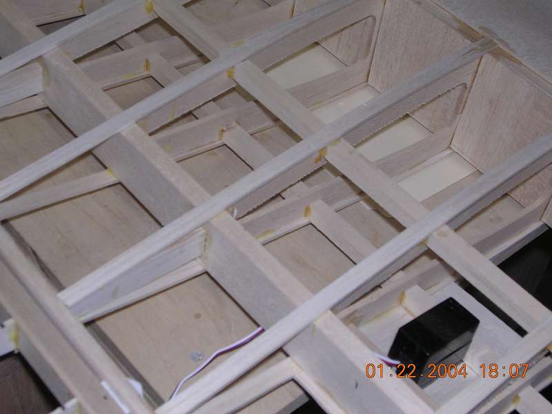

I can't tell from the photos, but it looks like you're using four main spars and then two more towards the aft of the wing. Is that correct? If so, what was your reason for the four main spars?

Scratcher - The Das Ugly Stik is a classic design by Phil Kraft. Everyone has built one or eleven. Basically a plane that looks pretty much like the one in this thread. Shoulder wing, conventional layout and no cowl. A basic requirement is to have Maltese Crosses on the wings. Just a really good, dependable sport plane.
Do a web search for "Das Ugly Stik." Also, check out google images with the same search.

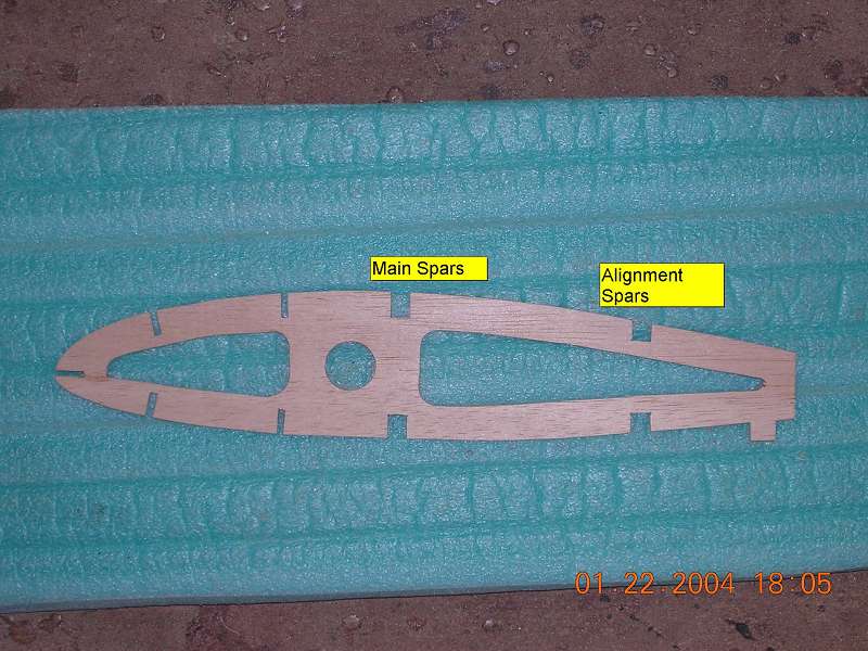

CafeenMan - My wing really has two load carrying spars - the main one where the sheeting ends - at about 35% of the chord, and then one further back - I'll take some close up pictures of the wing and rib tonite and post them tomorrow.

CafeenMan - First of all - let me apologize - I mis-interpreted your previous question about the spars - so let me start over and try this again. The first image is a picture of the rib I started with. The main spar was built using an upper 3/8 square hardwood stick, and a lower 3/8 hardwood stick, and then they were joined with a 3/32 web on the front and back side, in effect making a box beam structure.
See picture #2. Then, I used two more 3/8 hardwood sticks for alignment spars - I use these mainly to hold the ribs in place and align them properly - and they also add strength without too much weight. OK - now - if you look at picture #3 you will see a thick 1/4" spar and it looks like it is the fourth rib - well - I have to admit that I changed my design late in the game. I orginally was going to use large "barn door" style ailerons on this wing - so - this 1/4" thick piece was going to be my original trailing edge. Instead, I decided I wanted to add flaps, so I went with the design you see now. This is the first "large" wing I ever built, so I was concerned about it's structural integrety. Perhaps I overbuilt it. Every time I build a wing, I learn something, and I think the design process continually evolves. In other words, I don't think I really ever build a wing the same way twice - I like to see how how other people build their wings, and learn from folks like yourself - which is what makes this a fun hobby.
Hope this does a better job of answering your question. I put the wingtips on this weekend and got the bottom of the wing covered. It was absolutely beautiful weather yesterday, could have flown it if it was ready. Will post some more pictures as it gets closer to flying condition.

ramrod25 - Again, the construction looks really good. I do think the wing is over-built, but I suppose that would depend a lot on what you plan to do with this plane. Two 3/8" square basswood spars with front and back webs is sure not going to break in the air.
You are correct about designers evolving. My first designs were along the lines of acceptable building practices when I first came into the hobby. Those designs were way over-built. A .40 size model does not need 1/16" plywood doublers from the nose to the rear of the wing saddle. I would use 1/64" doublers on 1/8" sides and no doublers on 3/16" sides.
Anyway, I've found that my designs are getting lighter and stronger due to better techniques as well as being a better craftsman. New guys are always asking about what glue to use. My opinion is that the glue doesn't matter - the fit of the joint is much more important. Although I'm not going to test this theory, I believe Elmer's school glue is strong enough for any balsa to balsa joint and as flexible as it is, it would probably hold up very well.
BTW - that servo looks completely lost inside your wing.
What kind of servo are you using and how big is the surface that it's moving? I'm sure it's fine, but I'm just curious.

CafeenMan - The servo is a GWS SOT3 (I think that's right - going from memory) - it's a standard size servo - puts out 111 oz-in at 6 volts - my aileron is about 2 1/2" x 18" - so roughly 45 sq in. I just used standard Tower Hobby 44 oz-in servos for the flaps (one per flap). Used the same GWS servos for the rudder and the elevator.
