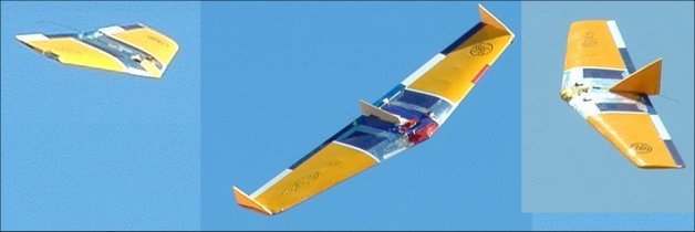

Attached:
A sloper with ZERO, 2 and 3 vertical surfaces. As long as the speed is kept up, the version with NO vertical flies well.
Let the speed drop, and it can fly sideways and backwards..
The Kadet vertical was hit by another plane.. Kept the speed up, and landed straight ahead.

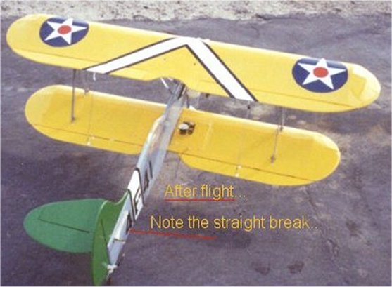

Who said it was a torque being passed across the hinge? BTW you CAN you can twist a hinge 90 deg to the direction it is meant to move... you will transfer a LOT of torque via the hinge.
Never said a plane DESIGNED to fly with no rudder wouldn't fly without it. Plenty of 2-channel aileron-elevator slope gliders do it all the time. But you rip the empanage off a conventional aircraft in flight (OFF, not held by the covering as with the Kadet pictured) and I defy you to keep it in the air.
BTW.. if that Kadet's fin wasn't held in line with the airflow by the covering on the right side... it wouldn't have had a snowball's chance in hell of getting down intact. (and I note the rudder pushrod is still attached...)

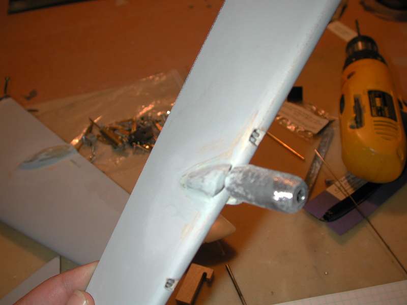

If the surface (not limited to rudders) can bind against what is supporting it, then what happens to it can affect the plane.
Every one that's come loose on the planes I fly has faired itself. It's a rare event in any place.
A sufficiently heavy surface.. rudder, elevator, aileron, -can- go into flutter and affect the rest of the plane, but mostly it will fair and exert no influence on the plane.
Surface flutter is frequently created by an overly heavy surface, restrained or not.
Witness some early pre-WWI biplanes with the ailerons dangling when the plane is sitting still on the ground.
As speed increases during the takeoff run, the aileron will rise, attempting to fair itself. The control cable, which pulls the surface down only, restrains the upward motion at some designed angle.. then the surface acts as an aileron is expected to.
Flying contact combat on the slope, losing the control horn on an aileron merely inactivates that surface. As long as the aileron on the other side was still operational the combat can continue.
Losing an elevator horn, or having the pushrod snap, is not a benign situation though. It's as if half the horizontal vanishes, and the plane seeks a new trim position, which is generally some feet underground.
This one lost the entire right side horizontal in flight.. the pushrod was on the left half. The plane was landed without incident

The best example I had was a mid-air taking off a section of wing, and snapping that wing's aileron clevice pin. Anything faster than right on stall speed, the aileron fluttered and the plane was very unstable. At stall speed it was easilly controlled. ( I still have the airplane... havn't gotten around to fixing it either.)
I had a coroplast airplane develop aileron flutter (clevice stayed attached) that split the hinge for 6 inches before I got the plane slowed down enough to stop the flutter.
I had another coroplast plane flutter the vertical stab (no rudder) right off the plane. (didn't keep that one in the air..) I heard and saw the signs of flutter and before I could move the throttle... the tail had parted company with the fuselage. (ripped part of the fuselage and some of the horizontal stab's skin off with it, so it wasn't a bad glue joint... ALL of the glue held.)

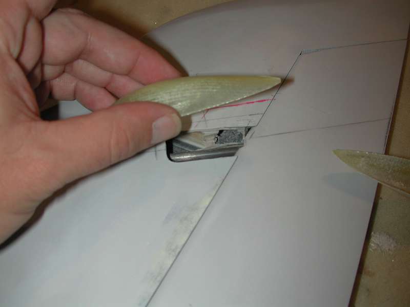

You have never heard of balanced surfaces to prevent flutter? If the surfaces are not balanced, and 'unbinded" rudder and fin can transfer energy back and forth,. That is what causes fludder in the first place.

I've had any number of planes flutter. I had an ANABAT slope combat which I induce aileron flutter at will. And stop it.
I DO fly these things.
