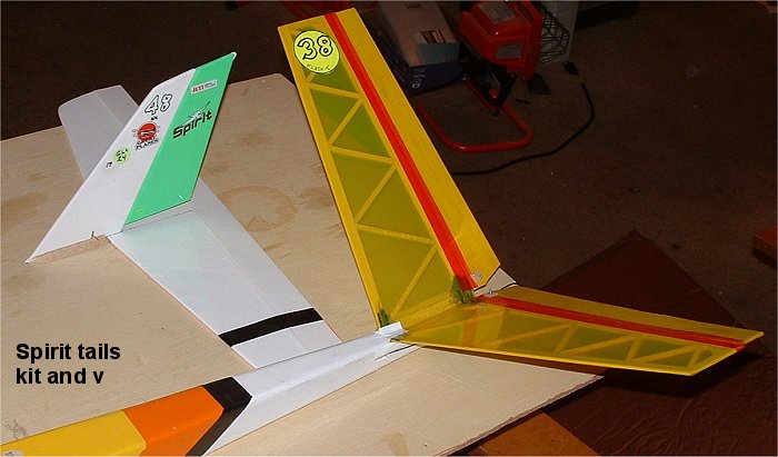

I had a Coroplast mdel built by plans from the SPAD website. This particular model has a V tail.
The method for getting the V angle is by heaing and deforming some PVC to make the angle brace. As the PVC cooled... it sprung back toward 90 deg. I ended up with appx 95 deg angle V.
Up elevator at full throttle slowed me down like I'd killed the engine. Down elevator was not as bad, but it was noticeable.
I cut the bad V tail off... and put on a conventional tail. The same elevator deflection angle resulted in almost no noticable loss of speed. (of course a high climb angle always slows you down... but it was a HUGE performance change.)

Well, the sweep between the upper surfaces of the Vee tail according to the plan is about 112 degrees. Presume that is within the parameters already noted.

There is some disagreement as to the area required. They range from:
a) using the same size as the existing horizontal stab area
b) using the projected stab area of the V the same as original
c) using the same total area as the combined area of the original tail
d) using the square root of the sum of the squares of areas of the vertical and horizontal
Gliders often use very acute angles (90-110 degrees), because they need a lot of rudder authority.
Pylon racers often use (110-120), I’ll reserve comment as to why.
Seems to me that you would design a V tail so that whem you looked down on it, it would look the same as a horizontal stab and elevator, and when you look at it from the side, it looks like a regular vertical rudder, more or less.
