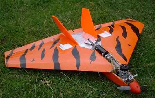

the second is DD, not Diamond Dust, but named after the initinals of the guy i built if for. his quest was same as yours.
i had a plan for a Eurofighter type thing, i nicked the wing sections and shape, and built the rest around it.
its a bit thick in the centre, but i built a fuz to hide the rest of the gear, a fuz cant be as much drag as a wing tapering to be thick enough at the centre for the gear ( a 4 part delta wing is the ideal, thin, last bit taper to thick for gear ) the wing had 3 degrees of washout to stop tip stalling, i made the LE real sharp till the last 3" then rounded it, that worked great.
the first fins where too small and it would have a bad stall on landing, the new fins lowered the stall speed to walking pace with the engine off. the pipe and engine where lowered so to be faired inot the wing ( not shown in pic )
the LE it tapered so the elevator is in the centre at the back, where is should be, and ailerons at the tips further forward, where they should be. i've seen Zagi types sip on full up, coz the elevator is at the tips so to speak, this plane had NO tip stall even on viloent turns and climbs.
this plane was 20-30mph quicker than anything else on same engine pipe combos
my conclusions are, lightweight, but work the wing loading out first, and go from there. flat bottom for lift at lowest possible AoA to reduce drag. fair everything, use THICK torque rods for elevons to a fuz to give a thinner wing section ( no servos in there ) lay everything as flat as you can. imagine rear inducton rear exhaust on a Outlaw..... you'd never see the pipe, it would be in rib bay 1.

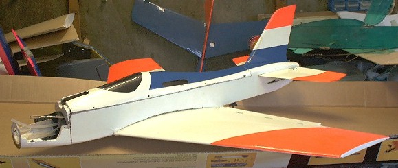

hmmm, i wonder if you made a bigger diamond dust, like a 90 whiplash or something, and put a turbine on it. that would be fast, no? but then your talking turbines and not prop planes. but, if you are trying to build the fastest r/c plane ever, then i think this would be the way to go.

i woke up this morning and thought "nick the wing from a US Raptor" think it was because of that 45 degree tips thing, + my own TE sweep theorys.
you need this plane to be able to turn without loosing speed, its fast so you need to come back. Deltas have alot of drag in turns so i hear. fly it smmmmoooooooooooooooothhhhhhhhh.
our quickies do big U shape runs, one guy is always faster, main reason is he dosnt yank the plane over at the top and loose speed, he rolls slow, then pulls back so hes facing down same times as everyone else is just yanking over the top, and has the speed advantage right from the top. i've done this with my Dust on a much less fast set up, and i keep up by the time we're over the patch.
AKMacs plane is spot on, anyless span than that, and you'll torque roll too bad.

The Formula 1 40 Racers have pretty good designs for high speed. If you like high speed action, catch these races! anyway, one of these racers with a larger engine and the correct prop would be pretty hard to beat and the design work is pretty much all done. Maybe optimize the foils a bit because you wouldn't be concerned with minimum thickness rules for the races, just reasonable structural integrity. Jet aerodynamics are cool looking but most of it only applies at speeds much higher that those our prop powered models run at.
Nice looking design AKMAC, I'd love to see that baby go!!!
Best Regards, Jeff.......
Interesting discussion. I think that the fastest RC prop Planes are the unlimited class giant scale racers. I saw them run at Jean Nev. a couple of years ago. Rich Verano was flying a Lancair with a long skinny wing. I've heard that he has recently been clocked at around 235 mph.
One thing I haven't seen is comments regarding prop pitch speed required to get to these speeds. The cleanest airplane can't outrun it's pitch speed unless it's in a dive. How much horsepower will be required to drive the prop that will get into these 200+ speeds?

while our fastest club planes here run 8x9's, i hear that the Plyon guys dont go over 7" in pitch, you get more from RPM than pitch after that. fine if your engine will rev higher than the 18000 max most fast sport engines have.
one reason the big scale planes go faster, there bigger, real planes go even faster than that. most small planes will do 120 without thinking, and they are hardly aerodynamic.
thats just the way physics works. if you wanna get real space age, i also saw ages ago a nose cone with a small rod with a blunt face, i think the idea was to create a shockwave the rest of the plane would fly in, like driving & following a big lorry, it would have less drag. not sure if this worked, another was some sort of plasma fire on the point that did the same thing.
i think those racers are the way to go, what other type of pilot would de-tune a plane from 200+ to 190mph just to make it better in the turns!!!!
