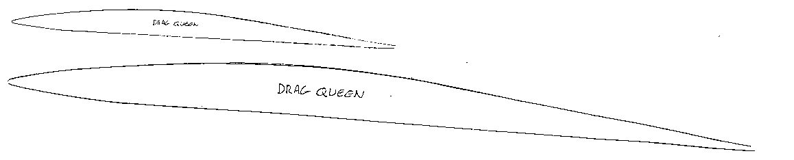

flat bottom laminar for low AoA ( dragqueen had that ) i could scan the templates i found the other day.
on smooth surfaces... i covered the wing in 1/16" balsa, stronger than Obdeci and you can sand it hiding any contors in the foam wing. foam was blue for strenght, so little of it it didnt matter about the weight.
umm what else, engine, rear induction rear exhaust, hide that in the fuz or canopy.... torque rods to move surfaces, no showing controls, hide fuel up point behind hatch.. i know i'll think of more
scan of the templates, the size of the pic is a full lenght of A4, thats how small the wing was.
