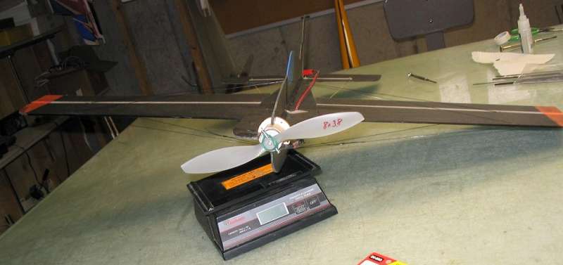

It’s been said that, “One test is worth a thousand expert opinionsâ€. A number of years ago, for a school science project, a young friend and myself tuffed the wing of my Cherokee with yarn. We flew to a safe altitude and I put the airplane through a series of planned maneuvers while he videotaped the tuffs through the window. The pattern of stall development was quite obvious. The tuffs would begin to lift and flutter as the flow begun to separate and as the stall deepened, some of them would actually reverse.
A coordinated stall straight ahead would result in a symmetrical pattern like the first sketch below, progressing from the root outward. When the airplane pitched downward (by definition a complete stall) the stalled area covered less than three quarters of the wing and the tips were always in an unstalled condition. A stall from coordinated turning flight (even steep turns) was similarly symmetrical with no tendency to progress to the tips.
When rudder was applied at the instant of stall to produce an incipient spin. The stalled area quickly increased on the side toward which the rudder was deflected (as shown on the second sketch) and the wing abruptly dropped, characteristic of what is often described as a tip stall. However as revealed by the tuffs, at no time did the stall progress as far as the tips.
Of course, this is only one test point with a rectangular wing and no twist. I suspect if it had been a Mooney, because of its stall characteristics, the stall would have been more abrupt, but in coordinated turning flight there is still no tendency to fall off on one wing at the stall.
I repeat, I have no doubt there are instances of actual tip stall. However the use of that term to describe every case of upset where a wing suddenly drops, is sort of a catchall, that is sometimes accurate and sometimes not. Perhaps a better term would be “asymmetrical stallâ€

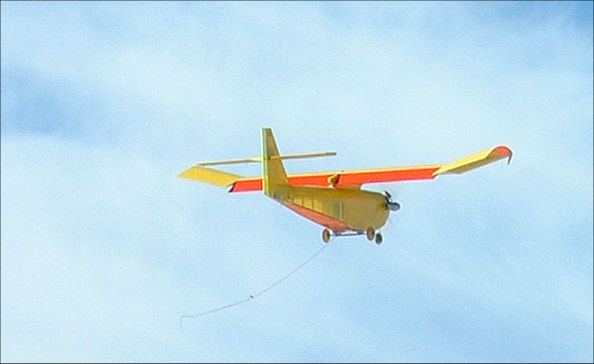

Some of the most spectacular and almost synchronized tipstalls occur in the SAE competitions, right after takeoff when the turn to the downwind leg is begun.
As the pilots for the most part are semi-skilled at best, the rudder isn't a part of the airplane's control system once it leaves the ground. (They don't use it for turning.)
Af the Tailwinds field this turn is to the right.
The crashers all roll to the left.
That's the down-aileron side.

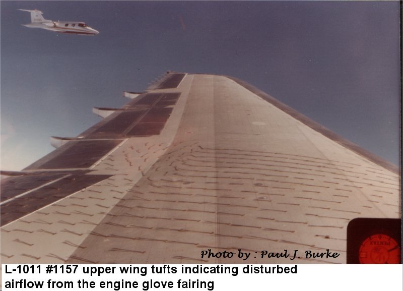

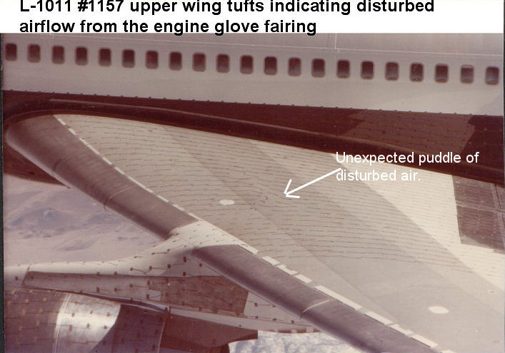

On the Tristar, we prepared the wing on the #1 by locking the leading edge slats up, and bondo-ing all the joints where the slats fit onto the wing itself.
Used all the bondo available in the Antelope Valley.
On the first takeoff, about Vr, as the wings began to take the load off the wheels, they flexed up.... The bondo vanished in a white snowstorm..
End of test.
Removing what bondo that didn't leave ruined a lot of the wing leading edge sub-fairings.
In flight testing, we tufted, and got those things going every way, including forward at cruise Machs..
We tried fairing in the motor pylons to the wing leading edge, with a common-sense fairing everyone agreed would work...
The puddle of air 1/2 way back was a complete surprise...
We didn't use these fairings..
On the first flight with these, BTW, it was noticed the one on the right wing lifted..
"Enough to throw a small dog thru the hole", according to our Director of Flight Test, Sam Wyrick.
We found these things hadn't been screwed on to the structure.. the holes for the fasteners had been filled in with sealant, and the point of the (unique) Tri-head screwdriver pressed in the wet sealant, which was then painted.. The work had been signed off by one of our "never leave the flight shack inspectors, a continuous problem we had.

I built the second wing. The new wing had a sheeted foam core D-tube and the rest was built up with glass on the D-tube at a 45 degree bias. It was bigger, but much lighter than the original. It had 3 degrees of washout, was tapered, had nearly a 10 foot span, and had a lot of camber. That was the most difficult wing I had ever built and don't think it would have been possible if I hadn't scratch built planes in the past.
I finally sat down with a piece of graph paper and designed a new fuselage. I made it strong, light, and accessible. I built it from light ply, carbon fiber, foam, and fiberglass. It was lighter and stronger that the two other fuses. After it flew very successfully we reverse engineered it for the report creating the 3D model and CAD drawings.
So, I built the wing, the fuselage, helped with the tail boom, tail feathers, and landing gear, did the final assembly, flew the plane, and helped with a good deal of the report. I didn't mind it too much because it was more of a labor of love.
I also did static thrust testing on a bunch of props and found our secret weapon. We were asked if our engine had been modified the way it was running. I also made 3" aluminum wheels with O-ring tires and double ball bearing on the axles. I couldn't believe some of the landing gear set-ups I saw. We had very little rolling resistance which made takeoff easier, but landing was interesting because it would roll out a good distance.
Our final plane was very difficult to fly. It was very unstable in the yaw axis, but was flyable if you stayed on top of it. There is no way that an unexperienced pilot could have flown it. We flew it multiple times and lifted 20 pounds well before the competition at a higher altitude than where the competition was to take place. After the first day of flying we were in first place. We ended up lifting over 25 pounds and taking third place overall. I was suprised to see how many teams made the journey without having ever flown their plane.
For us, we were all mechanical engineers and not aero engineers. The project was more about teamwork, crunching numbers, designing a product, and documenting everything. Now that I look back, I almost wish I would have chosen a different project.
It was fun and I would do it again if I had the chance, perhaps we should start the RCU Heavy Lift Competition.............that would be exciting. Anybody interested????
The only teams I thought did well had a serious modeler on them or being advised by one. There was one school that brought nearly the same design every year until the rules changed.
We decided to throw together a prototype as soon as possible. It was one of the best things we did. My part of the project was the wing. I did a foam core sheeted with balsa that came out heavy. The wing needed a little washout and the fuselage just did not work. It was weak and hard to work on. The fuselage broke multiple times on hard landings. We lifted 15 pounds of steel with that plane. That was the max we could get off the ground in 200 feet at a DA of about 7000 feet with no wind. It wasn't too bad considering the plane weighed 24 pounds and was powered by a 61.
The problem with the fuselage was that they were getting on a 3D CAD program and making theses nice tear-drop swoopy shapes. They had never built anything like it before so it was never built right. The shapes also compounded the construction problem. The second fuselage was even harder to get in to access and it broke in the first flight. It only flew once. Again it was not built strong enough for what it was going to do.

Ben, go back and read the tuff stuff. I was on board and I can assure you that the wing drop was abrupt and sudden. And at no time was the tip area stalled as indicated by the tuffs. It is only necessary for any significant area of wing on one side to stall before the other to produce an abrupt wing drop, not necessarily at the tip. As a matter of fact, in a perfectly symmetrical stall (coordinated), if the tips stall, they stall at the same time resulting in a pitch down, not a roll. Only if there is something producing an asymmetrical stall distribution will one wing drop. And the most common factor by far is yaw at the moment of stall.
By the way, in response to your previous comment, on the Cherokee, the fuselage interference may have affected the particular pattern of stall that began near the root. However even remote from any fuselage, with a rectangular wing and no twist, the stall always begins near the root and proceeds outward.
Tip stall is a fact. However it is sometimes an accurate description of what is taking place, and sometimes not.

When flying this thing, a 2003 rules SAE plane.. rudder, elevator, NO ailerons, I got a tip-stall on a takeoff.. The plane self-recovered.
This occured at least twice.
