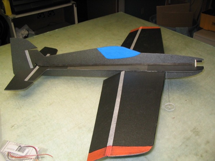

The usual tip-stall occurs when a plane is flying close to the stall angle... and a turn is commanded with the ailerons...
The down-going surface -increases- the angle of attack for the wing section ahead of the aileron.
As the wind is already close to the stall angle, the effect of the downward deflection -lowers- the angle of attack for stall.
The wing portion then stalls.
This effect is seen almost every day with weight lifters, which commonly tip-stall and roll over after takeoff when beginning the turn to downwind.
With a right turn, the plane rolls left... and the pilot is usually caught by surprise, and keeps the right roll command in, which prevents the left wing from recovering.
The cure for these planes is to not use down aileron! 100% differential, so the aileron only goes up.
For these planes that's all the roll control needed.

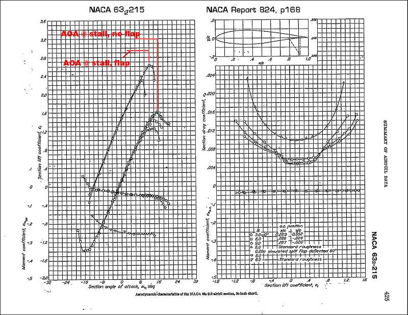

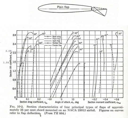

Tall Paul – Just a comment regarding your reply:
As you can see from the attached data, deflection of the aileron (flap) actually increases the angle of attack for stall to a higher lift coefficient delaying the stall. The problem of aileron deflection causing a stall and dropping the wing on which the downgoing aileron is deflected (called aileron reversal) was in fact a problem with some of the very early designs of the last century. I'm sure that it could show up in models that depart from conventional parameters, but I doubt if it is a factor in most cases.
Lou, from a slightly newer, but still really old NACA report (good old 824, available online, as is 664) with the information presented better..
lowering a flap raises the flyable Cl, but that occurs at a lower alpha.
When all the wing is at the no-flap alpha close to stall, and part of it is deflected down, that part of the wing is stalled.
