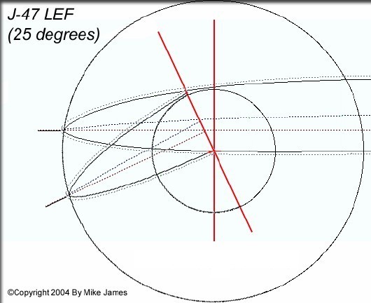

Here's the arrangement I'll be using on my sport jet for the leading edge flaps.
To make this work, I've made a male mold, from which I mold the round interior piece... the "leading edge within a leading edge. (second photo)

Okay, Mike, when the LE flap is deployed, will there be an extension that slips over the top of the wing. Therefore, the flap when 'retracted' (is that the phrase?) would, in effect slip over the top of the wing? Hope my question is clear! I thought about using miniature piano hinge along the bottom to keep things even and lesson the chance of getting uneven airflow. Also, is 25 degrees something you've worked out the math on? I'm guessing as to the flap degrees on the SU-where are all the Flanker drivers when you need them?

No extension is required, if the underlying circular section fits well. That's what prevents a gap.

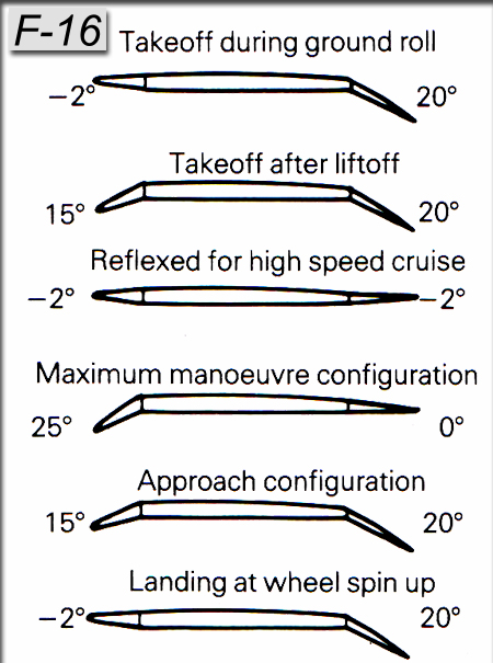

25 degrees seems to be coincidental with full flap deflection on many fighters, and is what Bob Fiorenze used on his F-18. I've attached an image of the published F-16 deflections in various modes, for comparison.

I remember the article (I think it was RCM) on Bob Fiorenze's F-18. In the article, he mentioned that for each wing, he had one servo deploying both flaps and leading edge flaps at the same time. So, in Bob's case, it couild simply be that for a relatively-heavy DF model with full or nearly full flaps deployed, the interaction wasn't right.
Interesting to note that once the leading edge flaps are deployed (alone or with flaps) these fighters' elevator goes to neutral, or in some cases, even to the "down" position. The leading edge flaps seem to move the lift vectors forward, and pitch the plane up. (the desired effect)
