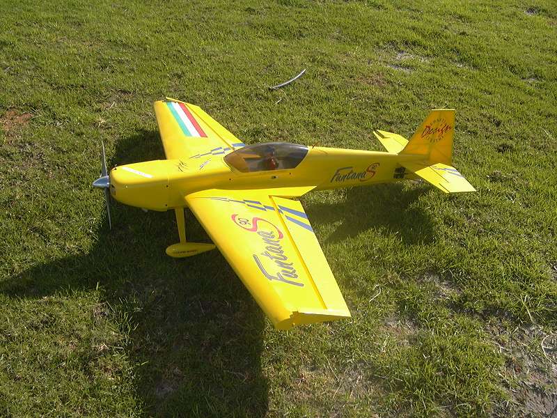

I'm afraid I'm not with you on this one. Have a look at my Funtana pictured below. The ailerons on this beast are extremely large stiff cross-braced structures and have had no problems handling the 50g plus weight fitted in the balancers. Done right they dont look bad either and I have no problems with my wing bags either [8D]
Those balancers really LOOK neat cause of the sort of reverse scoop style. Anyone have any idea if that really works or if its just a large added drag. Also, is a mass balance just the kind with added weight? Are the rudder balancers that consist of just the airfoil that wraps around over the top of the tail considered mass balancers or just aerodynamic balance?

Yep, the full plane shot is a tad indistinct. One comment on the "scoop" design I had was that it would cause the aileron or hinges to break near the outboard end of the wings because of the drag caused by the scoop. Practically, the scoop is faired in at the front and only cataches the air when the ailerons are deflected. After about 6 or so flights, no problems were evident and no flutter occurred despite some high speed passes. Sadly, the plane is in need of a new right wing after a mid air collision and subsequent crash into a tree while trying an emergency landing!!

Thanks for the comments TGDF. The balancers do look rad and seemed to work too. If I manage to replace the wing, the old balancer will be re-used for sure.
