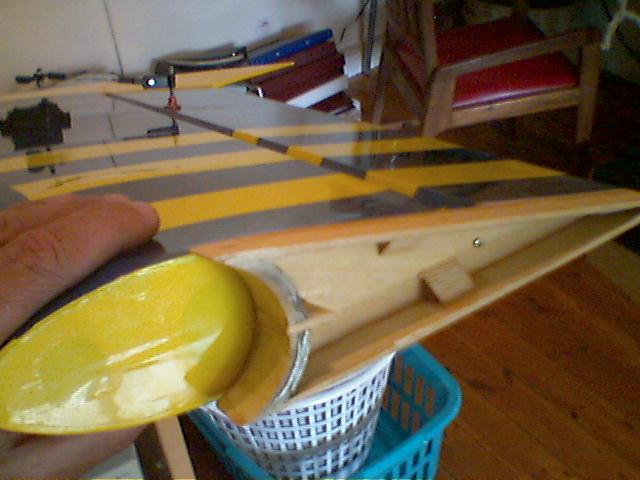

Am busy building mass balancers onto the ends of my Funtana 90 ailerons in an effort to cure the flutter problem this design has if overspeeded. I have read an article regarding full size homebuilts and it appears that overbalancing ie using more counterbalance weight than necessary may eliminate flutter completely.
Anyone ever done this beofre or have any resources thay can refer me to. [8D]

Intersting replies and some contradictory advice. To Rodney, if mass balancing does nothing for flutter, why is it found on various full size planes?
On the Funtana 90, i have noticed that the ailerons are very large and have a different structure to the wing i.e they are cross braced and are stiffer IMO than the wing structure which in typical fun fly fashion has relatively few ribs. I wonder if this contributes to the problem on the F90, which for those that havent read the threads, is a flutter incident at moderate speed leading to catastrophic failure of, usually, the right wing. On my plane the flutter stripped both servos and lead to some cracking and interior damage to the wing ribs. The ailerons and hinges showed no damage at all...
The mass balance idea is to stave off the ailerons tendency to flutter thus increasing the Vne at which flutter may occur making the plane more tolerant of higher speeds.

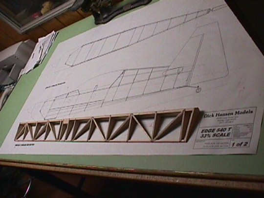

My larger stuf uses built up ailerons (see pics ) of very light full sheeted ailerons -typically tapered 2-1 from root to tip -which gives an extremely stiff aileron.

again BUT- wide open throttle was never used in level flight or a dive.
Power was spectacular and wing loading at 19 oz ft made for good 3D .
Our current electric stuff (no pun) is now way down on wing loading and using flat plate wings -all foam and wing loading is under 5 ozs per sq ft.-on 400 sq inches (AUW of 15 ozs inc batts.)
these will not flutter easily as the foam has such low weight to strength and stiffness.
But they will flutter -- just not come apart.

Thanks for the replies, Guys! Yes, we do like to throw the planes around, but in the case of the F90's, we were both taking it very easy, or so we thought. No yank and bank stuff at all. Dick I see from the pics that you do build the ailerons very stiff, the difference seems to be that the size of the aileron is waaaay smaller than the just about, 1/3 wing area ones on the F90. I have included some fuzzy shots of my mass balancers. Any comments welcome
