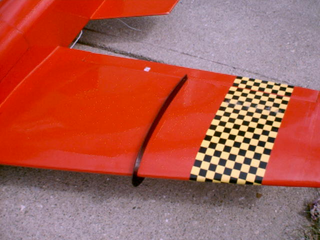

I had a similar problem with an early ducted fan called the Skyburner.
I solved the problem by installing counter-rotating vortex generators and a wing fence. Seemed to work very well. The wing fence keeps the span wise flow from traveling to the tip. The vortex gens act much like the turbulator strips.
vortex gens are used on B-737, A-4, Learjet and many others. Fences on the learjet, mig etc
I just made up 3-sets for each wing, forward of the aileron, about 6" total length, set at about 30^ off the cord line. / \ / \ / \
here's a picture of the wing. The clear vortex gens are in the checkerboard.
Jack

swept wings = fences , QED

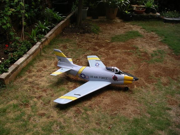

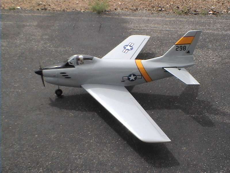

Old 09-19-2006 | 04:51 AM
haze_b's Avatar
Joined: Jul 2006
Posts: 61
From: honolulu, HI
Default RE: Tip Stalling Airplane
Wing fences seem to work well on this model. I do not experience any of the tip stalling issues reported in this thread.

Old 10-18-2006 | 12:13 PM
Posts: 1,928
From: Deland, FL
ORIGINAL: haze_b
I second this idea. Look at any of the swept wing planes of that era and you will see fences. They are excellent devices in the right situation. I would try this. The worst that can happen is they don't change anything.
