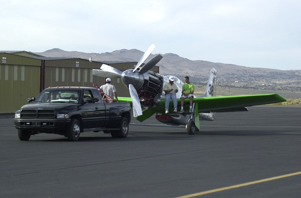

First I have heard of that. Do you have the names of the planes with an assymetric wing trim? Rare Bear has the same wing clip outboard of the wing fold and it's the fastest prop plane on the planet. Pretty sure Strega and Dago Red are also symmetrically cut.
Hum, I have to check, I am pretty sure I saw that on a 3 views for a Reno Mustang. The Macchi MC 72 has dyssimetric wings ( Am not sure if the Rear Bear is faster than the Macchi was....)
Bernard

I didn't know about the asymetric thing. Interesting. Anyway, you would think the higher wing load (induced drag) would negate the effects of chopping the wing...but everyone seems to do it...so there must be some advantage. I got to crew for "Precious Metal" at Reno this year and it's got chopped wings as well. (That's me in the green shirt with the pilot). Had a blast out there!!!
My Feedback: (20)
I was looking through all my Air Race books and the only mention of an asymmetric wing in the post war (1946-present) racing era was the much modified P-51 named "Beguine". This was the plane which moved the radiators to pods in the wings. The owner chopped the left wing down "shorter than the right" (doesn't mention how much). The plane crashed in 1949 which effectively ended the Cleveland Air Races (Well, that and the Korean War).
Nobody knows the cause of the crash but witnesses say he rolled rapidly to the left and then slow rolled to the right before crashing into a house. Pilot witnesses say he may have misjudged his turn into the pylon and tried to roll out but couldn't retain control.
Speculation of the crash on my part - Low time pilot and an assymetric cut on the wing.

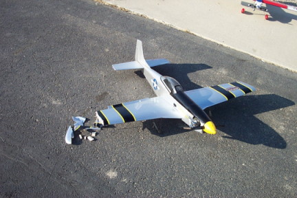

Just don't use the same techinique I used to clip the wing.
I was at a fly-in hot doggin my Mustang. This was the first time I had flown at this particular field. I went in for a low inverted pass. I was about 5 off the ground when I heard a whack and the plane looked as if it had exploded. It so happens that I clipped a support wire for a wind sock that was mounted in the middle of the flying field. I lost about 4 inches of one wing as well as a good part of one aileron. The plane yawed hard towards the tip that hit and pitched up. I was able to recover and land the plane. I had to hold almost full aileron to keep it flying staight and brought here in using the rudder. It was an ugly landing, but the only damage on landing was a bent retract.
There was a group of pilots in a circle talking when it happened. I'll never forget what I heard one of them say sounding a little puzzled, "I heard him crash, but he's still flying."
That's the last itme I want to fly anything with a non-symmetrical wing. Sorry, quite a bit off the subject.
