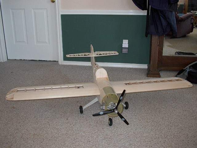

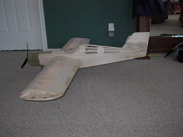

If you take a look at the jet on your Pic on your user name...... you will see how we do our latest aerobatic project. I like to call it a t-tail. It is however not really a t-tail as it (the stab) is not quite to the top of the fin. The wing is on the thrust line with 1 degree positive and the horizontal stab is 0 degree from the datum line. These are some really stable....... yet aerobatic planes that will perform like crazy...... yet almost land themselves. If I knew how to download a pic... I would send you one of the plane in the bones........ ready to cover. It is the third in this series of experimentals we have built. The first suffered a catrastophic failure of the crystal on the third flight. The second is still providing very good service........ and the third we changed up a bit to see what would come of it..... ie ( about a 20% airfoil that is not quite symetrical.... with just a bit of a flat area to give a little extra lift). Hope this is what you are talking about...... if not I appologize. Tex
Cheers,
Grant
P.S. The tail configuration you were describing is know as cruciform.

Thank you for the info Cadet. Here is the t-tail...... as I call them. I have found that they actually are cruciform....? (sp). We have no problem whatsoever with this design. My friend that is teaching me scratch building tech...... is the one to origionally design this I believe. If anyone has any thing to add........ please feel free. We just drew this one up on freezer paper....... and built it. The plane came partly from a pic I had in my mind. Thanks, and I hope you enjoy the pic. Also..... the tail wire braceing will add to the strength. Tex

Hi MikeJames. I tried to e-mail at the address you gave and could not get through. Here is another view of the (cruciform) tail plane. I guess I am calling it *Somethin Else* Thanks, Tex
