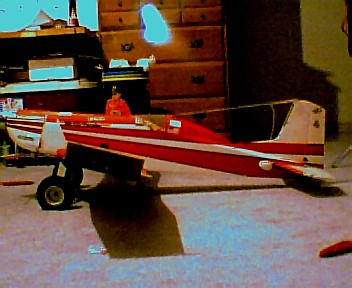

im not sure what u mean William Robison, but is this what you mean on the vert stab? Like the stang. The agwagon has few caracteristics like the stang to start out with, so i might all ready have them on the plane.
My next option its to throw some weight into the tail to balance it.
thanks for the info.

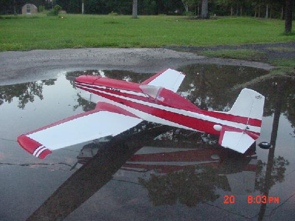

this is the most recent picture of my agwagon. I had a 4 blade on it, sounded and flew great. now im back to a 13-6. I had to put quite a bit of off thrust on to engine, it torqued over on almost every take off, now I dont have a bit of problems with that.
Those little tiplets of yours are awfully far forward in the wing. Perhaps these are creating a de-stabilizing force that's competing with the vertical fin and rudder. My advice would be to rip them puppies off and see how the model flies without them.
Are they scale? I can't imagine them being shaped like that for full size. They don't look like the usual NASA winglets at all. For starters the ends of the ailerons are exposed. Certainly they would make lousy end plates for controlling tip vortices with then being so short at the rear. Perhaps this is what is causing the nasty tip stall, the vortix is sneaking around the ends of the ailerons and doesn't want to let go until you power out of the spin.
And I think what Will is reffering to is often called a dorsal fin or dorsal gusset. It's the short ridge running along the upper fuselage from the base of the more normal fin, ie: the bit they added when they went from the B model to the D model. Actually you've already got it.

I thought I had that little gusset.
The tips arnt scale, I made them after I cartwheeled the plane, destroied the scale wing tips--the cost of the wing tips are i think $30 a pair. The original curve down, hard to make.
I want to have wing tips on it, but what other kind of wing tips can I put on it to make a better flying plane, do I need to make them longer?
To tell you the truth, after I put these on , the plane turned better and didnt fall in a turn, as if acting as wings.
Do you know any NASA wing tips I can put on this puppy, that look good, make it fly better, and fairly easy to make, consider it took 2 hours to make the ones on it right now.

Seeing his picture I agree 100% on his wing tip destabilizers. Rip off what you have there, Dago, and replace them with flat plates extending from the LE to the trailing edge of the ailerons. Make then exrend no more than 1/4" to 3/8" above and below the wing. I think you'd probably be better off with nothing than what you have.
And Bruce, "Right again, Robin," it's the fin gusset I was talking about. If the correction of the tip abomination doesn't take care of the problem, add the gussets to the stab. With those instability generators off the tips shouldn't need anything else.

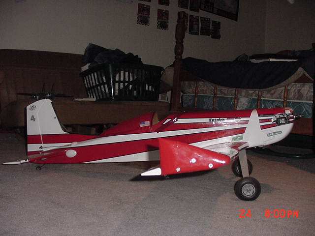

Ok, last night I added 4-5 inch monster truck wheels to the agwagon. our field is wet, and muddy right now. On the test flight every thing went on. I did all the normal manuvers that sometimes had the begining of a flat spin after. I never had it try to flat spin, but I did stall it, and it was tip stalling side to side while falling.
Could these monster tires have stoped the the flat spin episode?
Im going to remover the wingtips this week and build the flat plate wing tip for it.
Perfect flying day, my biggest problem is the tire came off the rim on a landing, funniest thing Id ever seen.

A little crude but should be more than good engough for a test. You can always round off the front corner.

Ill probabaly leave the the way they are,Im running out of paint, Ill test the plane this weekend and let you know what happens.
Ummm, ...... this may be a silly questoin but why do you want tip plates instead of just a plain old sorta streamlined rounded tip?

Possibly at my suggestion. This way he has a lot of the advantages of the (reversed?) Hoerner tips, without the aggravation of carving them.
Keep at it, Dago. We're with you.
