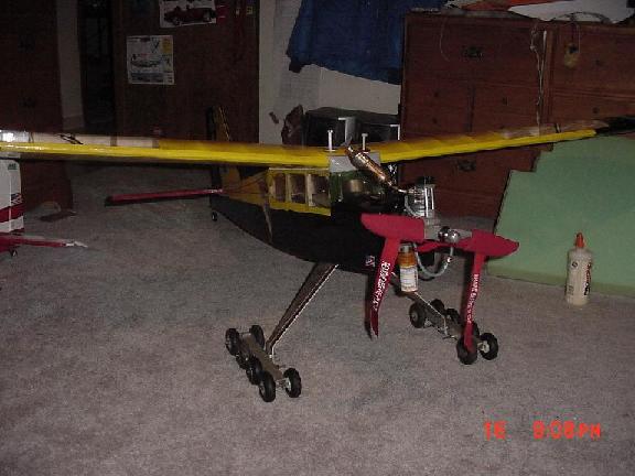

Thanks flypaper , im not sure what im going to fo with that plane right now, its done it 3 times to many , to fast, so im going to take a break from it.
That test bed kadet I told you about, heres some of its flights, first flight was done with 16 wheels, then 21 wheels, then mods to the air frame,then put on a differ tri gear the didnt work, then mad it a tail dragger, o yes while being made a bigger tri gear , it sprung a fuel tank leak, the whole front end had to be rebuilt. Its a heck of a plane, took 2 years to build, on and off.

o yes, it never made the flight with those 13 wheels, the engine wouldnt run, took it of and had a friend look at it, then I had to use the some wheels for anothe plane, so it uses 4 inch wheels.

What on Earth was the reason for the multi-wheel trucks? Just to be different? Was there some logic to it? Wow.

the reason for a 21 wheeled beast was to be different, plus i was wanting to see what would happen, its just me. just like making my agwagon into a sort of racing plane.
