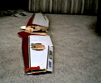

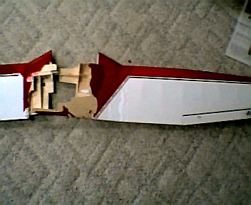

Ok, heres my description from taxi to takeoff.
I taxied to the center of the runway. I gave it the throttle to start rolling, once she was rolling i gave about 3/4 throttle, she lifted off, so i gave the rest 1/4 throttle and procided to make a left hand turn away from the field, she seemed to procide for a second then made a huge right hand turn sight in to the ground hitting the wing first busting it in to 2 major pices with about 30 splinters. the fus was crashed behind the wing with the wing hold down ripped out, broke the prop and left a deep hole in the runway. Every one likes how I crash, on the runway so we can see the pieces fly. It broke off one wing tip, do you think wing tips have somthing to do with it, ever since I put custom wing tips on it seem to do strange things on takeoff. the firewall is still in plane,lol. ill take some pics and post them.
not sure what is wrong with it, but im starting to think its the wing tips, need to by those $30 wingtips for it.
#35
OUCH.....
Sorry to see that DR. There's no doubt that the style of plate tips you have used so far are a destabilizing force. Even the stock Hoerner tips would have been a slightly destabilizing influence but the model was apparently able to handle them.
I would say that despite how it looks you can fix it but it's going to pick up some weight which will tend to make it even more touchy for stalls and all. But it would make a good test bed for experiments.
I'll still send you that jpg on the tips for the next one.

Dago:
I've done worse, looks repairable, even if half the wing is new construction.
Confirm: She rolled right out of a left turn? If yes I would dismiss any aerodynamic cause.
Give the radio gear a very close inspection, the bits have had a somewhat hard life. If a glitch gave you hard right rudder that could be the cause.
And I'd hate to think the tip plates did it, especially since I told you to try them.
Ideas, Bruce?
Check everything, Dago, let us know.
I may be totally a dunce,
. but I don't think it could spin both ways at once.
Bill.
