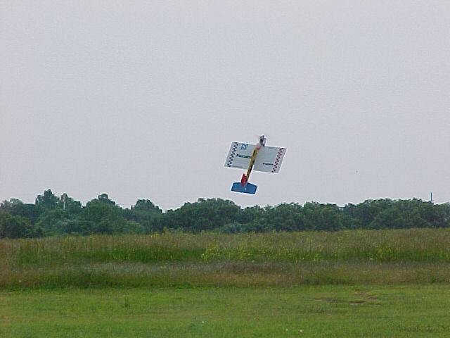

Actually, I don't have to do a comparison, because this airplane actually grew out of 5 years of just such experiments, and well over 300 wings, and until this airplane, using 4mm for a .25 sized airplane was too heavy. To close the wing would bump the weight up another 3-5 (or maybe even a little more in sandwiched ailerons and glue) ounces and destroy the airplanes wingloading...yes it would fly, because we've done it, but with nowhere near the performance.
I'll have to agree, on the equipment, and it's taken me years to get over the phobia...but let me put it into perspective...in the last 5 years I've built and flown over 300 airplanes, and currently own 20 flight packs. In the last 5 years, I've lost only ONE Rx and it was due to a mid-air, and have lost only two standard servos. In other words, the equipment has never failed because of it's envoronment, and believe me, I put it through hell. In comparison, years ago I had a Falcon 56...I was learning how to tear up the sky and flew it hard...and the spar broke. The lawn dart landed in the parking lot, and NOTHING inside the airplane survived...including the engine...all reduced to garbage. The ONLY thing left from that crash was an aileron servo with no lead. I guess it's all relative...because that one crash ruined more equipment...than the rest of my R/C carreer put together.

In the last couple days, several other guys have built and flown this latest design, and the reports are coming in...the overwhelming observation is stability. The plane won't stall or fall off at all. When it reaches nose high stall speed, all it does is begin a slow harrier decent. One guy even said it was stable enough to use as a trainer, and on slow flight, had self righting charicteristics of a dihedral wing. There may be more going on with this airfoil than I understand. I've also been told that although respectable, the ailerons are not as fast as one would think on a wing span of this size. Is it possible that some kind of stabilizing airflow is being generated under or at the tips of this wing giving it the stability and resisting roll input? In my experience, a wing this size would normally roll 5 or 6 time a second with a normal airfoil...this design with the same aileron travel gives me about 2 rolls a second.

I just had to come back here and thank you guys for inspiring a design that has turned into the most fun I've had in R/C in a long long time! The simple airframe is inspiring all kinds of directions, and I wouldn't even be able to guess how many are flying now!

After examining my BUHOR wing while it sits on the dining room table, drinking lots of coffee and playing/ bending things, I think that what happens to this wing shape at high angles of attack is that the ailerons "washout" at the tips somewhat. They are stiffest near the root of the wing, and are actually quite flimsy near the tip. At high angles of attack, then ends of the ailerons would flex to align themselves more to the direction of the airflow at the tips of the wings than at the root. Am I just blowing smoke here? Am I wrong?

I also think this is what happens to the QHOR, except that the entire trailing edge tips of the "wing" flex upward considerably when the nose is pulled up sharply. I can SEE the tips flexing up quite a bit. This would have the tendency to stabilize the manuver, as the only part of the wing that would stall would be the center.

Thought you'all might be interested in some videos of the aircraft that have been inspired by and created because of this thread.
http://www.hsrcm.com/awe-hor_movies.htm
http://www.riversedgerc.com/communit...p=getit&lid=37
http://rcfunflyers.com/DANNY%20SPAD%20QHOR.WMV

Looked at your movies, I must say it does fly well. What happened though - the ones you showed us in this forum look nice but the ones in the first site I looked at looked positively homely.

It's all about cheap fun, not necessarily asthetics. These planes cost less than $10 to build, and usually less than 2 hours to do it. Amazing when you consider they outfly airplanes many many times their cost. BTW, the videos are not my planes, they were found in various topics here on RCU...the designs and ideas are really getting popular.

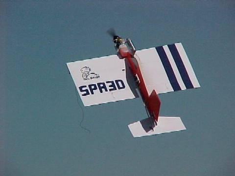

Just thought I'd revisit the thread that inspired the most fun plane I've ever flown. It's still evolving. The latest has an almost flat wing with a much rounder leading edge (Imagine that Cajun!
) and the flight charicteristics keep getting better! Like I've mentioned previously, I know little about aerodynamics...I just build em and try em. This airfoil would be an interesting one to anylize. High alpha crawls, hover, and inverted pitch response in incredable, the wing refuses to stall, and yet full throttle stability is solid as a rock. Flat spins, especially inverted beat anything I've ever flown, and if done just right, can actually gain altitude in the spin.
One page plans
http://members.cox.net/spad/pics/spa3d02.jpg
Building instructions (Text)
http://members.cox.net/spad/pics/spa...tructions.html
Reference Photos
http://members.cox.net/spad/pics/spa3d01.jpg
http://members.cox.net/spad/pics/spa3d03.jpg
http://members.cox.net/spad/pics/spa3d04.jpg
http://members.cox.net/spad/pics/spa3d05.jpg
http://members.cox.net/spad/pics/spa3d06.jpg
http://members.cox.net/spad/pics/spa3d07.jpg

I'm one of those guys who love the smell of balsa on a warm afternoon. This Spad stuff, though, has me intrigued. One question. I see a lot of servos zip strapped to the airframe. Vibration not a problem? Or, do you just use cheap servos and toss them from time to time?
BTW - I use run-of-the-mil Hitec HS-81MG's, HS-300's and HS-422's for all my planes.
