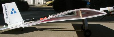

I don't know what we did right (or wrong), but this wing with a leading edge as sharp as it could be is the best flying airfoil I've ever flown with none of the traits I've read or heard it should have. It would be interesting to hear why from an educated perspective.
I've flown Balsa planes for 20 years, and plastic planes for the last 5 years...and to date, the best flying airplane I've ever had is nothing more than a discarded gas station sign folded over a yardstick, rubberbanded to a couple aluminum rails. Less than 3 hours work, but the look at the field is priceless

Lemme 'splain - or at least try.
Sometimes, when all the factors are right, a sharp leading edge results in a spanwise bound (surface)vortex that sits just behind the leading edge. It's a small cylinder of air that sits there and spins, and deflects most of the oncoming air up and over it AS IF THE LEADING EDGE WERE ROUNDED. THat's why this wing behaves quite well.

It looked like an airfoil with a flattop hair cut. But it worked, quite well.
We had tried a triangle facet (flat bottomed with one fold on top at the spar). This airfoil flew fine at higher speeds...but the slower it got, the worse it got...and trying to land the plane looked like the six million dollar man rocking back and forth and crashing!
Then a Cessna engineer flying buddy tried explaining burbles and boundry layers and air seperation...we really didn't have a clue what he was saying...but... we went home and did exactly what you said...gave it a flat top...with a 1" flat section it made for a triple facet (flat bottomed with 3 flat surfaces making up the top wing). This wing flew GREAT, and was the airfoil we stuck with for almost 2 years...and many are still being built and flown. Our Cessna buddy said very much the same thing you did about the sharp leading edge...he said the air flow was close enough to the wing but didn't seperate from it...in effect the air was fooled and "thought" the wing was a true smooth airfoil, as you say the air may "think" the sharp LE is actually round due to the vortex? This is cool...I might actually be able to simi explain it next time it comes up at the field
I'm not so sure you could consider that as sharp. Looking at the side view I see a fairly nice radius thanks to the folding of the corroplast. What I DO see is perhaps a shallower than normal curve on the leading edge...... and gobs of wing area. Perhaps it's flying well thanks to the area? And the strongly cambered section with the "flap" deflection in the rear. Strangely enough what you have for a shape there isn't far off some sailplane airfoils and follows a number of the rules of thumb for free flight airfoils other than thickness.
It would be interesting to run this shape through Xfoil.

I wouldn't really call it a turbulator. THey just call them bound vortices.
If you see an F-16 or an F-18 at an airshow on a sufficiently humid day, you'll see a chordwise vortex next to the fuselage marked by vapor when he pulls g's . That's a cool way to delay separation, but that's not what I'm talking about here. If you see an F-15 on the same day, when he pulls g's the vapor-vortex will appear on the outer half of the wings, right behind the leading edge and almost parallel. THe F-15 wing was designed specifically to let that vortex build there and delay stall. Sometimes you can see a spanwise vortex somewhere around the slats on the other two types as well.

X Foil seems to have a little trouble with sharp LE airfoils, I was only able to get it to run once. The one I did get to run had these weird pressure spikes up to max thickness, then a normal recovery; I think it had more to do with the way I was drawing the airfoil, it didn't come out exactly flat.
Anyways, X Foil also did not show the vortex forming on the LE, but then the vortex will probably be 3 dimensional in nature and X Foil is only a 2-D program, so that's not surprising. With that in mind, X Foil did predict an increasing Cl to about 0.8 at AoA = 3.5, then Cl decreased until 0.6 at AoA = 8, then Cl started going up again until about 1.25 at AoA = 13, and then decreased.

I have read a few posts here about sharp-edged wings being unstable in pitch and 'hunting'. There could be something going on that I don't know about, but currently, I don't think those are genuine characteristics of sharp-edged wings. A sharp leading edge causes a few things:
1) It 'fixes' stagnation line ( the line at the leading edge where the air divides between the upper an lower surfaces ) so that it doesn't move up and down as the angle of attack changes.
2) At moderate angles of attack, it does result in a small, localized separation bubble just behind the leading edge. This separation bubble is sometimes called a 'rolled vortex', and is what Johng called the 'bound vortex'. In actuality, this is not what the term 'bound vortex' refers to. This separation bubble does have really strong vorticity, but the term 'bound vortex' refers to the 'circulation' which always exists around a wing which is generating lift. This separation bubble can indeed cause the flow to become turbulent, and hence prevent a larger, laminar, separation bubble from forming further back on the upper surface, under some circumstances.
3) It causes massive separation ( stall ) at a lower angle of attack than a rounded leading edge would.
None of these effects results in pitch instability, or hunting, as far as I know, so it is not surprising to me that your wing works just fine. My impression is that these characteristics of sharp leading edges are aerodynamic urban legends, but I would be happy to learn otherwise.
I would guess you get such good results because you have a perfectly reasonble wing shape, and low wing loading. If you needed really high lift out of your wing, which is very rare for our models, then the sharp leading edge might cause some problems.

Tatoo, not to make fun of your quite nice flying airplane but it sure is ugly! Nothing personal and beauty is in the eye of the beholder and there is beauty in its functionality but ............ How could you possibly keep interest in that many wings on something that .... functional? Just kidding, just kidding...... maybe.
If you did a little rounding on the sharp corners and kept the undercambered aft part it is not all that different from the airfoils a lot of modern gliders are using. Ok maybe stretching it a bit but the undercamber does make a nice airfoil better for good upright work. It cannot be as good inverted since it is optimized for upright. It also depends on your criteria for determining what is good.

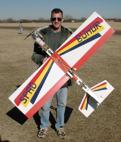

...don't worry, the plane is so ugly...it's name is actually the Big Ugly Hell on Rails... or Big Ugly HOR for short

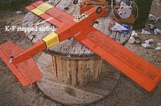

Speaking of vorticies and unusual airfoils, here's some interesting stuff a fellow Spadder just showed me
...I've never heard of a steppedfoil before!

Klein-Fogelman... I have their book.
Perhaps the "America's Cup" guys might look at it.
Basically it's nothing more than trying to push a sailboat with a fan attached to the sail boat blowing into the sail.
Several years ago my nephew got me interested in the thing. I built a wing for a Goldberg Mirage using a 23012 with K-F step on the bottom.
One of the best wings I've built.
I still have it, thinking of covering over the step to make a real wing out of it.
Flying exhibited no unusual characteristics such as faster/less fuel needed.
With all the negative results K-F eventually decided it was a "safe" airfoil. Difficult to stall or something like that. As it required more power than a conventional wing to operate, and would therefore be less efficient, I think the aviation community yawned at the idea.

Interesting stuff on the stepped airfoil. It is of course difficult judging something without looking at wind tunnel data and something that indicates the accuracy of the wind tunnel test. It is certainly not something that would give you an immediate "whow that looks like the way it should be done" based on the birds in the backyard.
Certainly there is no advantage in structural weight. For a given load the structure would need to be heavier as the structure in the cutout near the centerline of the airfoil isn't as good at load carrying as the same material at the surface of the airfoil.

I experimented with the Klein-Fogelman airfloil on models in the late 80s and found them to be as the originators stated. They were very difficult to stall. I saw no other positive characteristics in comparing them to the Kadet Sr. but, I like to experiment and the experiment was fun.

You've gotta hand it to them SPAD guys...they really make an effort in decorating their planes.
Take a look at the nice graphics on TATTOO's plane, must be a lot of work in them...

the instructions for the plane the are here
http://www.spadtothebone.com/SPAD/Buhor/
The 4mm coroplast has a lot more tension in it, and when the pressure is reliesed, the leading edge raises a little more, and it doesn't get as much undercamber as the 2mm wings. You have to do some serious clamping to keep the leading edge down while gluing
It also seems like the 2" of extra chord has made a huge difference in performance.
Rudeboy, man...them Coke and Mountian Dew graphics took forever to do!...and I didn't even get any sponsor money!
...but I simplified the graphics on my next one

I worked on some stepped airfoil research when I was in college as well. Had a professor that thought it would work especially well on unusually thick airfoils. Tested a step on an airfoil that must have been 35-40% thick. - Like a potato with a flap attached to the back end. The step behind the high point turned the flow considerably more than without the step. Not that it made it a practical airfoil though....
FWIW - There's nothing wrong with the use of the term "bound vortex" in this context. It happens to be widely applied as a virtual element in wing theory considerations, but that's not the only place it may be used. A web search on the phrase turns up it's application to real vortices on anything from airplanes to sailboats to swimmers' hands. The best definition I've found shows how broad the term really is - from an online fluid dynamics course from MIT:
The only requirement for a vortex to be a bound vortex is that it is held in one place wrt the fluid flow. That is what we see in these step airfoils and on some sharp LE's.
I think that the reason sharp LE's are thought to hunt is again, vortices. I would bet that small bound vortices are continually forming and dispersing behind sharp leading edges at low angles of attack - which change the lift in an erratic fashion. I don't have anything to prove it, but that's the explanation I think is most likely for "hunting"
BTW - THat's a cool web site link to the step airfoils from Tatoo.
