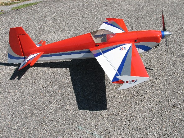

Extra (260) wing loading
I have just built a 27% Extra 260 from a kit, foam core simmetrical wing. Then, at the end of construction with everything installed, I have put the plane on a scale and calculated the wing loading. I found an unexpected 35 ounces per square foot!!
Calculation is correct, beyond any doubt, and now the problem is how to make her fly. Through the radio setting, I have got the option to use the flaperons since I expect that I need to ease and slow down landings somehow.
What could the proper flaperons throw be for this plane? Or else, any other suggestion here?

Hi Rodney,
thanks a lot for your hint, even though it is 17 years old I didn't know it and it sounds very logical to me. Actually, as you say, the plane size matters and large designs can fly at higher wing loading indeed. Now the question is how high the wing loading can be.
Mr. Reynold's formulae should be the answer if I was able to calculate 9,98 sq.ft. raised to the 1.5 power.
Yesterday I have been spending 2 hours in looking for the logaritmic chart (assuming that 9,98 is almost 10) in my high school books but too much time has passed and my brain got rusted too.
Ok, here are the data:
Weight (at flying condition) = 352 oz
Wing area = 9.98 sq.ft.
Do you think this plane is a floater? If not, since our field is short, how can I slow down its landing speed? Will I be able to fly only on windy days? Is applying flaperons the solution?

Yes, it will be a floater, WVL is somewhere between 5 and 6. Depending on your power, wind should not be problem, you will just have to fly it down to the ground, not glide down under low power. Just fly it down until it is only inches above the ground then cut your power to idle. Incidently, your computer (if using microsoft software) should have a calculator at your fingertips, if so, you should have scientific notation available on it.
I calculated the wing loading WVL according to the Reynold's formulae, after I had found a scientific calculator
, and I found that it is something above 11.
To be exact, 352 oz divided by 31.5 (9.98^1.5) = 11.17
It won't be a floater.

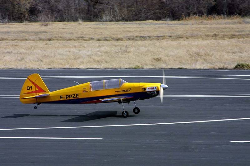

1425 sq inches on your model - that is above 27% of scale of the EXTRA 260-
but many kits are interpretations of scale, not scale per se.
My own version of a Giles 202 model , was 1500 sq in and of a Dalotel was 1550 sq in both were 18 lbs aprox and both used ZDZ60 on 24x10 props (MenzS )running at 6400 rpm - both excellent performers . 22 lbs will give mor scale like performance --few very few full scale planes will hang on the prop - a local guy has a Pitts 12 which will -but not accelerate from that position.
somewhere around these numbers with the ZDZ60 will deliver a really good performance combo.
The clipped wing EDGE (a H9 kit and piped ZDZ80 J ) I call "Godzdzilla " really does have good power to weight - the static thrust is as noted but the best part is that reserve thrust at cruise speed is also instant . Net result is that any maneuver from any attitude can be accelerated . Just like a good foam/electric setup.
