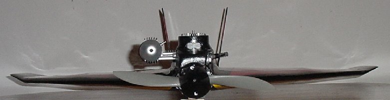

I want to thank you guys for your help over the last few weeks. I finished the Delta wing and it flies great. There is a build thread in the "Extreme speed forums". Other then engine cowl time I had it ready to fly in four days. There has been a lot if interest in this plane so I may try to put a few kits together. It came out with a ready to fly weight of 2 lbs 10.8 oz but I did have to add a couple of oz. of lead to balance. The wing span is 32 inches with a wing area of 475 sq. in. The engine is a TT 46 pro for testing and is turning a 9 x 7 just over 16,000 rpm.

I have been reading that people put up to 10 x 10 CF props an a OS 91 DF engines and tip speeds are very close to critical mach. A new world speed record of 244 mph was denied this year in Germany because of too high a wing loading.
My engine was broken in on the bench and the first flight was without a cowl. The second flight was with the cowl. It was probably a minute after the engine quit before I thought about engine temp but at that point I was able to lay my fingers accross the head without discomfort. I will check sooner Saturday when we fly. I have a Doppler program to determine speed from audio on a high speed pass. It seems fairly accurate and I hope to have some #'s this weekend. The forcast is good. There were several comments about how fast my plane was going but after flying Jett Engineering engines this TT 46 only looked kind of fast.

That's what I say, "wussys...". This is my fourth plane in a row without gear so who needs them. However, turned down tips may look good but but get alot of wear during landings with out gear. I thought about that and maybe could have reinforced them to withstand the landings. I am really happy with the way it looks and thank you for the compliment.

The first 15 seconds is my brothers attempt to get the launch on tape. I had to let him go after that.
New stock Thunder Tiger Pro 46 running just a tad rich. The prop is a cut down sport APC 8.75 x 8.
36 meg. You may want to right click and download first.
The faster runs appear to be close to 120 mph. The pass at the 2 minute mark seems to be the fastest. Ready for some serious power now.
