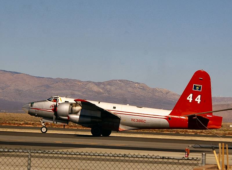

Don't know anything about RC, but tricicle gear airplanes for Contol Line Precision Aerobatic competition, where takeoff and landing are scored maneuvers, are generally set up slightly nose down. Bob Palmer told me to have the leading edge of the wing 1/8 inch lower than the trailing edge (0 incidence in wing.) Worked nice for me.
Jumping in 1/2 cocked. As usual.
A-10 sits nose down big time. Engines are tipped up big time.
What happens at takeoff speed with no one on the stick ?
It takes off by itself, if you are busy polishing your boots.
