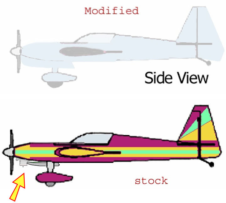

I am building a Sig Something Extra one of the many mods I intend to make is to fair the wing into the fuselage. It is my understanding that this will reduce the drag that is caused when you normally have with a square joint to the fuselage.
Your opinions/suggestions...
One consideration I am thinking of using is to raise the AOA of the faring at the fuselage. I am of the understanding because of the built in washout of an SE wing that tip stalls are not an issue anyhow, but this just would be an enhancement to that design, not to mention it would look good. I also intended to round of the lower part of the fuselage as another improvement to reduce drag. The aircraft will have a full cowl over an inverted engine mount as well as the vertical and horizontal stabs having airfoil shapes and no flying wires.
Why you may ask, just to have a SE that has a clean look.

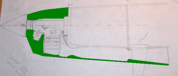

ORIGINAL: iron eagel

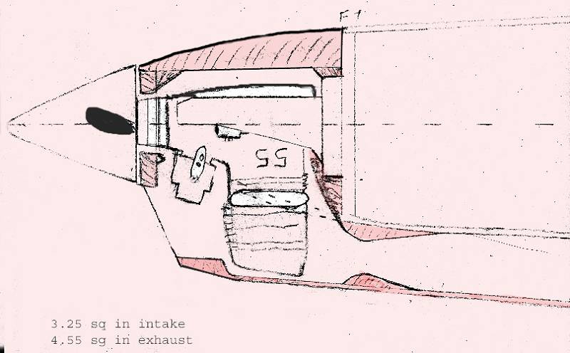

The cowl arrangement will add approximately 16 inches in side area to the fuselage, most of which is ahead of the stock COG. While I am fairly sure this will make the KE performance much better I am concerned this may affect spiral stability. Although adding more rudder area should negate this (I hope).
Don't sweat it. The improvement in aerodynamics is going to be well worth whatever MIGHT happen to the spiral stability. And if you do notice something, it's dead simple to add area to the rudder or fin. And it's easy to test the additions since you can simply tape card stock back there and fly.
Have you considered that the increase in side area should not include the side area of the engine. It was already there. So if you've figured the fuselage side area to be 16, then all that 16 sq.in. isn't actually additional.
DA your right I did add the side area of the engine above the carb to that figure and the head area would have already been there. So I am adding around 13 inches to the side area, my concern was that all of that added area is well ahead of the stock COG and may be an issue. I have planed to add about 3 square inches to the rudder already, just from what I have read about the mods others have made to the plane. I was just afraid that adding so much side area forward of the COG might cause some issues in level flight.
I got to stop trying to over think this thing...

My major concern with doing this is to enhance the flight characteristics of the plane not to trash what is a basically good design. The Sig SE is a good plane built as it comes out of the box, but being an engineer it is hard for me not to try to tweak it a bit. I know the knife edge performance is lacking and a lot of builders have added fin and rudder in order to improve it, others have used Side Force generators. It seems that the real issue is the amount of side area of the fuselage and short of increasing that everything is a stop gap measure. So I decided to approach it from that direction adding the cowl and a cooling duct to increase the side area of the fuselage, hopefully without a negative impact on the overall design. But I am not an aeronautical engineer and seek the input of others with both more knowledge and experience, as to what the changes I am thinking about will do to the performance. You said “Lateral stability is an odd creature. Too much is often worse than too little.†, and I am a bit aware of this, hence my question. I have included a bit more of the sketch,and one for the rudder, so you can see how the duct for the cooling adds to the side area behind the cowl, along with the added rudder area. The blue shows the fin and rudder as on the plans the red is the added area along with where it will be tapered.
I would rather feel stupid for asking questions about what may be a non issue, than to forge ahead without the input of others and trash the build of this plane.

edit to add rudder picture
OK, the green in the image below shows just what added side area the cowl is going to add to the existing airplane. Not a lot. All that other stuff that isn't green is already there and works as side area already.
It actually takes a fair amount of additional side area up front to have much affect. Why? Because the rudder/fin side area is usually about twice as far from the neutral point as the up front stuff. Leverage works everywhere there are levers.
I'd bet the farm the increased rudder is going to more than handle whatever effect the front adds to the situation. Truth is, from personal experience, I'd want a bit more increase back there just for the additional power. Especially since the model seems knife edge challenged. PLUS, the new outline just looks better than the original.
I don't remember, can that rudder snap that airplane with just elevator/rudder? Or do you need to hit the ailerons too? If the answer is that the ailerons are needed, then if I were you, I'd double the increase back there.
If that airplane wing is non-tapered, the wing planform is a rectangle, then I wouldn't even begin to worry that the increased rudder area could cause problems.
This is the actual side area the duct is enclosed all the way back to just about the stock COG.
As far as I know everybody is adding a lot to the rudder, many I have seen use large counterbalances also. I had hoped that by adding to the side area ahead of the COG would be enough to improve the knife edge. Perhaps I should add a lot more rudder than I have already.
AS far as the snap with elevator/rudder I do not know I have not flown one myself, yet.
Perhaps Tall Paul could answer that question he has had several by the looks of it...
It is a tapered wing that is why I am concerned. Stock it has a real fast roll, although I have cut down the ailerons so it may not be as responsive in roll. Although I am setting up the ailerons on pull/pull so I can mount the servos 8 inches further inboard than stock to make the wing tips lighter, and keeping the most mass close in to the roll axis of the plane.

I have the cooling intake exhaust ratio set up at a 1.4:1 ratio as per the section of Andy Lennon's book that talked about cowls.
One comment he made was about the Hawker Hurricane cooling setup and how it was designed to add thrust while in flight. That and some of the examples he used suggested that you might be able to design a setup, where as best as I grasp it you have a thermal engine. Hmm interesting.... That is why when you look at the side view of the ducting a pipe springs to mind, or perhaps a rocket combustion chamber and nozzle. Yea I know really a reach...
With the four stroke it would be very easy to pipe it with off the shelf components. The stock exhaust could be easily modified to be piped, and to be honest with you I am still bouncing back and forth on which engine to use. I have an OS 70 four stroke, and an OS MAX 55AX, they both are almost identical in weight, size and performance, and it would be neat to really go full out to make it look as sleek as possible. All this not for speed but but having a very clean airframe to get the best flight time out of a tank. Not to mention having a plane that looks cool, a really nice fun fly maxed out. Why just because you can do it....
And given the broad envelope I want the plane to be able to fly in, a neat experiment if nothing else.
