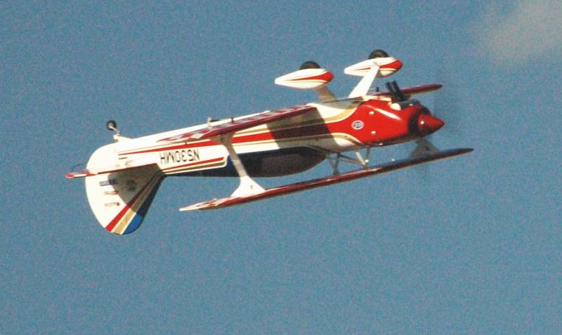

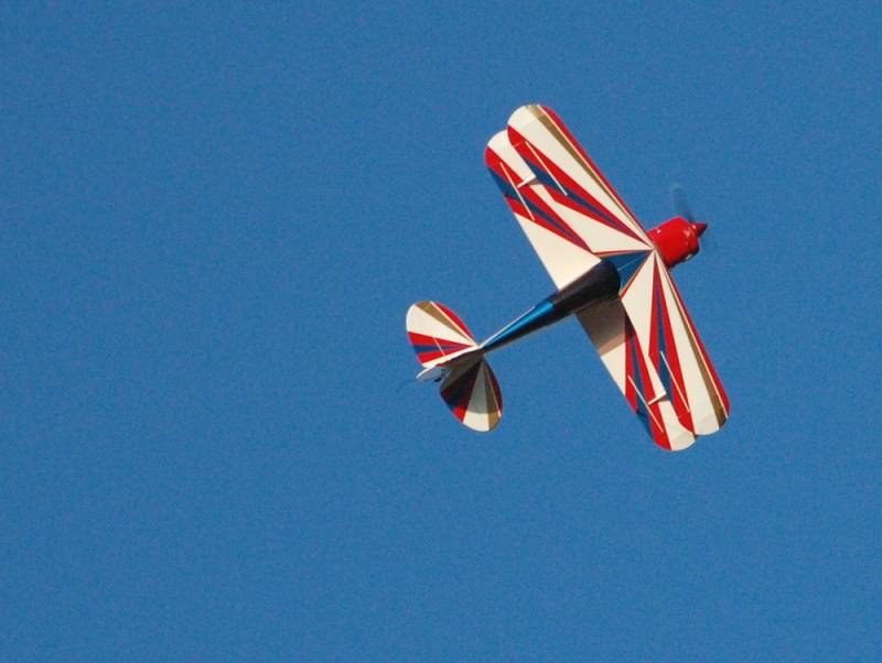

And it's pretty while doing all that stuff, ain't it.
The ARF comes out at a flying weight around 7.5 pounds. The kit version says it comes out around 9 pounds. Close to 20% heavier. That MAY be the reason for the different deflections.
Mine does well on a 60 with a 3-blade. And is pretty doing it.
Joined: Dec 2007
Posts: 18
From: San Diego,
CA
pretty it is..........i see you didn't put the stickers on either. i like this bird without the stickers as well, but i have been asked by everyone so far "what is it?".
i may have to put the "skybolt" stickers on just so people will know what it is. i thought everyone knew the Skybolt.
mine came in at 7lbs 8oz before i removed the last bit of lead, so needless to say i was exstatic. i built the kit version years ago and lost interest as i saw how heavy it was going to be.
light airplanes just fly better, i don't care what anyone says.
this bird lands so sweet, you just don't mind landings at all as i did with a couple heavy pigs i once had.
