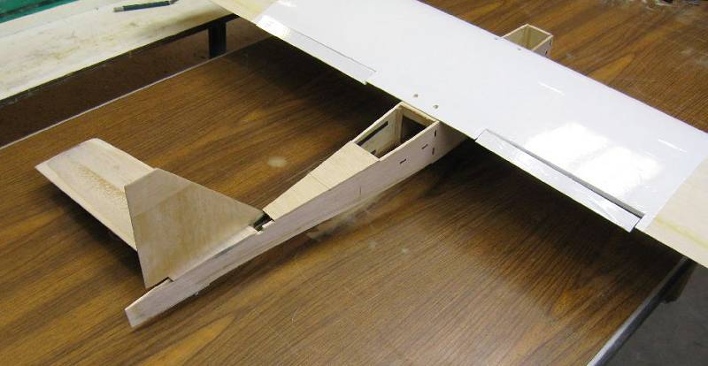

I scratch built this plane over the winter, loosely based on some of my ideas and that funky Blohm and Voss. I also tried to shape the fuse in roughly an airfoil type shape since these planes spend a bit of time in left side knife edge.
Just curious on what I should expect on the test flight, and if I should mix any aileron or rudder to the elevator to offset any potential yaw or rolling issues?? The plane will fly at about 110-120 mph, and needs to be able to make a 100 foot radius turn (on knife). I'm concerned about what the plane will want to do at that speed, when I use that much elevator to make that 100 foot turn.
Also, curious in regards to what it may do on take off.
Oddly enough you probably should have had the stabilizer on the other side. My thinking on this.... Up elevator will make it want to roll slightly to the left or more into the turn. That'll make it want to roll onto it's back and try to kiss Terra Firma. OK, so you mix in a little aileron so the left aileron is down and vice versa. But that means the left wing is producing more lift due to the aileron acting to increase the camber of the airfoil and also the angle of attack all at the same time. So the left wing is lifting more than the right. More lift brings with it more drag so the model has just exchanged rolling further into the turn for wanting to yaw towards the ground. Also you've got more drag on the left side than on the right thanks to the profile and induced drag of the stabilizer on the left. Again, it'll try to yaw towards the ground.
But if you were to put the stabilizer all or mostly on the right side and then trim in a little bit of aileron to counter the rolling couple as required then all the yawing would be helping to hold the model UP instead of trying to yaw it down. And if it was on the right it would be a tad more centered thanks to your fuselage offset so the rolling couple would be less and that means less aileron.
.... at least that's my musings on this.....
Your single-sided horizontal is going to add a LOT of roll to the airplane when you try the elevator!
Pitch forces kinda need to be symmetrical.
I can see a nose high left roll into the ground in my mind's eye on takeoff.

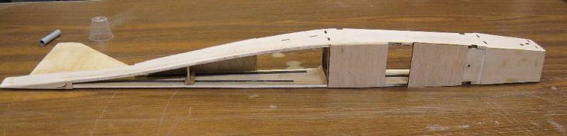

My biggest concern was stiffness and rigidity in the tail section. The INSIDE of the fuse is fiberglassed (3/4 oz) it also has Carbon Laminate 3/4" strips running length wise inside the fuse.
The tail is a sandwich. Center is 3/16" balsa, capped with 1" wide carbon Laminate and a layer of 3/4oz glass. Then as the glass was wet I added 1/32" balsa on either side and placed in a vacuum bag. After that dried, I inset 1/64" ply all around the outline of the tail on the centerline of the thickness. Then shaped, and airfoiled. It is about the stiffest tail I have ever made.
The wing is 52" with a chord of 9 3/4", it meets all other AMA rules for this class.

I would expect that the airfoil shape of the fuselage would give you some yaw, which would need to be offset by rudder trim, and would increase drag. The asymmetric horizontal stabilizer would have the same effect, but the two might partially cancel if you're lucky.
I don't know how much benefit there is to generating knife-edge lift with the fuselage. When a plane turns tight, the needed lift is generated by the wing, since the bank angle is less than 90 degrees. Generally, your wing is the most efficient lift generator on the plane, so it might be best to avoid trying to make any other surface generate more lift.
If you're willing to incorporate some assymmetry to improve performance, I would consider leaving the horizontal stabilizer centered, but put the vertical stabilizer on one end, with a nicely radiused junction. This would eliminate a few junctions, and reduce 'interference' drag. If it's structurally feasible, instead of having the fuselage continue behind the horizontal stabilizer, have it taper down to almost nothing, so that a clean horizontal stabilizer, with the asymmetric fin on one end, is the rearmost part of the plane. This would eliminate the right-angle junctions between the horizontal stabilizer and that section of the fuselage, also reducing interference drag.

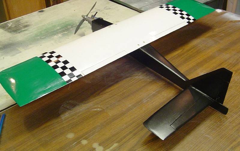

I flew the plane twice last night, it was quite windy, but not too bad.
Holding a little right rudder as the plane took off and it went straight as an arrow, with a very shallow climb out. There was no roll at all with elevator and I had plenty. I was pulling 30 foot diameter loops that looked perfect, with no roll out.
The only issues I had were instability in pitch, and too much throw. I had a heck of a time landing the plane as it wanted to balloon up, the plane appears to be a bit tail heavy which I will address before its next flights. It was really too windy to tell if it had any other unusual characteristics, it basically felt like any other Q500 type plane I have flown, other than having a weird shape in the sky.

I got in 5 more flights in the snow yesterday and worked out most of its issues, but I need some advice.
It was not pitch stability that I was fighting. When I used left aileron, the plane would act as though I gave it a good amount of down elevator at the same time. I ended up adding a 20% mix with Left Aileron being the Master and UP elevator being the Slave. This worked very good, but is obviously adding additional drag. What I found unusual, is that I have no issue with right aileron, just left. The one sided stab must be getting some turbulent air off of the left wing when I bank??
Now here is the problem, the plane is flying pretty darn good, but being a racing type plane, it spends a good deal of time in knife edge flight and straight and level. The plane flies perfectly in the straight and level, but in 90 degree knife edge to the ground, it wants to drift towards the canopy, which is not a good thing. I tried moving the CG all over (front and back), but that did little in regards to the drifting action. Normally, moving the CG back helps, but not in this case.
I'm going to verify my incidences, but I remember this being pretty darn close to 0/0/0. I suspect that I will need to adjust the incidence of either the firewall or the wing (easy), but I am not sure where to start. My thoughts that a little down thrust might help, but I'm not sure. IF that doesn't help, how about raising the LE of the wing by a 1/16" and see if that helps.
Any advice would be appreciated.

You might try flying with the right aileron active only. You might get rid of the mix. I know you wont normally fly the plane this way but try flying right hand circuits to see if the pull is different and how effencent the fuse is.

Alfred, I never attempted verticals or inverted flight, I normally trim racing type planes to fly like they will on a racing course, but I will give it a try tomorrow, as well as add a bit of down thrust and see if that helps. Its really not that bad, just an annoying trait for racing when you are flying around yourself.
This plane will go up till it is out of sight, its doing about 110 mph now, and with an engine change will be up to 125 shortly. Just want to get the quirks figured out.
TFF, good point about the right aileron. The wing I am using now (Viper ARF) has very small ailerons, I'm not sure I would be able to get by with just one, but thats a great idea for the next one. I'll also try a clockwise pattern to see if it acts differently.
Thanks to both for your thoughts. I'm just glad it flies, and even more glad that it flies better than expected.
As I was reading, I had the same idea as TFF... use the right aileron only. The upward deflecting aileron during left roll is lifting airflow off of the stab, changing the effective angle of attack of the horizontal stabilizer during the left roll.
You might try building an aileron with a little more chord... but I'd think you may not need to. Fly it single aileron first, and go from there. Is there any way you can mechanically lock the aileron in the "trailing" position... you might just be able to do it with a mix, just for testing purposes... in fact, that's exactly what I'd do... set up Right aileron as master, left aileron as slave, assign it to a switch so you can turn the left aileron On or Off in flight...
