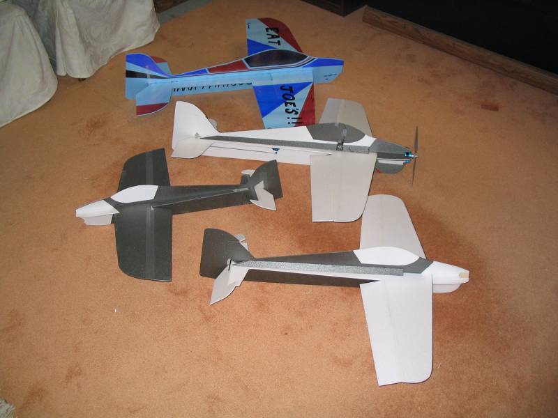

Old 09-23-2008 | 09:13 AM
rmh's Avatar
rmh
Posts: 12,630
From: , UT
Default RE: Is there an ideal elevator throw for performing elevator maneuvers?
I have a half dozen light flat foamies that will do this with no corrections needed
just chop poweradd full up and it's a perfect elevator all the way to the ground blindfolded , they will do it.
However , the wing loadings are very low.
