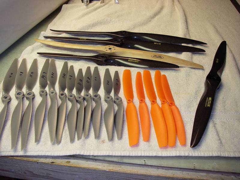

You apparantly think I don't understand pitch/diameter etc., relationships
I do
the example I noted simply was to show that power in must somehow go someplace and the use of an electric motor which easily shows measurable power inputs, was a basic example .
The motor absorbed power so the thrust scale can do nothing else but record the motor load. as thrust.
the shape of the prop , is not important . The thrust is simply the only way the motor can express the work it is doing
aside from heat loss.and this was not an issue.
The test stand easily shows this to be true.
I did not use a flywheel and look at the load of accelerating it
just slowly brought up the various props to a predetermined power input and read scale loads.
Apparantly I am wasting my time on this and will end my involvement .

I understand that you've performed lot of measurements with your test stand, but I wonder whether you've interpreted them right.
Thrust is only a force that is part of the prop's output Power equation, the other part is how much the air is accelerated by the prop, which may be simplified by referring to the prop's Pitch speed as follows:
Prop's output Power = Constant * Thrust * Pitch speed.
Different props (even belonging to the same mfr) have different Constants, which depend on the shape, area and profile of their blades as well as how flexible they are.
Further, props with P/D ratio equal or higher than 0.6 will stall at static condition (as when using your test stand) resulting in erroneous thrust results.
Props with high P/D ratio become inefficient at low forward speed, as when during the take-off and/or climbing. These props also unload much less the motor in flight than props with low P/D ratio.
The power goes to produce thrust AND to accelerate the air (apart from the losses).

For example:
APC E 12x6 produces about 18.5oz thrust and absorbs about 50W (at 4400 RPM - pitch speed 25 mph)
APC E 8x4 produces about 16.3oz thrust and absorbs about 50W (at 8300 RPM - pitch speed 31.4 mph)
The power input is about the same but they have different thrusts and pitch speeds.
The bigger the difference in prop sizes the bigger the difference in thrust for a given power.
However, if you compare props with only slightly different sizes, you might not get such a distinct difference in thrust due to their constants, so a slightly smaller prop might produce the same or even slightly more thrust than the slightly bigger one at the same power...
For example:
APC SF 10x4.7 produces about 21.3oz thrust and absorbs about 50W (at 5650 RPM - pitch speed 21 mph).
It gives more thrust than APC E 12x6 despite it is smaller in diameter (but it has a wider blade shape and thus different constant).

This is what I noted from the first - that if efficiencies are 100%, then the amount of thrust on the static test will be the same , that is the same input will yeild the same thrust. irrespective of the prop used By the way I did not ue anybody's charts
I measured the results.
Once more - I TEST this stuff -I don't go by textbook/published info. Pitch speeds etc., are not relevant in this test .
and the test results were a surprise to me
as on acouple of trials - I put TWO props on the motor crossed to make a 4 blade and the results again the same.
Obviously - the rpm was far different but the power in, to thrust output remained the same.
You really ought to try this stuff

However, you should not disregard the motor's different efficiencies with different props.
If you use the same motor while comparing props, you have to adjust the throttle in order to get the same input power with different props.
This will put the motor working at different efficiencies, which may vary from 85 to 50% resulting in big differences between power in to motor /power out to prop, which may further distort your comparisons.

#69
Yes the brands of props have some WIDE differences
Ireqork some prop to see what does what
both for low speed flying and fast flying
(th motly pile of props shown are some I regularly sue.
The large ones are on 50/40 cc gas engines The pitch and diameter are NOT predictable as to performance as you note. In some cases they are surprises!
My test on watts to thrust was an entirely different matter which I guess escaped some - at least one -
The 10/10 is a good prop for about 800+watts in a slippery airframe
but on 800 watts the 14x7 is far better for 3D - all pretty std stuff. For dynamic testing -I go straight to the model - and skip the cogitating .
The tiny GWS are extremely good -better than APC slo-fly as they have almost zero flutter/vibration .
I am no good at math-so I just fly and use what works the best.

way back when Landing products started doing these injected props - I got a package in the mail
- try these - let us know etc..
In very short order thru feedback there were more and more props sizes available in very incremental sizes and shapes
The users fed back info to APC- they in turn made a "new "prop which then went thru another iteration etc..
No hocus Pocus - just logical proven mods
I believe they had the ability to quickly generate computerized mods an put the results directly into a mold .
Today this is commonplace in some industries
and APC did it right
make the mod then proove it in use .
In my pic of props ,note that one carbon fibre prop, has curved forward tips
This very narrow thin prop loads the engine far in excess of what one would suspect by looking at it.
To further surprise the prop is quiet and yet goes very fast -If you have the power to turn it. The reason for it was to offer a quieter prop in the air - yet another science .
