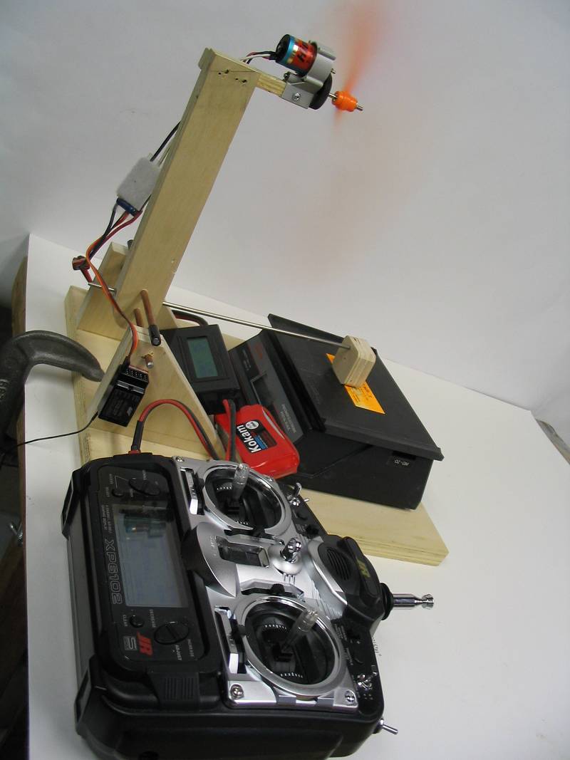

A buddy of mine re-opened the old Y&O prop line some years back. As part of this he wanted to know why some props work and some are only good for stirring coffee. He found that much like Dick mentions in an early reply that most props are numbered because they are a little flatter than the big one but coarser than the flat one and I happen to be holding this number stamp so I think I'll use it.... OK, it's not THAT bad but from testing a lot of props he did find that the numbers stamped or molded in typically only describe the prop for a rather small portion of the blade. APC's were better than most on this account with most of the rapid reduction in true pitch only occuring in the first 1/4 out from the hub and a little reduction in pitch as washout in the last part of the tips.
Other than that all I see here is folks pretty much agreeing that it's the match to the engine and that electrics have changed the face of the issue pretty much completely.

OK, it's not THAT bad but from testing a lot of props he did find that the numbers stamped or molded in typically only describe the prop for a rather small portion of the blade. Other than that all I see here is folks pretty much agreeing that it's the match to the engine and that electrics have changed the face of the issue pretty much completely.
The speed the prop sees at the hub compared to the speed at the tip shows an awesome difference. And the speed at each stage on the prop is really the speed the airfoil sees at that stage. So prop designers figure out what speed the hub is going to see and using the expected rpm the blade will turn, they work out what speeds will be all the way to the tip. And then they set the angle for the airfoils all the way to the tip. The idea is to optimize those angles to the airfoil that's present at each stage to the airspeed each airfoil will see.
In fact each portion of the blade usually has a different airfoil, a different chord, a different AOA expected, a different airspeed expected. There really isn't a "pitch" angle. Each portion of the blade is expected to lift about what the pitch says it'll lift. Otherwise those portions hurt or help the efficiency of the prop to produce the advertised pitch.
The majority of thrust (lift) from a prop comes from the blade that's about half to 3/4 out the blade. The tip winds up giving less because it doesn't have more blade beyond to help keep it working. The hub end winds up doing less because it's usually got some airplane directly behind it and it's got to be a really thick profile and some other things. So if you think that looking at the angle of the blade shows you the pitch, then look about 2/3 to 3/4 out for that.
Props aren't actually screws. A screw's pitch can be measured almost exactly from the threads because the threads are going to cut their way and mechanically pull through a rigid medium. Props have to fly through their medium. And a screw's theads see the same "airspeed" (could we say, "woodspeed" or such?
grin) from the point to the head lengthwise and from "root to tip" on the thread. A prop has to produce it's pitch with aerodynamics. And the angles we see from hub to tip on a prop might have a portion with an angle that matches up to something that if duplicated on a screw would match the printed pitch. But screws and props aren't the same animals.Some mfg's actually use less angle and less airfoil toward their tips than their competitors do. It might give their props a couple hundred rpm better on the ground for example. And they know modelers think rpm on the ground means more than it does. So their props might have a competitive sales advantage. Props aren't simple sticks for sure.
BTW, some people call the angle on a prop the Angle of Incidence. It sort of suggests the true value/purpose of the twist you see change along the blade.
Some mfg's also offer combined pitch props. I think they actually call them "two pitch" or something like that, but truth is, any short name would be scientifically wrong. But the idea they're trying to convey, and to sell, is that there is more or less pitch to those props toward the tips. Truth is, there always is.
But the existence of those props with the funny names illustrates just how different design can produce better performance in specific performance envelopes. Those 12x6-8 sticks are supposed to do special in certain ways, aren't they. Do we see them landing at the speed we've come to expect from a 7" pitch (average of the example 6-8) or not. Heck, who has thought to look. (ok, I have for one)....... Nonetheless, they are gentle reminders that the pitch written on our props is pretty much just advertising and the mfg's guess.

Being a snoopy person - I once tried to figure out the relationship of power to thrust and how prop types and pitch affected this relationship.
My thrust stand obviously only gives results of a non moving vehicle.
My fiddlin around showed that watts n thrust were directly related.
the prop shape and sizes meant very little- ok, nuthin.
To restate:
"if'n the motor/engine produces x power, the thrust will also be x
So 2x power should make 2x thrust . and it does
Don't throw any text books at me I am no good at math and can barely read.
try the experiment yourself.
Why should this work?
Because the prop is simply a load and the load and power to turn the load are directly related. again - don't believe it?
try the experiment
The test would work on a moving vehicle but my test bench won't fly.
The windy tunnel results will give results too.
obviously
the prop efficiencies will show up but basically to go faster -just stuff in more power.
On my electrics -this imakes it easy to figure power.
Just measure watts.
Mamma nature will give you the answers.
PS the test stand was my design from a few years back since then someone elsemade it commercially availble! It is a handy gadget and really quite accurate with electric motors.
It will not work with IC engines as power output is measured by prop load.

I knew someone would drag in the theory on small n large in huge varuiations etc..
BUT I will stick to my original comment.
On my test stand which would swing up to 13" props only I could fus with all kinds of blades in roughly similiar diameters and pitch /etc., meant nuthin
In this case I saw a VERY similiar relationship of power input and the output in thrust.
Have you ever tested this?
Do you think I make this stuf up?
I actually TEST for it.
Since I can't read I have to rely on observed data.
Also- the differences in sizes you noted were huge -a completely different EFFICIENCY comparison.
