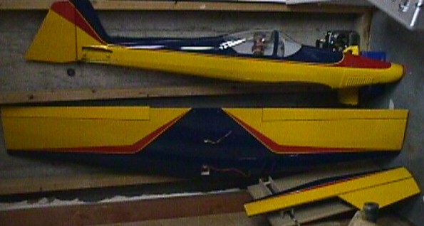

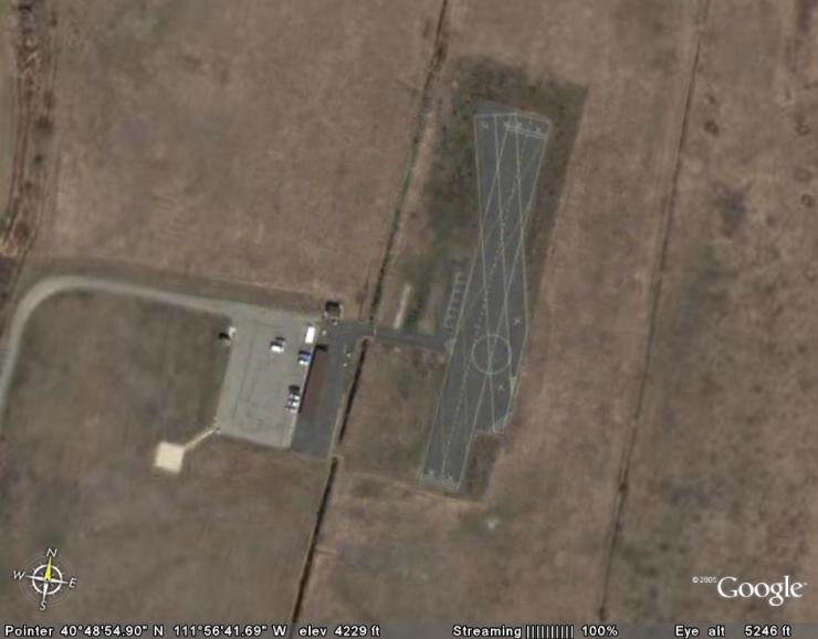

I will soon have my 526AFS Zlin ready -with a EFlite 60 (very soon just finishin it up) 7 lbs 750 squares here is a pic of customer's versions from years .
The $$$ will go into props and batteries . I will time it by flying it over our 600 ft runway.
