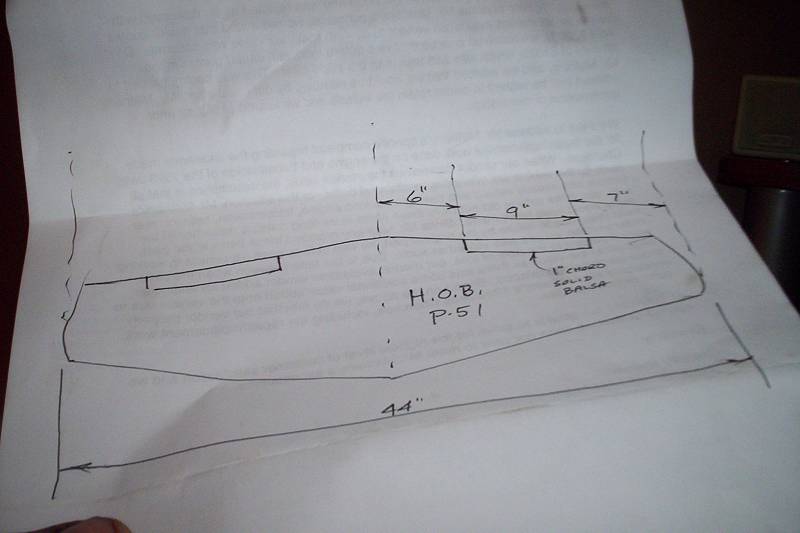

I have a World Models 40 size P-51 Mustang with a flutter problem with an aileron on one side only.
It is powered by a OS 70 heli on tuned pipe spinning a APC 11X8 at 16K so the plane is going faster than originally intended. I need to fix this so that it’s safe to race, this has taken me out of two events this year.
The strip aileron is driven by a Hitec HS-5475HB servo (karbonite gears). The same side has blown out the gears in one servo completely and I replaced the gear train in a different (but same model) twice because the slop was extremely excessive in the center travel area. In other words, the flutter beats the tar out of a few teeth in the gear train in just a few flights.
The control surface was dead tight with no backlash or linklage slop at the start of the flights.
I did a high speed pass level flight and out of a dive and I can’t hear the flutter over the muffled tuned pipe.
I put a gap seal on the bottom side only, no help at all.
I was offered several suggestions;
1# Up reflex the ailerons, but a some point in flight it may still flutter when the aileron is used.
2# Cut away the last 6 ½” of the out board aileron and make it part of the wing (non movable).
3# Use a servo with metal or titanium gears, eventually the servo or the aileron may still fail since the flutter is still there.
4# remove the covering on the aileron and put a thin veneer of balsa on each side to make the aileron a bit thicker than the trailing edge on the wing.
5# Add a counter weight at the out board aileron end.
6# Increase the mechanical advantage in the servo’s favor, but this will amplify any apparent gear train slop at the control surface. It’s about one to one now, the servo is slightly advantage (shorter arm).
Too many choices
What would you guys do?

What a hassle! You failed to mention which aileron is fluttering. Some of the solutions would probably work, and others would likely compound your problem.
First off, why is this bird using strip ailerons? The original design, of the Mustang, was to have slightly smaller than barn-door style ailerons, covering 60% of the outer trailing edge, and flaps utilizing the remaining trailing edge. The break in the leading edge, close to the root of the wing, creates a minor turbulence just at the root, and towards the trailing edge. It effects about 1/3rd of the supposed flap area, which is a problem onlyif the ailerons run all the way to the root. The right side less affected than the left, usually.
If it were my plane, depending on the manufacturer, I would install flaps and originally intended ailerons.
OR, if you are using a double servo setup, I have had success in moving the aileron control horn aft, just a scoche, behing the hinge line.
Don't give up on the bird, whatever you do! Trial and error, that will get you through this.

This picture was taken before it's maiden flight and 3"black stripes added near the wing tips, also before it tip stalled and snapped inverted just before landing and ended up on grinding its lid because of a stuck down left aileron that I was compensating for. Almost had it down safe. Battle scared.

There is no torque rod, it's a servo per wing.
On the Diamond Dust I was told by Jeff the inventor to leave the elevon thicker because it will flutter if it matches the TE of the wing, I had mentioned to him I wanted to match the lead off on the wing. I never would have thunk it.
I'm thinking off adding an oz. of weight under the aileron near the tip. I that doesn't work, cut it down.

I would follow advice #5.
I believe that any control surface flutters because it has mass.
That mass or weight is all on one side of the hinge or pivot line.
The turbulence of the air makes it reach the resonance frequency of vibration.
A balanced control surface cannot flutter because it has no mass, from the point of view of the flow of air (same weight on both sides of the fulcrum).
Also, adding less than the weight of the aileron as a counter-balance will change the resonance frequency of vibration to a different value, that your model may never reach again at those speeds.

The counter weight or BALANCE is the way.
My understanding is that every airplane (yes full scale too) has a 'flutter' speed __ period.
Get to that speed and you've got flutter.
Over the years I have had 'flutter' remove ailerons, aileron servos (yep, the whole thing) etc. but it has been a very sparce occurence. Perhaps three aircraft out of roughly fifty year's worth.
The elevator on a P-38 Lightning is the most visible "flutter band-aid" I can think of at the moment.
http://upload.wikimedia.org/wikipedi...tning_USAF.JPG
Most models, including my few that had a flutter were overcome (it's a 'fix' not a cure) by your #1. Incidentally, it can work with the reflex either + or -.
I cannot buy your reason for not trying it. I have simply never experienced that which you have stated as a reason not to. I have used refexed airfoils for a variety of reasons, flutter is but one.
I also do not agree with removing the outer portion (6.5" you stated). Removing the whole aileron will stop the flutter too. Need I say more?

Let's try the easy stuff first. Fluttering ailerons was always a potential problem on Formula One pylon racers that I built and flew in competition for many years. They were running between 175 on the course but could reach about 200 after a long straight run.
Tape the ends of the ailerons solid to the wingtip with plastic tape. In most cases, this will solve the problem. Those long strip ailerons are pretty flexible, so you will be twisting the ailerons for control.
If building up a speed airplane, it is best to stop the ailerons 4 to 6 inches from the tip. Even then, tape is often needed.
The suggestion to "thicken" the ailerons is OK. It helps to reattach the air to the aileron in theory, but a pain to do in practice.
Generally, adding weight to the aileron makes the problem worse. That is, weight in trying to make it stiffer. The extra mass lowers the flutter speed. On full size, just adding the weight of paint has been found to lower the flutter speed.
In full scale, the practice is to add a counterbalance ahead of the hinge line.
The shape of the trailing edge can also contribute to the tendency to flutter. Sharp edges are good, rounded edges tend to flutter. A square edge is better than rounded.

I've seen the taped down tips work wonders, some guys set their planes up like this from the get go.
This is what I use for the P-51s. Plenty of roll control for the whole flight from the hand launch all the way to the dead stick landing. Once in a bank, the plane stays there [if you'll let it]. I'll bet the same proportions would work well for a .60 sized Stang, too.

Ok, I think it's fixed.
I made 6 3/4" of the outboard end of the strip aileron fixed and cut to free the rest. I did this by removing the covering material in the gap on each side and glued in a strip of tri-stock than made the cut. Then I sanded flush and recovered. Instead of karbonite geared servos, I went with HS-9585MG, over kill I know but I want to be done with it. No weights were used.
I must have nailed the position of the new outboard trailing edge because I needed zero trim adjustments. As a matter of fact all control surfaces are perfectly centered for level flight. After three hard flights with speed dives, all linkages are tight with no sign of trauma from flutter nor could I hear any flutter. I dialed up the servo travel to help make up for the control surface area I took out.
It's slightly less responsive at landing approach and consecutive roll rate at speed is less, but stetting up for a pylon turn it's hard to tell any difference from before.
