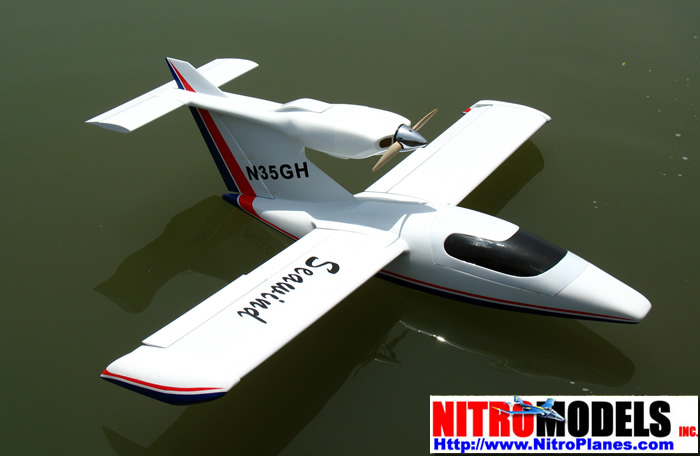

[8|Thanx for all the input. I maidened my nitro seawind yesterday , now i have read all the threads on this plane and most problems are getting of the water. But there are some questions regarding CG. I have the CG as per instructions but it seems that these are no good. this is what happened. I straight away needed a lot of up elevator to stop her diving badly.I have built and maidened many planes but never before was the trim so far out that I could not trim it in flight without help. I could not let go of the stick and trim fast enough,she would dive straight down,but if i tried to climb she would shoot straight up. it was as you say as if elevator was to sensitive but wildly so . But the tendency to dive confuses me[:-][:-]
I managed to land with great difficulty but she did seem better with engine cut and flaps down. The factory CG is 90 mm, I need to get it correct before I try again as I dont think I will be as lucky a second time.
Suggestions please...[&o]

Want to know where the CG should be for flight? Get a yardstick and make the 9 measurements this application ( http://www.geistware.com/rcmodeling/cg_super_calc.htm ) takes for input. Plug the measurements into the blanks and then fill in 5% for Static Margin and run the app. Record the CG returned. Then change the 5% to 15% and run the app again. The CG returned, combined with the 1st, is the reliably safe CG range for that airplane.
ALO, you are describing the symptoms of a tail heavy plane. It's surprising, because manufacturers usually specify a very conservative balance point, so make sure you are measuring it correctly.
Tail heavy and a diving tendency are not contradictory at all. A tail heavy plane is unstable in pitch, so it is almost impossible to trim the elevator to a happy medium that will result in level flight. A little down, and the flight path will deviate down more and more; a little up, and it is the opposite. It makes a plane pretty hair raising and you have to fight it every moment.
The quickest way to check for this is simply to move the balance point forward a little. It probably won't take much to make a big difference.

Yes thats the model,to be honest things happened a bit to fast to say. I was to busy to notice but i do think it was a bit better with throttle closed and flaps down. Although a hard landing was still caused by the "porposing"affect of the elevators.
The symptoms are very clear. Even when slowing for a landing, the plane is porpoising. The CG is too far to the rear. I use a formula on my planes too, but airplane flight is complex and the ultimate guide to CG is how the plane behaves in the air.
Now that I see the design, it is obvious that this plane will be sensitive to CG, because the tail arm is very short and the stab is very small. That means the stabilizing force is smaller than it is on most airplanes.
At this point you have already flown the plane and it is exhibiting exactly the symptoms of a CG that is too far back, so there is no mistaking what to do. I would move the CG forward. How much? It's a guess until you try something and fly it again. I would try about a half inch forward of where it is now. It will be much more flyable. Moving the CG forward is quite safe within reasonable limits. You will need more up trim with a more forward CG, but it won't be unstable as it is now.

ALO 111,
If the fuel tank is located behind the CG, the model should be balanced with the tank being full, which is the tail-heaviest condition.
While the fuel is used, the CG moves forward, which is safer.

However, in your post #8 you stated that “The factory CG is 90 mm”, which shows a great discrepancy between two equivalent models of 64 mm (2”-1/2)!!!!!!!!!!!!!
Here you can find a RCUniverse review of the Great Planes Seawind (sorry, couldn’t find a review for Nitro Planes’):
http://www.rcuniverse.com/magazine/a...article_id=723
Finally, you are not alone.
This thread illustrates how others have faced similar problem with that model:
http://www.rcuniverse.com/forum/m_4780929/tm.htm
Copied from post #6 there:
“My NP Seawind had the CG set @ 3.54" behind the wing LE. It went totally out of control. Since the plane fairly screams "TAIL-HEAVY," I set the CG to 1" behind the wing LE (following the Great Planes instructions instead). The Seawind took off (without a water rudder), flew beautifully and landed very smoothly. It required 3lbs of dead weight in the nose to balance it. It now weighs 11lbs with 3 lbs of useless weight. I am thinking of installing an electric motor and battery in the nose with a l-o-n-g shaft to a steerable water propeller in the tail. Might as well make the weight useful.
It is unfortunate that, as useless as the NP Seawind manual is, one of the few solid pieces of information (the CG point) is disasterously AND INEXCUSABLY WRONG, WRONG, WRONG! Maybe they meant 3.54 centimeters”.

I cannot thank all who have offered there help and advice enough,you guys are the greatest. Everyone came with a positive constructive attitude and lots of years of experience.
I am going forward ..lots forward with the cg and I will let you all know what the result is . Once again thanks to all.
