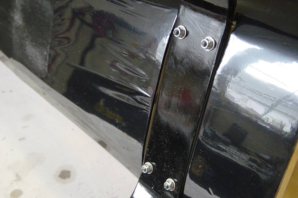

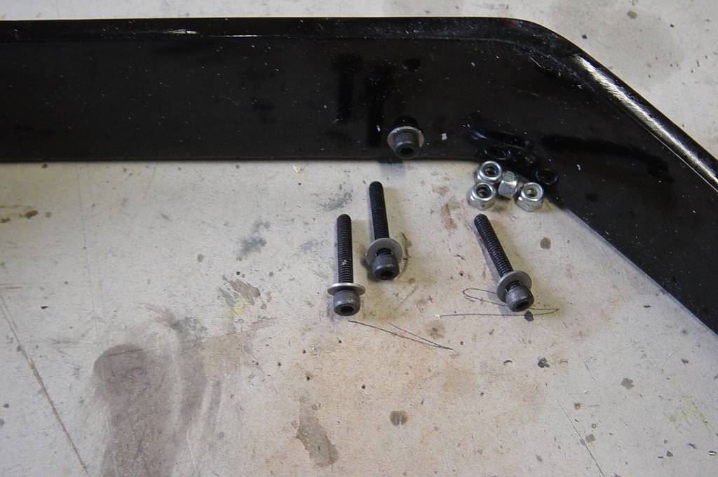

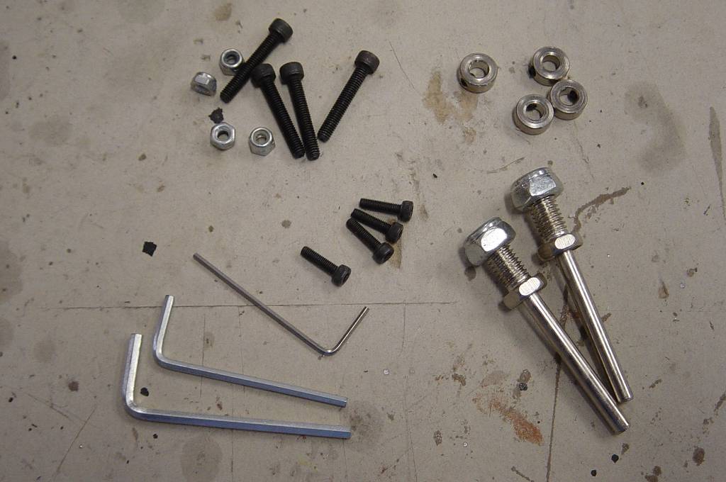

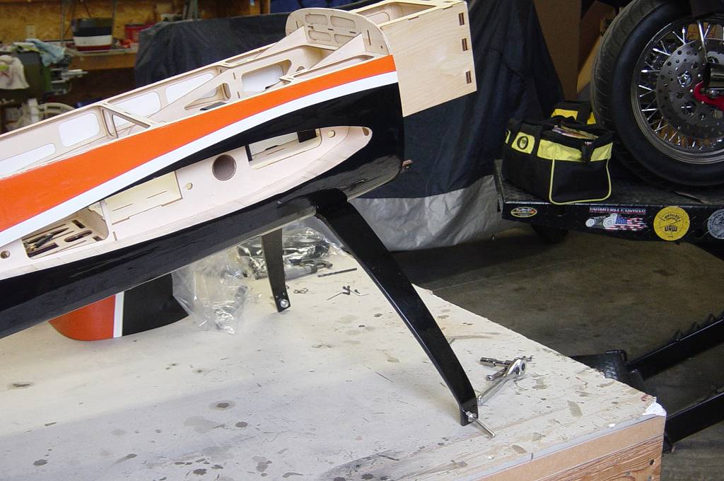

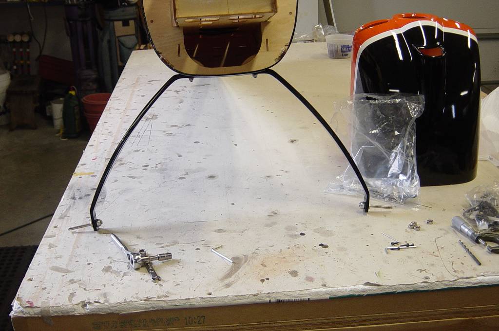

My wif left me home alone for a while so I decided to mount the landing gear. It is the firs thing I like to do on a build since it keeps the plane from rolling around.
I opened up the landing gear bag and I noticed right away that there were 4 nuts missing to mount the wheel pants with. THere also wasn't any flat washers to put between the gear and the head of the bolt or the nut. They may be in the other bag but I haven't opened it up yet cause I don't want things rolling all over the place. I got some washers that I had and used them. The thing to know about flat washers is that they are not all flat. The ones I have are the ones with a crown on one side.When you are using it on Fiberglass or Carbon Fiber. You need the put the crown up side towards the glass. That way the edge of the washer don't cut into the softer material and work its way through from vibration. That is what I did.
I had some paint inside of the axel hole in the C/F landing gear. Took an 8mm drill bit, cleaned it out and everything fit fine. need a 13mm and a 12mm wrench to tighten the axle. I really like this landing gear so far. It has a real nice shape to it. Looks sturdy and it's light.

Subscribed! Your gonna love this plane!! The wheel pants shouldn't need nuts they have blind nuts already installed on the inside, are they should.

ORIGINAL: Tseres
Tom,
When I assemble ARFs, I normally have one of those $2 plastic boxes with dividers that you can pick up from discount stores and empty ALL the accessories bags into different compartments.
I find this easier and I can also at a glance see which bolts, nuts, washers etc I will use and which I will replace.
Regardless of the quality of included accessories, I have a habit of discarding any bolts and nuts thaqt are for high-stress areas like Landing Gear, Engine Mounts etc and replace with quality high-tensile bolts I source from a local hardware supplier

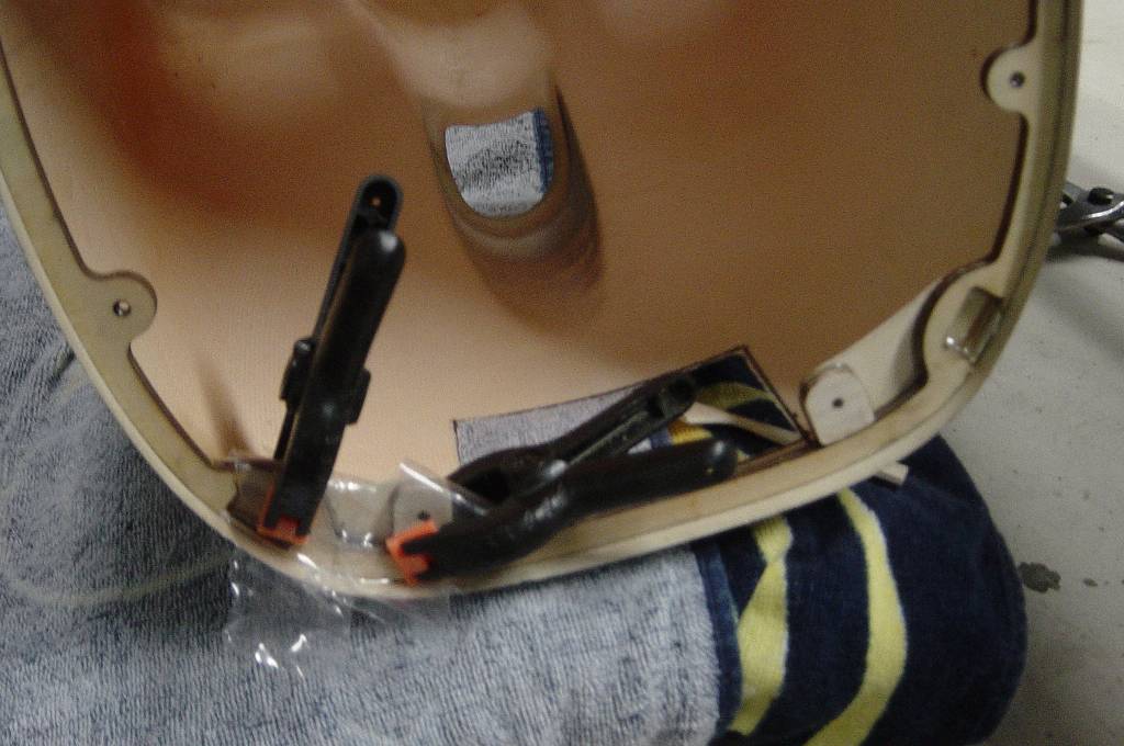

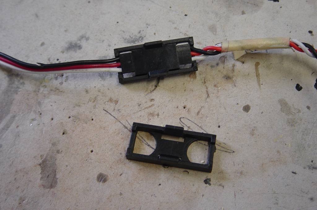

Had some errands to run this afternoon. But managed to do something else. I found these retainer clips for your extensions so I had to check to see how they work. They are easy to clip but are locked in securely. So it gets a thumbs up.[sm=thumbs_up.gif]
I found an empty margarin bowl that my wife had hidden from me. But she don't know I took it so its OK.[sm=wink_smile.gif]

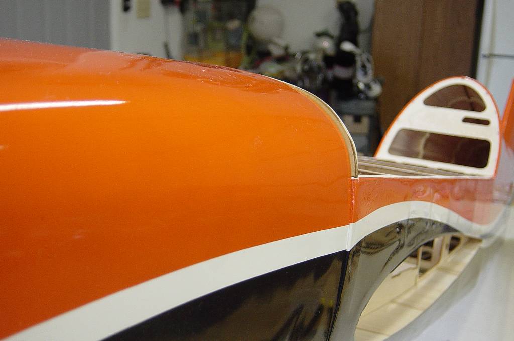

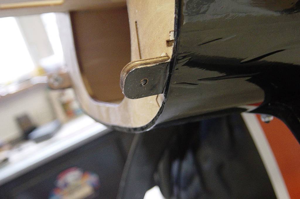

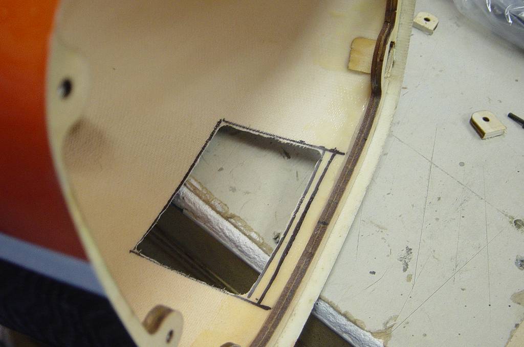

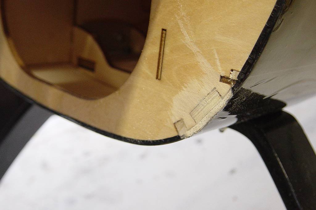

Now for the thumbs down.[sm=thumbs_down.gif] The fit of the cowl wasn't very good. The two tabs sticking out so you can mount the bottom screws from the out side, was holding the cowl from fitting on properly. Because I don't like to mount cowls from the outside I decided to redesign it. I cut the two tabs off and made two new ones that I added on to the cowl ring with Epoxy. This cowl originally had 6 locations to mount the cowl. I'm not going to use two of them the access hole is through the wing opening and you have to take the wing off in order to get to it. I like my life simpler then that. I'm also going to replace the screws with Socket head screws. They are also easier to work with. So my thumbs Down[sm=thumbs_down.gif]became a thumbs up[sm=thumbs_up.gif]. I'm happy again.[sm=teeth_smile.gif]
The engine compartment is already fuel proofed.[sm=thumbs_up.gif]
Nice work.....Just may have to copy your idea on my Goldberg Ultimate. I will have to build a cowl ring though. Might be a fun project.

Making a new ring should be easy. You already have the outline when you take the cowl off. Card board templates are easy to make. You only need 4 6-32 screws on a 50cc size plane. 4-40 will work but 6-32 wrenches are longer and easier to use.

Thanks Old Tom....I think that I will do just that. What is the best way to secure the cowl ring to the cowl. Sorry to sound dumb, but this is something that I have never done. Thanks in advance.
The one time that I did that I put wax paper on the plane side. Located the cowl in the right place. Then I used medium CA with accelerator and spot glued it. Hold the ring in place with the mounting screws and the cowl with masking tape. Once the CA is cured take it off and lay a nice bead of epoxy on the front side of the ring. If you wish you can put some F/G cloth in a few spots to give it strength.
There may be different glues that work better, but I don't know about them.
Hope that helps.
