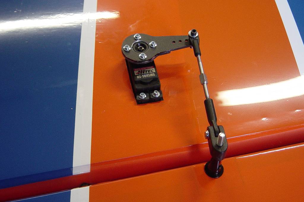

I found a little time today to finish shrinking the covering on the wings. Mount the servos and seal the hinge gaps.
I did something different this time and used some hinge tape that we use on foamies to seal the gaps.I figure its better then trying to match colors and should be stronger then ultracoat.

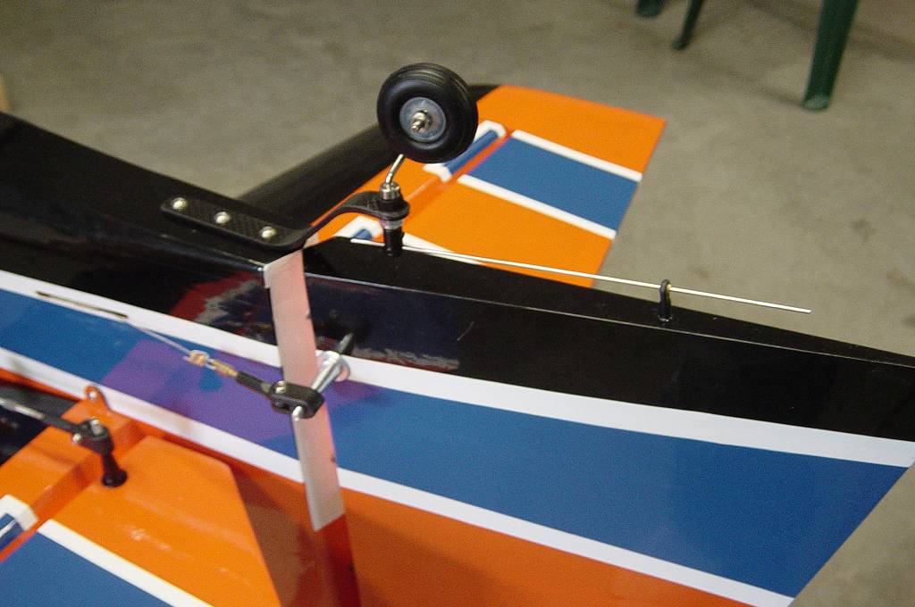

Default RE: Redwing 50cc Sboch

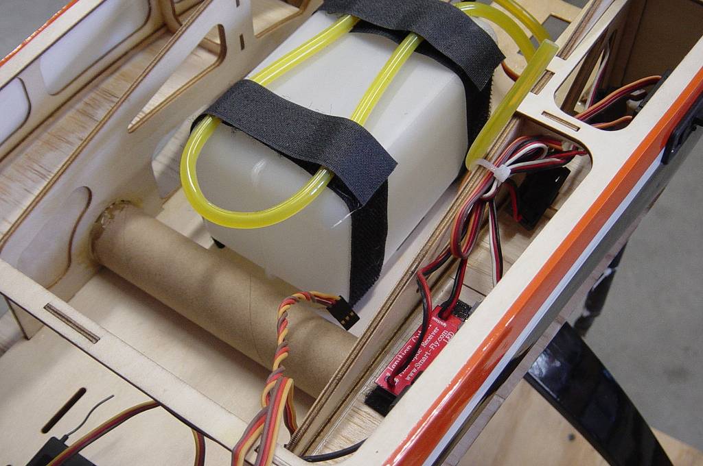

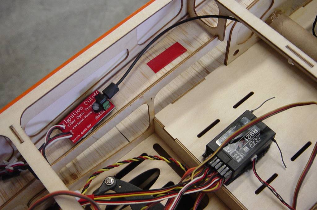

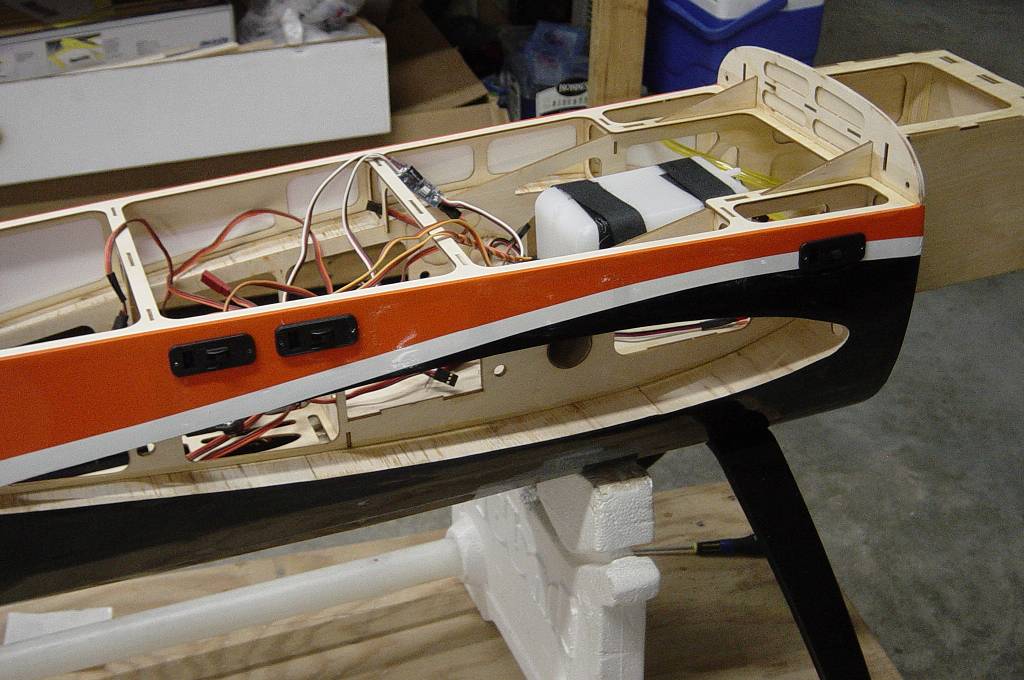

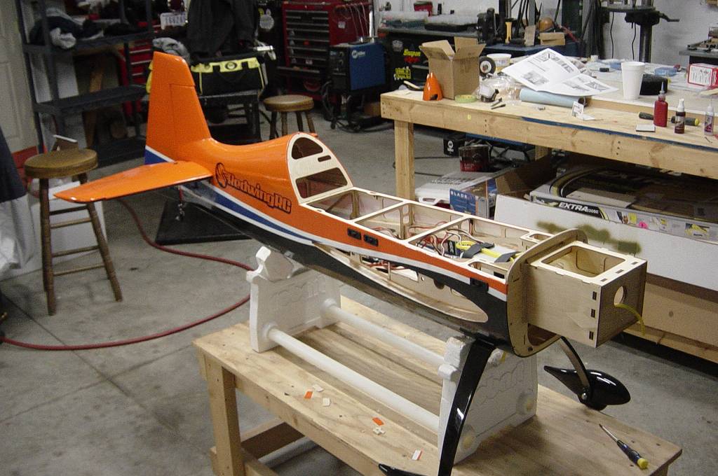

I have to say that I like the tailwheel set up on this plane a lot. This is the first time I got this stile of tail wheel. It is straight forward and easy to mount. No coil springs to mess with.
I got the switches and the gas tank mounted and plumbed. I changed the tank to a bigger 24 oz. tank. The smaller 20 oz would have been better for 3D but I like to play it safe and bad thing has happened to my planes when they run out of gas in the wrong places. Did you guys notice that that has happened to me more then once.[:@]
Looks like tomorrow is going to be the engine mounting exercise.

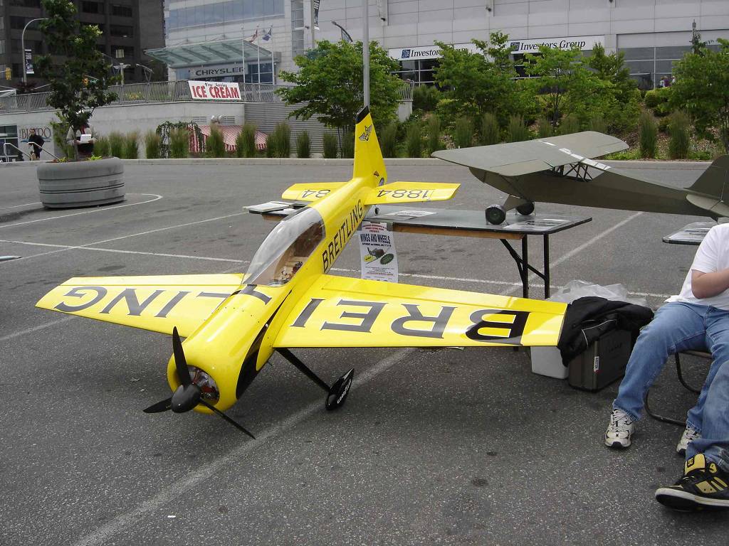

I believe the paint scheme can't be copyrighted, now...... the Breitling name and logo, that's a different issue. It's up to the individual modeler to use any specific set of decals essential to reproduce a scale copy of any aircraft he chooses without the requirement of paying for a single user copyright fee. On the other hand selling the name and logo with the airplane kit may require permission from the owner (Breitling) which may elect to provide it free as a promotional gratuity or may demand a licensing fee. For example Red Bull doesn't charges for these type of use of their name and logos, on the other hand some other promoters do require licensing. A few years ago there was some major controversy discussed on the AMA magazine on this topic because even Cessna Aircraft Co. was demanding and enforcing licensing agreements on their name being used on any type of toys and model aircraft's manufactured.
Check out this 40% Yak a Canadian fellow was exhibiting at the Windsor Air Races, and I don't think he received any hassle neither from Breitling and or the Nigel Lamb racing team. I hope I am not opening Pandoras Box, this is just my understanding. Please correct me if I am wrong.

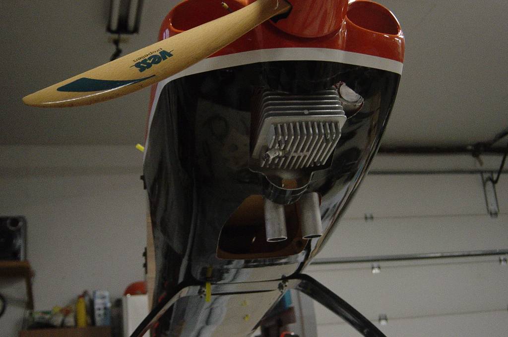

The first installment for today is the engine. I ended up using the provided drill jig and the spinner came out close enough on location. We did have to cut some relief on the bottom of the fire wall for the pits muffler. As you can see Bob was cleaning up the saw dust from the fuse.
Yeah we had the ports and the carb taped off.

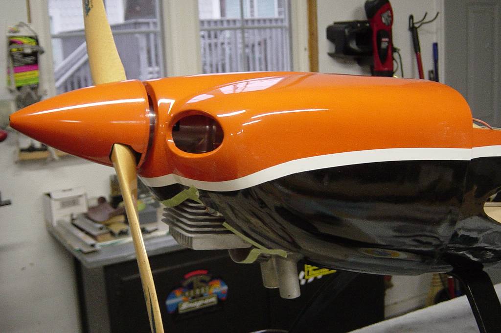

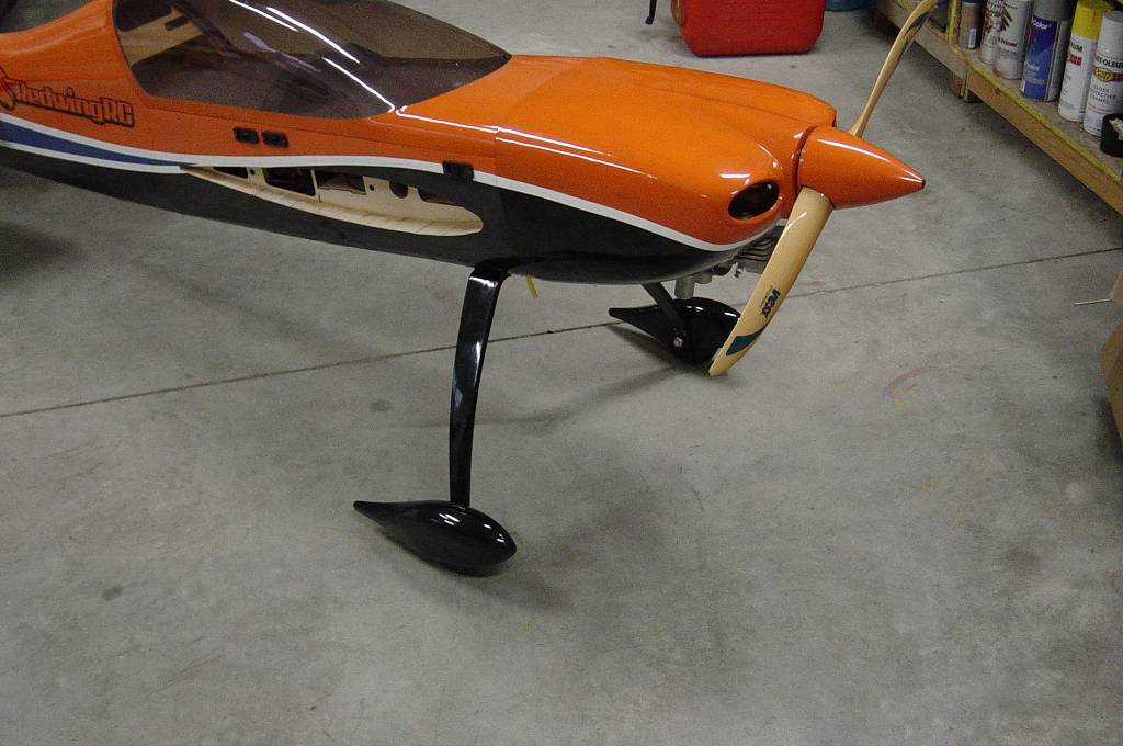

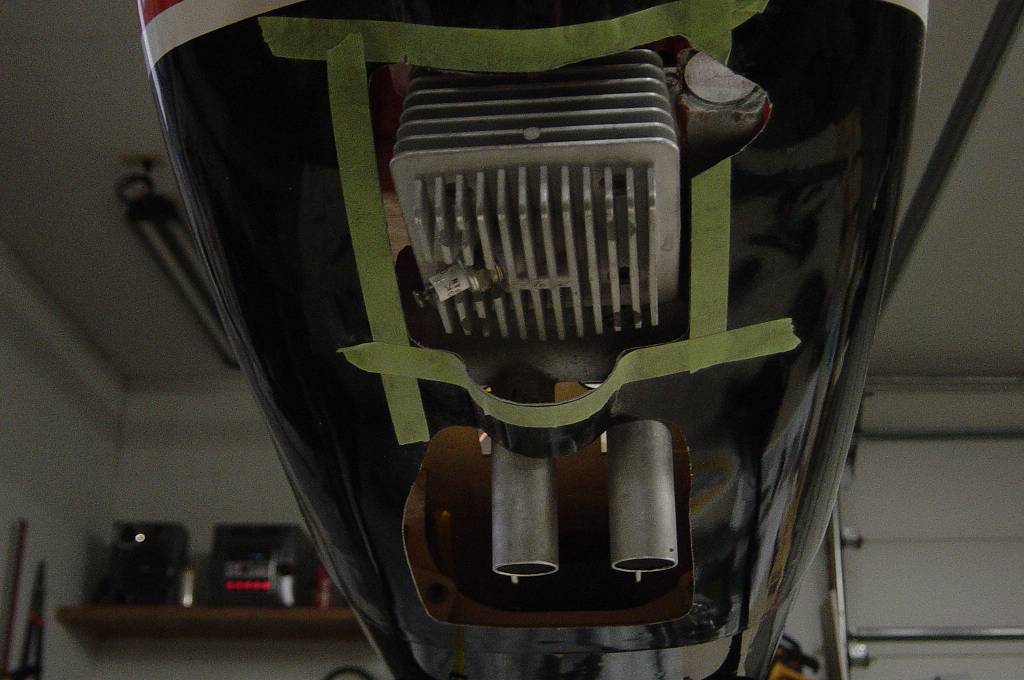

Second installment was fitting the cowl. That took some doing. Me engine needs 2 1/2" Standoffs on this plane. If I did that Id have to cut some more clearance for the muffler and the back of the carb. As of now I have a 1/4" gap between the cowl and the back of the spinner. I much prefer that the factory move the firewall back and let me shim the Standoffs forward. Ill work on the clearances some more so all I have to do is change standoffs when the time comes. I'm going to leave it the way it is for now. I don't know how the DLE fits but a D/A would have the same issues that the YD-A has. I had to cut a lot of the cowl out to make things fit. When I put the plane on the ground you couldn't hardly tell the difference.

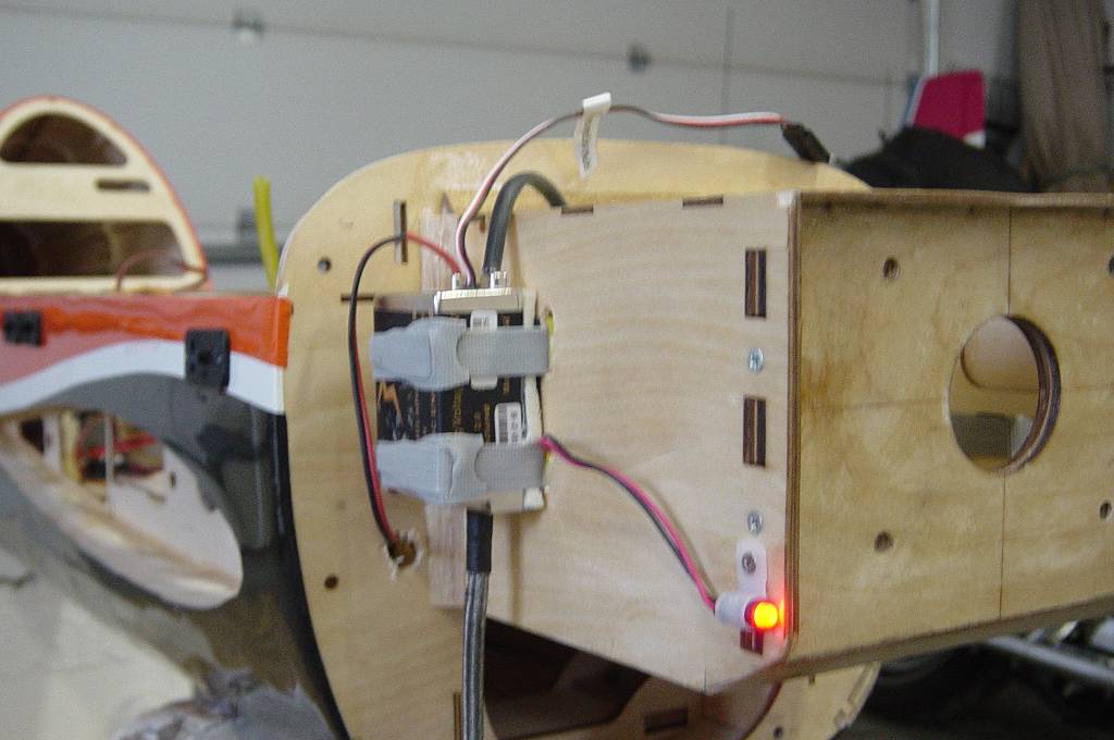

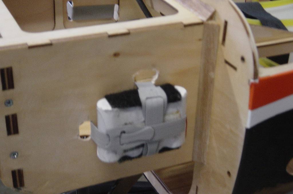

I got the ignition, ignition batterie and the opto kill mounted. Pictures tomorrow.

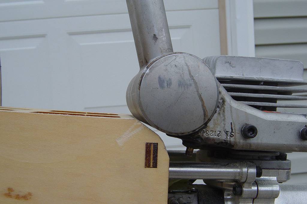

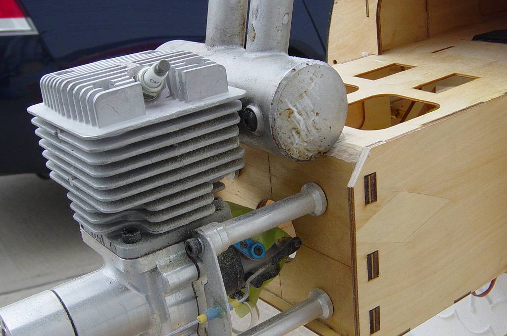

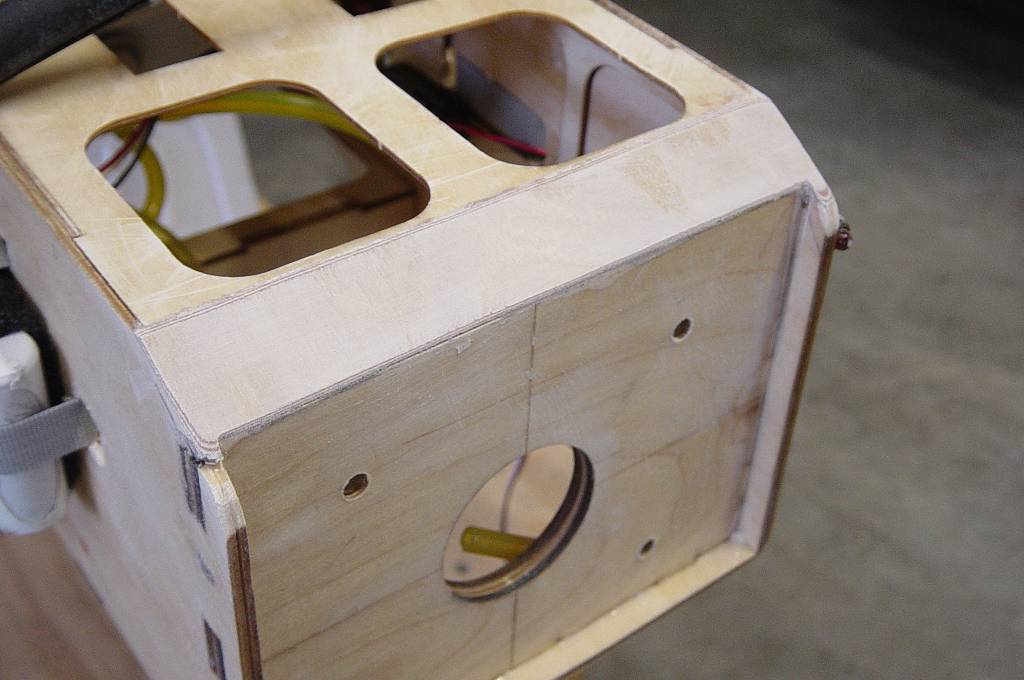

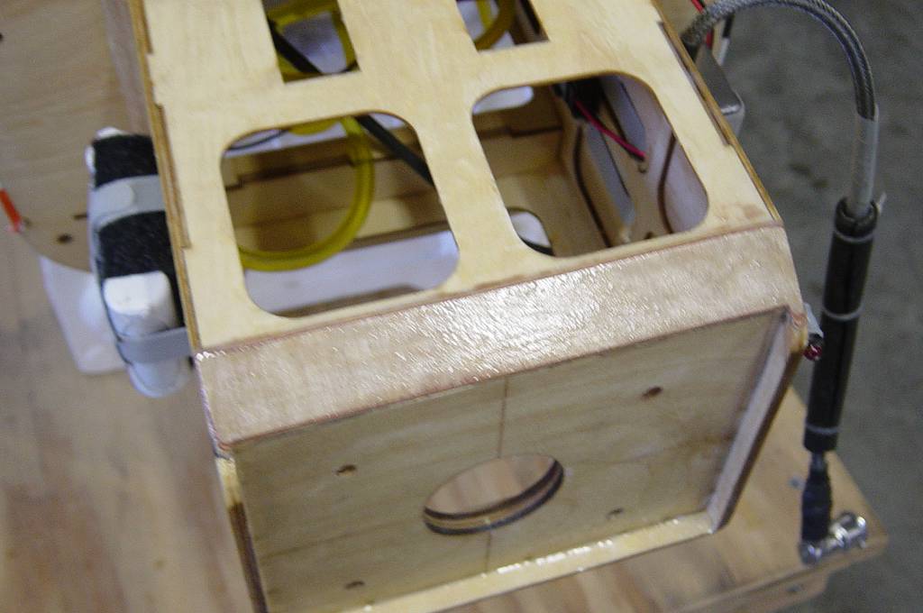

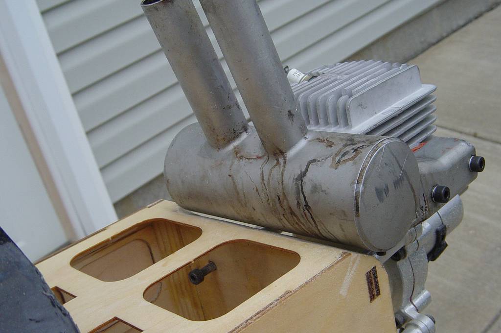

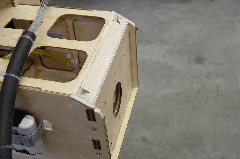

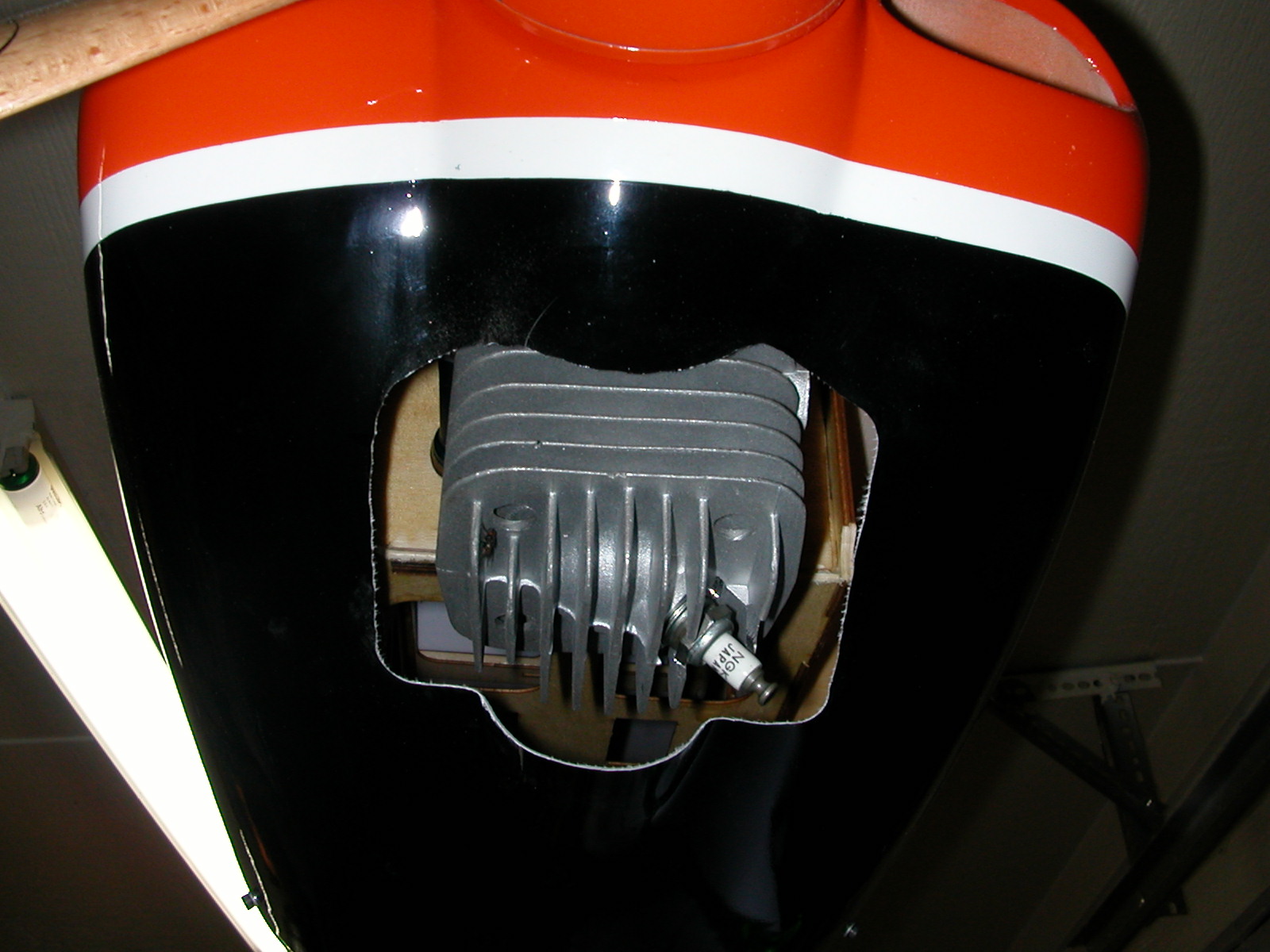

I finished up the muffler clearance this morning. I caped the clearance with some 1/32" ply. That will keep things covered and make things stronger. I also put some wood screws for pining the firewall and glued them in for for extra strength.
Getting closer.

Here are the pictures I should have took last night of the ignition and the Opto Kill.
ID:	1524874   Click image for larger version
ID:	1524875   Click image for larger version
ID:	1524876   Click image for larger version
ID:	1524877   Click image for larger version
