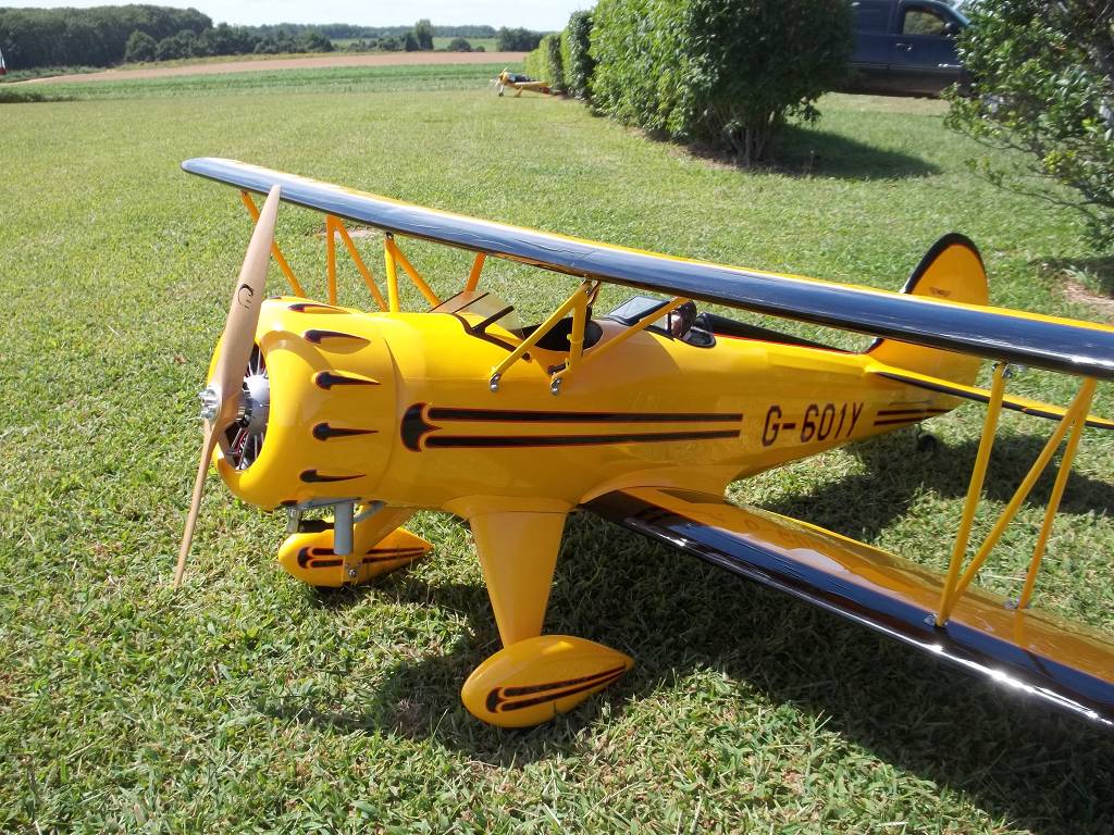

All finished up. Pretty straight forward, but my god, what a huge PITA the cowl mounting is!

Maidened today. What a great flying airplane! Love it, a real floater and looks the part in the air. Though I have to say, the 30 is alot of power. Unlimited vertical and the engine isn't even close to being broken in yet. I'm all for overpowering aerobatic aircraft but I think in this case the 30 is overkill. On my third flight, the fuel line was rubbing the cylinderhead (couldn't see it) and caused an engine out in a bad spot. Landed a little long and went off the end of the runway, from the racket it made as it flipped over in the high grass I though for sure it was done. When I got to it, was pleased to find only a single little crack in the left wheel pant and some dirt on the wingtip.

One more
