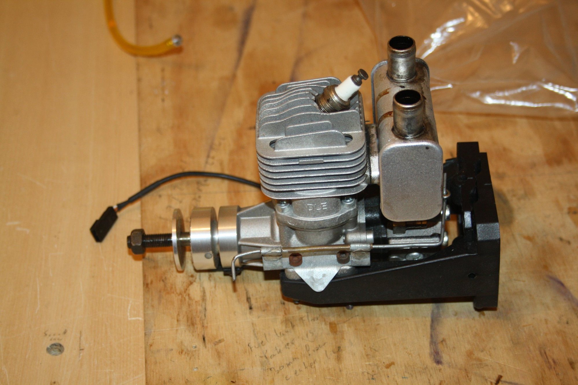

I recently got a GP Waco and will start assembling it soon.
I was reading the forum since the first message in 2010. A lot of good information.
I was initially planning to go with a DLE30 but you don;t find it around anymore so, I was considering the DLE35 but I was really concerned of overpowering it a lot.
After reading this forum, I'm convinced that the best option is the DLE20!
I would like to ask a couple of questions:
. Is it OK to use the motorn mount that comes with the kit for the DLE20?
. What tank size you are using with the DLE20? I think the tank that comes with the kit is 20 or 24oz, which I think is way too large for this engine.
Thanks!

PedroM - The DLE 20 will be OK for the WACO, it will fly at more representative "scale" speed then a DLE 30. I was using the SAITO FG-20 and it was flying great and that engine is nowhere near as powerful as the DLE 20.
I cannot remember what mount is supplied with the engine (and I have three of them...), but I was using the Great Planes GP 60-120 engine mount on couple of my aeroplanes. I have attached photos of one of the engines I just received from a friend on this mount, and a photo of inverted installation in my Balsa USA Stingray 120.
As to the fuel tank size, while I cannot remember what I was using, I think they are more like 16oz.
Cheers,
Eran
