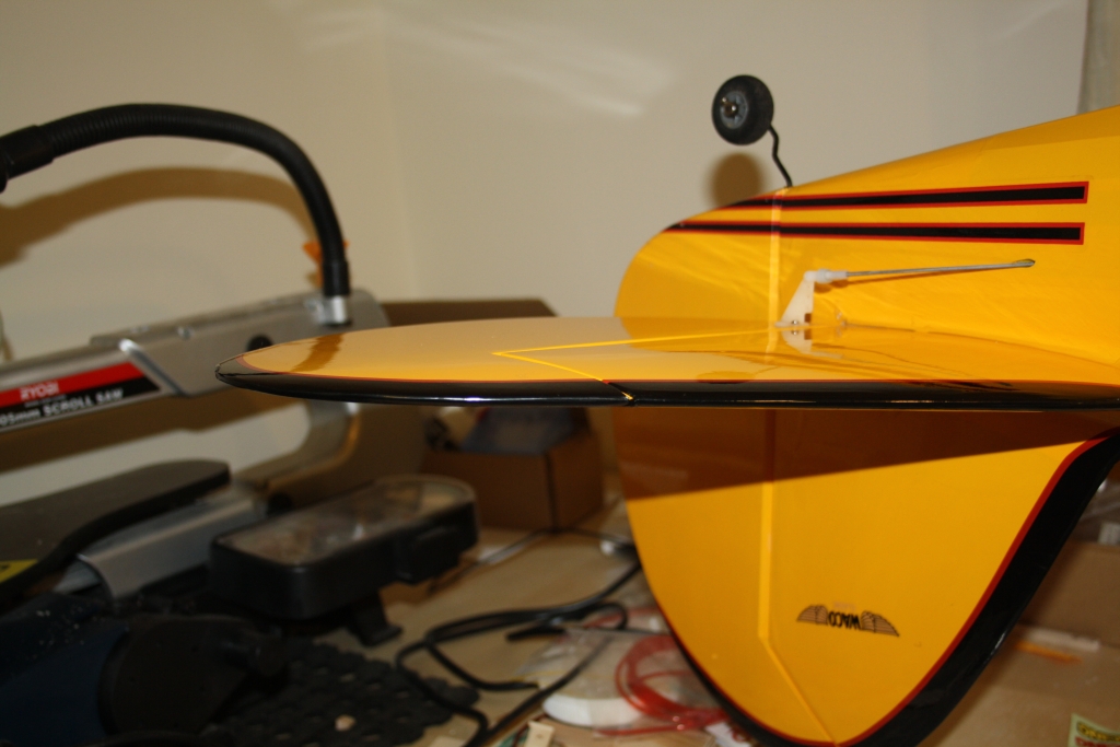

I have noticed on my GP Waco that the elevator halves if lined up with the front of the stab, do not register
the same height at the rear of the stab. Anyone else have this problem? To get the same height at the rear
I have to have one elevator have above the stab and one below or almost even with the stab. My question
is will it have adverse effect on flight characteristics with the front of the elevator halves being uneven?
Thanks, Aframe2

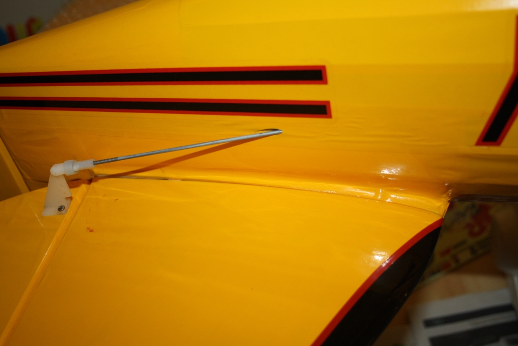

Iam not sure that Ifully understood your alignment issue.
While it was not easy to get the stab into position, it did end up aligned, also if Iremember correctly, I had to hold it (force it) in place with masking tape while the Epoxy set.
Itook some more photos which I hope will allow you to compare.

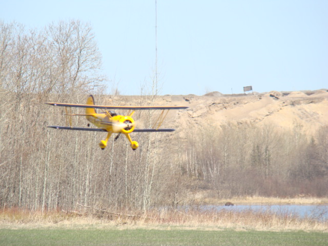

Maidened mine today,its powered by a Thunder Tiger 130 4 stroke that has a OS120 flex pipe. Had to have a coupler made up to suit the thread at the exhaust end.Flys great ,I'm running a 16x8 to break it in and will go to a 17x6,and then maybe a 18x8 later on.I added my own registration on the fuse and under the wing.Got 2 flights in today and it was flying so nice I decided to do some low and slow passes...I still have some idle issues but once shes broken in it'll be fine.These bipes fly nice don't they..

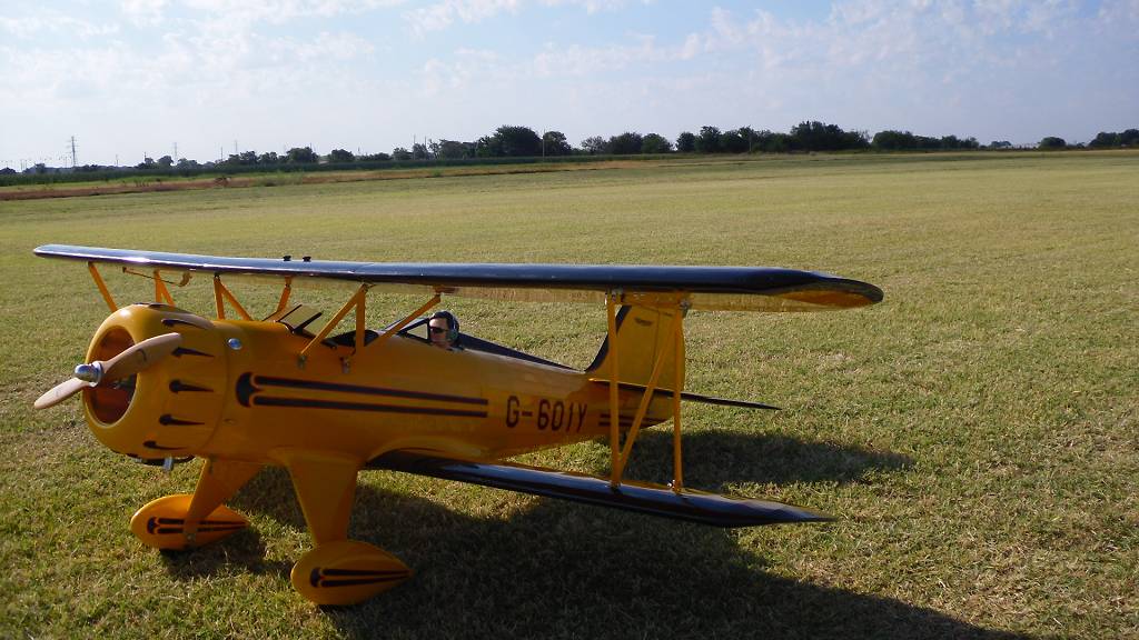

Steve, Great job and awesome pictures. I have not flown my Waco for a while but they do fly great. Now after seeing your pic's I am getting it down from the hook and charge it up. Mine has a Dle 20 running a 16/8 Zoar prop.
Thanks for the post and many more flights with your new Waco!!!

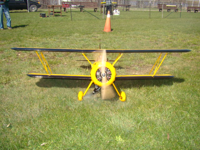

Steve - She is looking great. Congratulations for the maiden.
I just came back from the airfield, flying my WACO. Now that the SAITO FG-20 is sorted I really enjoy the aeroplane.
The only thing Ido not like about it is that Ifind it almost impossible to land it with the engine on. It floats forever with the engine on and the airfield is not long enough

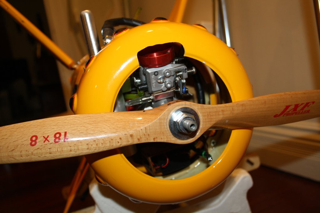

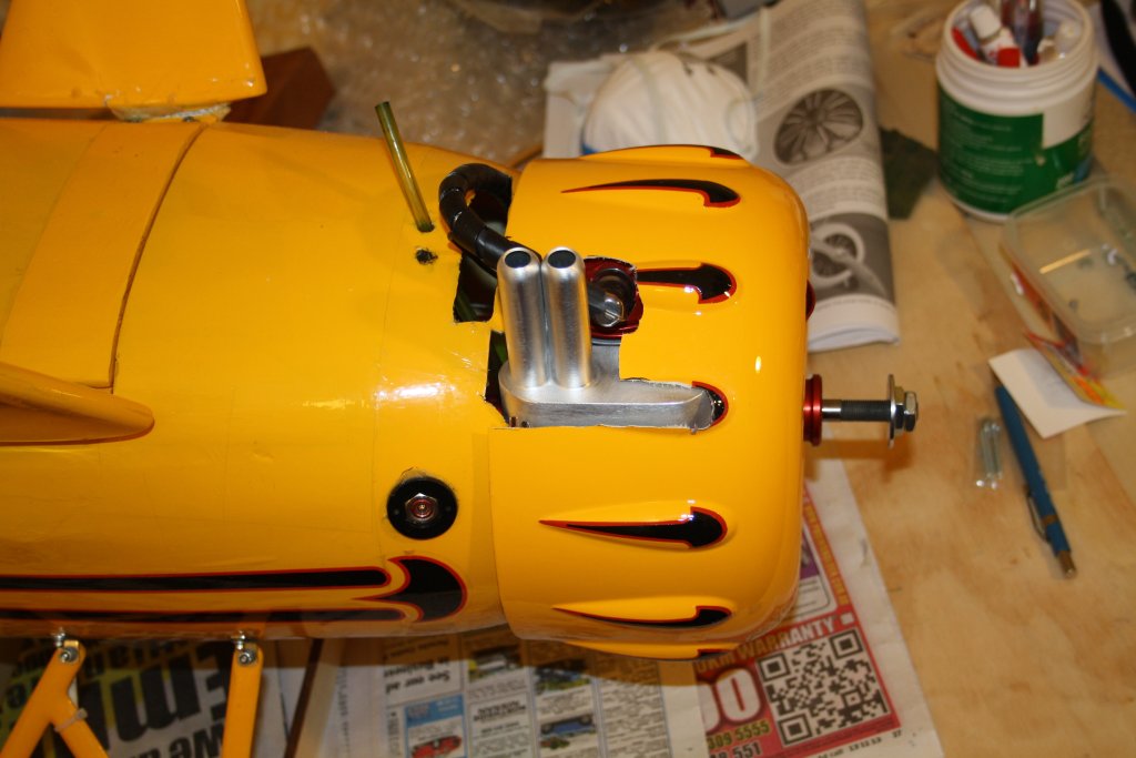

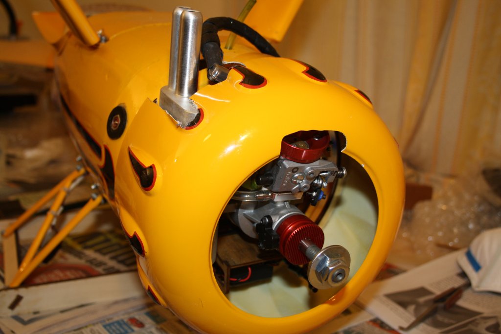

The enjoyment from the SAITOFG-20 was short lived. The engine keeps playing up and impossible to tune.
So, the SAITOwas taken out and I am in the process of installing MVVS30 IFS/RC (Slant Plug) - http://www.mvvs.cz/mvvs_30e.html
This engine was originally planned for my Fliteskin 1/5 scale Me-109, but I will have to buy another one for it.
The engine is equipped with the MVVS back plate radial mount 3394 and I used 50mm stand-offs to get the correct clearance from the firewall.
I also added a Bisson muffler.
If the 40cc MVVS Ialready have is an indication for what I am in for, then I am for some reliable and powerful operation (at last).

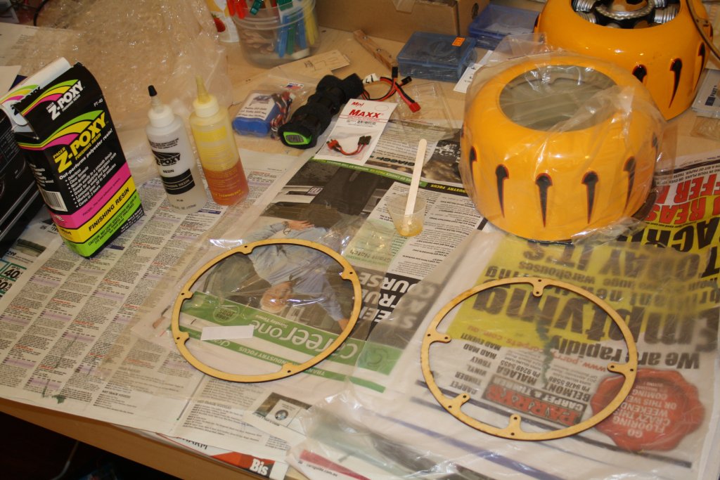

Finally got back to it, and installed the ignition and the fuel system.
The "cuts" to the WACO fibreglass front section (body side) you see in the photo are from the previous engine carburettor access requirements.
Iwill fly the aeroplane without the cowl for a bit to make sure everything is good.

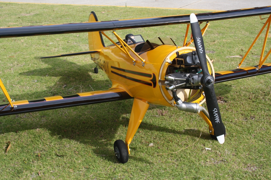

Final note on the MVVS 30 install.
I run it for 10 minutes on the ground and then took the WACO for couple of 10 minutes flights.
Just awesome. Plenty of power with the 18x8 laminated wood prop.

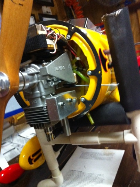

Hi all I just picked up my first Waco today. I want to run the DLE20 in it, with the fuel tank that comes with the kit what is the average flight time with it? I would like to make the fuel tank a little smaller and add a smoke tank if it will not take to much out of my flying time. With the DLE20 mounted inverted will I have to cut up any of the cowl sides or top?
Mark
Old 07-16-2012 | 12:12 PM
  #1045
Joined: Feb 2006
Posts: 1,133
From: camden, SC
Default RE: GP Waco?
Mark, I don't remember what size tank came with the Waco, but I have a DLE20 in a Top Flite Mustang. I am using an 8 oz tank and fly for 10 minutes at 1/2 to full throttle. I never have ran out. Always have couple ozs left. I have the DLE 30 in my Waco and just had to cut the cowl on the bottom. I used a jtech wrap around muffler.

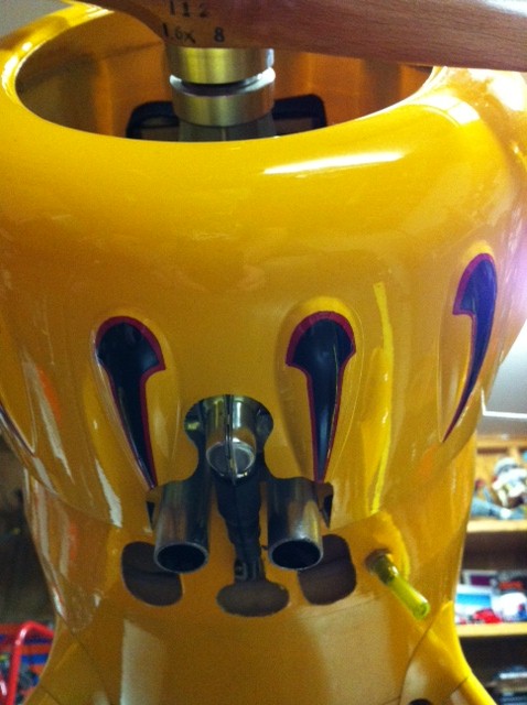

I have a DLE 20 /Jtech muffler cessna 195 style muffler on mine. It all fits really good. It flys the Waco with plenty of power. You will like it. Jtech makes an Aero Works Cessna 195 muffler for a Dle 30, so I called Jtech and he made some for the Dle 20 same style. A very good fit for the Waco.
